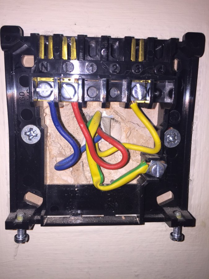

I have a traditional Drayton dial thermostat on the wall and want to replace with a digital on with programmes ideally.
Here is a pic of whats there already, my question is, could someone PLEASE look on Screwfix and recommend a simple replacement unit. I need it to be as simple as possible, I have looked but Im not sure which wire would go where, Im sure I would have a couple of wires left that I would need to tape off.

Personally I would use the Horstmann DRT2 which will connect to you two wire system and can be programmed to have different temperatures through the day. I have earlier version in my house. Batteries last around two years but I always change mine beginning of each season.
You will not need the N neutral Blue wire just put some insulation tape on it.

The DRT2 cannot be simpler to wire.
AS stated above (and as on the WIKI) you will not need to connect the neutral (your blue wire). Or the earth (the yellow&green)Put them in a separate terminal blocks, not connected to each other or anything else. Then you are left with the red and yellow wires. Those go on the only two connections on the DRT2, and it doesn't matter which way round they go.
You will need to set your existing CH timer to be permanently on.
Quite honestly, I would keep the existing stat and replace the timer instead, if its faulty.

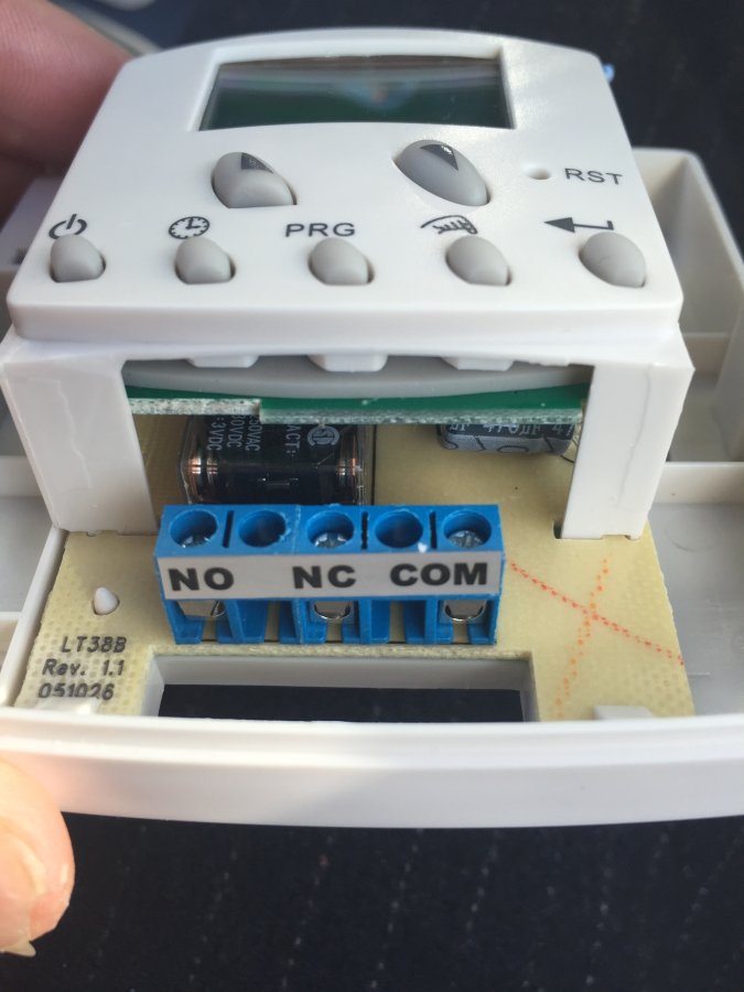

Hi guys
Just picked up the DRT2 and there are 3 connections, taylortwocities you mentioned there are only 2, here's a pic. So the red and yellow go in which hole

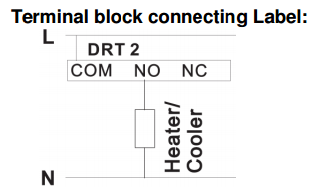

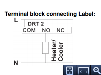

You should have received a piece of paper with it, on which you will find:
Yep got my piece of paper, so red in COM & yellow in NO?? Will that do the trick?
I can work out where the batteries go (y)
