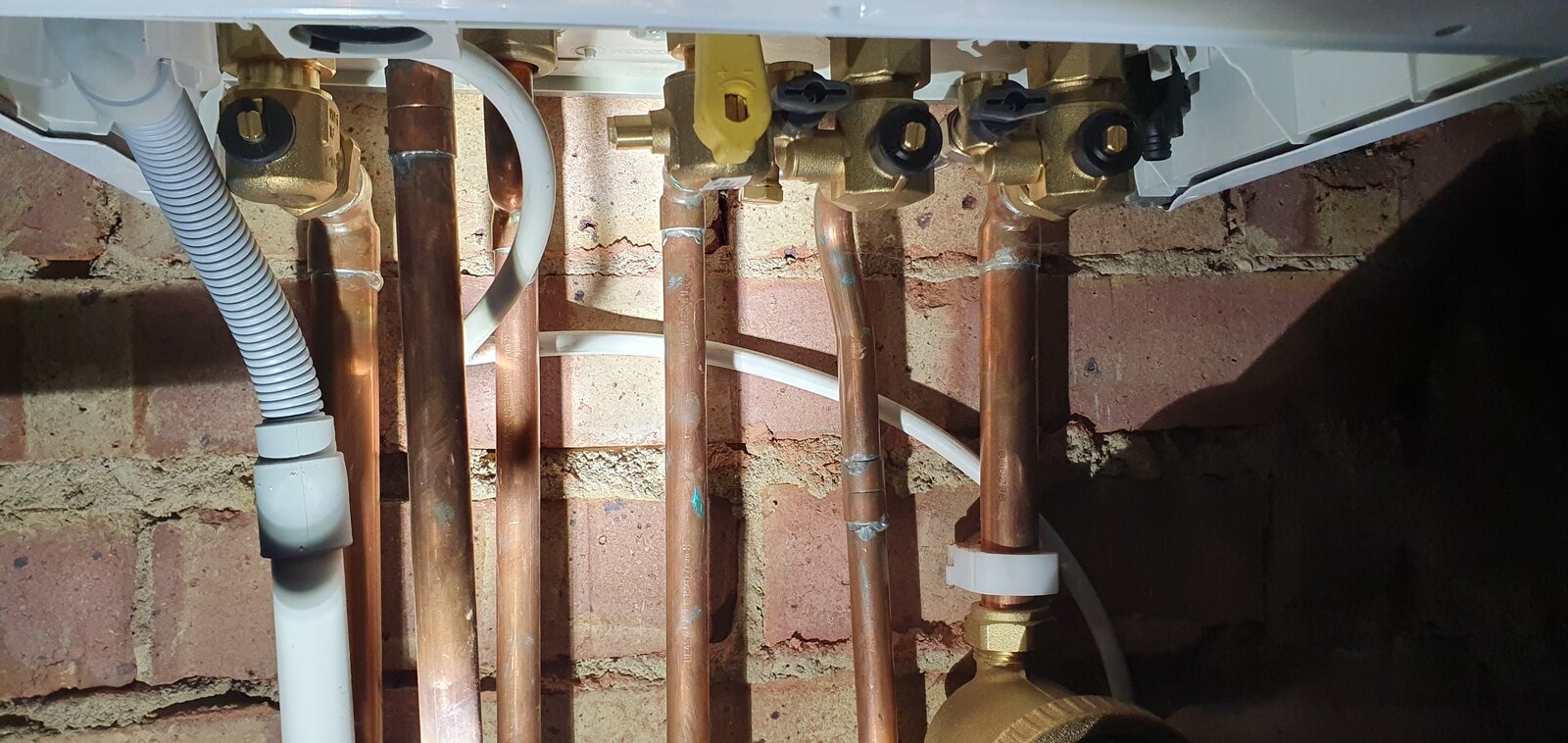

Elkato531 - this sounds like the kind of solution I am after. The boiler is a Glowworm Energy 7 30C. Would be grateful if you could please confirm if it would be safe to do?
So I would close the flow and return under the boiler, then go straight into changing the valves?
Should be ok with those flow and return iso valves. They look like they have a screwdriver slot but use a 4mm allen key.

Small hiccup... no slot for a 4mm allen key and I cannot turn it with a screwdriver... any ideas?!
If they are the iso valves as shown in the manual, they should have a hole in the middle for an allen key. Post a pic of your valves.
