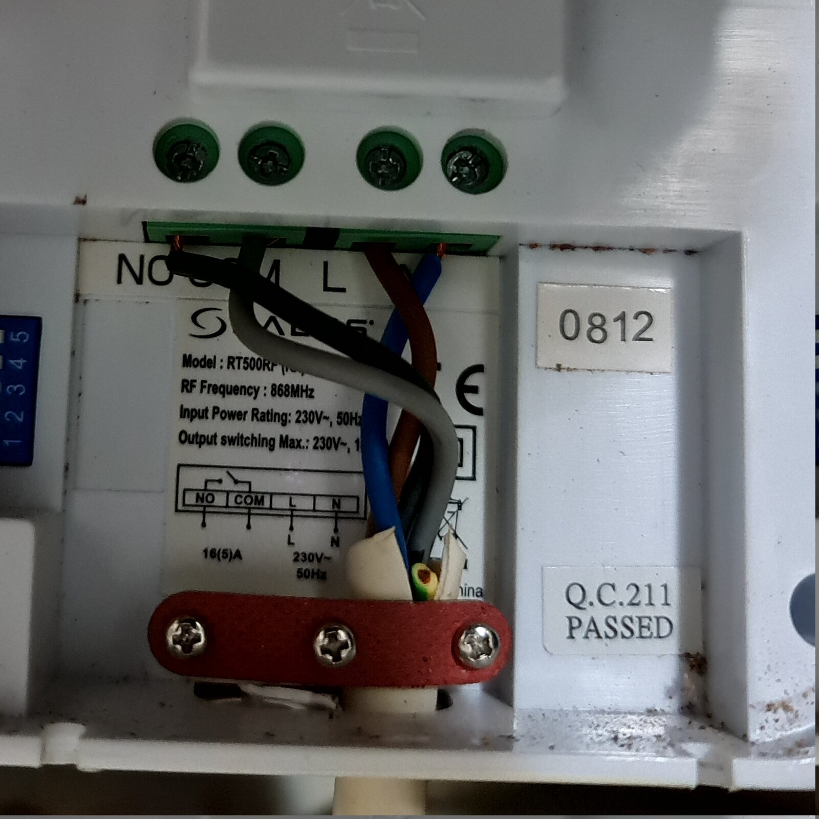

Good Morning All
I am looking to upgrade my existing thermostat to a smart one and have been looking at the nest. I have looked on this forum and there are a lot of helpful people. I was wondering if you could advise if its a straight forward swap with my existing thermostat..
I have a Valiant EcoTec 28 pro 28 combi boiler (runs central heating and hot water is provided every time tap is opened) this is linked with a Salus RF500RF thermostat and wireless receiver.
The wiring from my is as in the attached picture.. will it be an easy swap into the Nest heatlink thing??
Thank you in advance.

There are different variants of Nest, the description below is for the 3rd Gen model, which is the most common. However, if you are considering a Nest-e, the Heat link is battery operated, so installation is different. Post back if that's the case.
For Nest 3rd Gen
Salus N = Nest N
Salus L = Nest L
Salus COM = Nest 2 Heating common
Salus NO = Nest 3 Heating call for heat
If you want to power the Nest thermostat from the Heat link, then connect T1 & T2 at the Heat link to T1 & T2 at the Nest thermostat. If you do this, the Heat link also requires an earth connection, which appears to have been cut on the wire in your photo. That would need to be connected to the Heat link making sure that the other end is connected to a genuine earth connection.
Alternatively the Nest thermostat can be powered from a separate plug in power supply.
If you’re going for the Nest learning thermostat, then you need the all the wires transferring over to the nest in the appropriate terminals. If you’re going for Nest E, then you only need Com and NO.
(I am not an electrician).

Your post doesn’t make much sense. Nest provides 240 to the boiler? Only needs Normally Open? - Nest doesn’t have internal switching, and the EcoTEC pro provides the L out/supply (Com) on the older range.

I looked at the wrong wiring diagram.

I was looking at the learning one rather than the nest E. The actual thermostat will be in a different room from where the boiler is as the boiler is in the kitchen so defeats having a thermostat in the kitchen. So from your post I can just transfer the wires from the Salus to the nest heat link without having to do anything inside the boiler itself.. so a straight forward wire transfer??
That's all you need to do. Transfer the wires over. Don't forget to reinstate the earth connection if you are going to use the Heat link to provide the 12v power to the thermostat.
