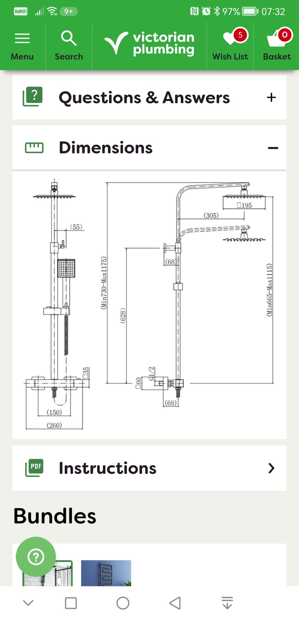

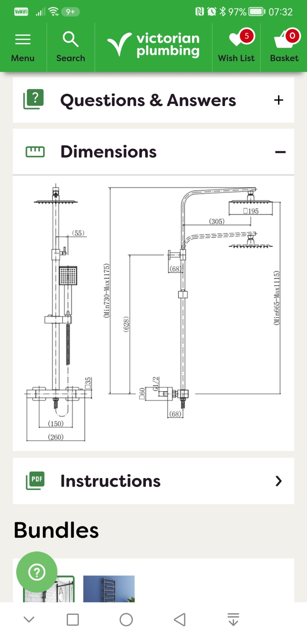

I didnt get round to doing this, then a video from BEAumber came up.in my feed.
With these fittings, I shoukd be able to fit the bar?
Video to what he did at 4:12
Is this realistic?
Thanks.
Hi
Yes they are 150mm apart, just was not sure they protrude enough for the fitting,this video seems to show a fix for that.
Also checked and hot is on left side as you look at shower.
OK.
You won't know till you expose them.
