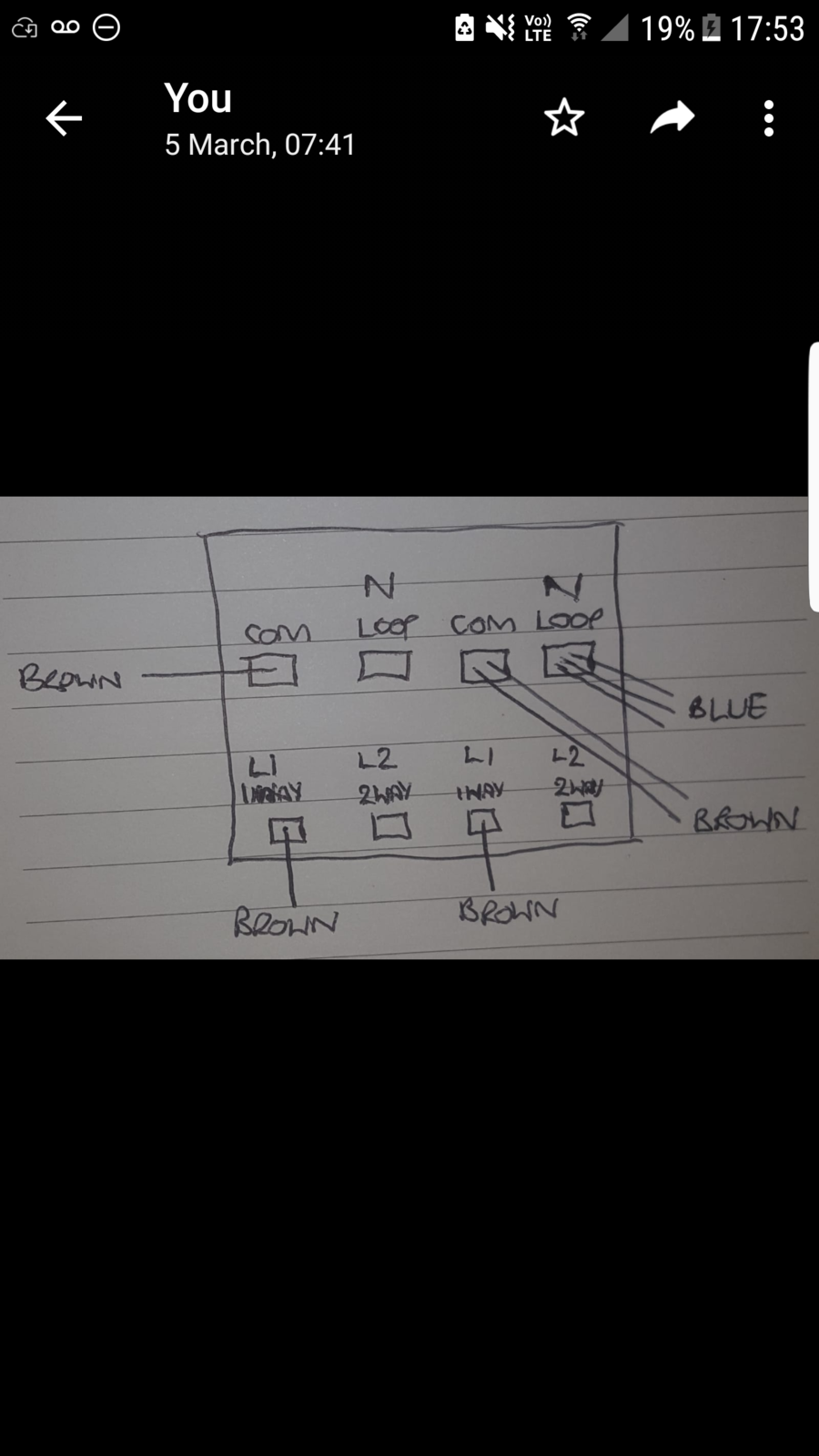

Hi,
Il attach pictures aswell but im basically trying to change a 2 way switch with a double dimmer, my bulbs are dimmable and can take load etc its just not as easy and placing a wire from one live to the next to me.
Your new switch doesn't have a loop terminal so you will have to use a loose connector for the blues, and tuck out of way of the switch.
L1s are a straight swap from old to new, and the coms go to the arrow terminals.
And if the plate is metal it will have to be earthed.
