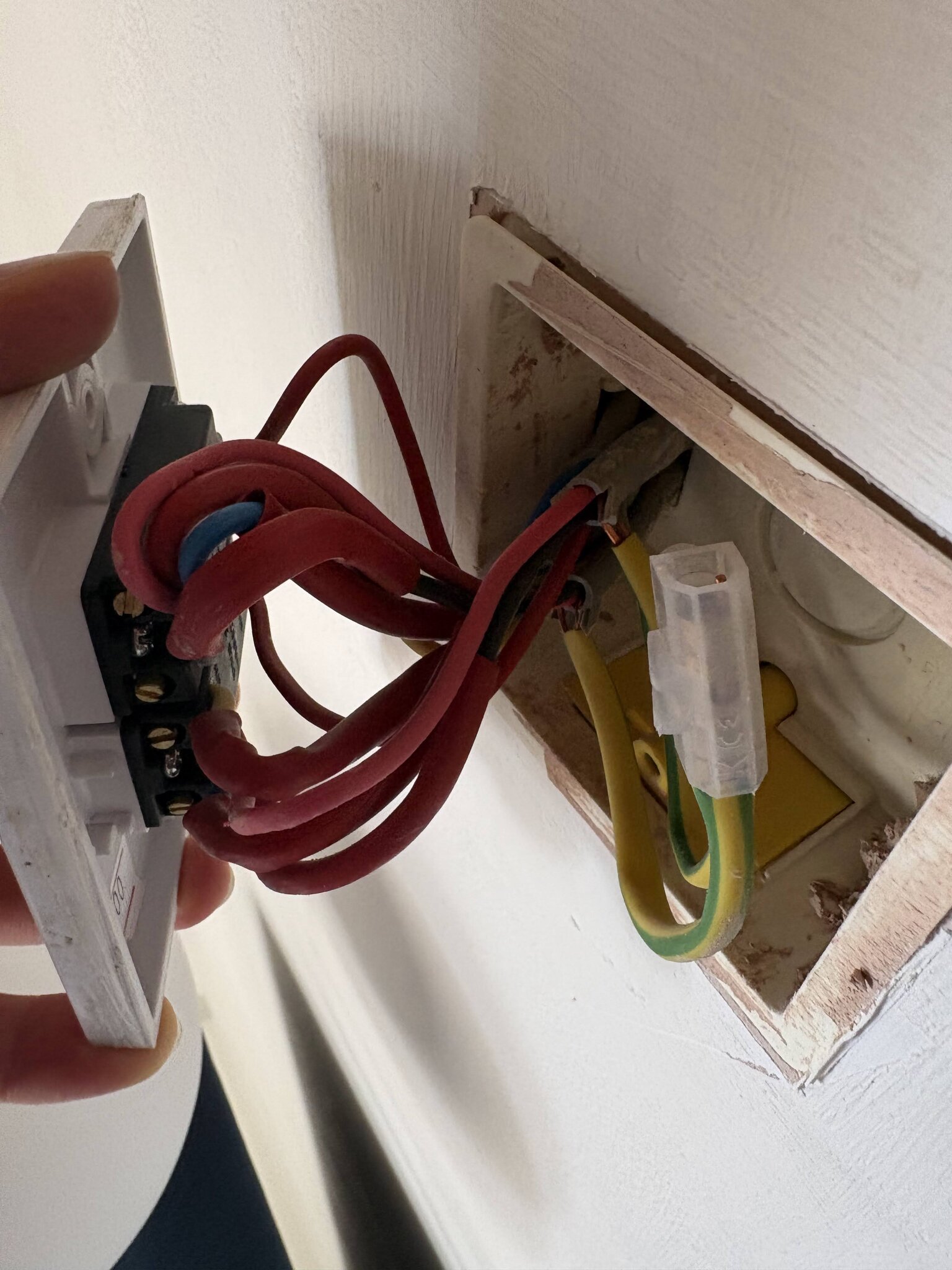

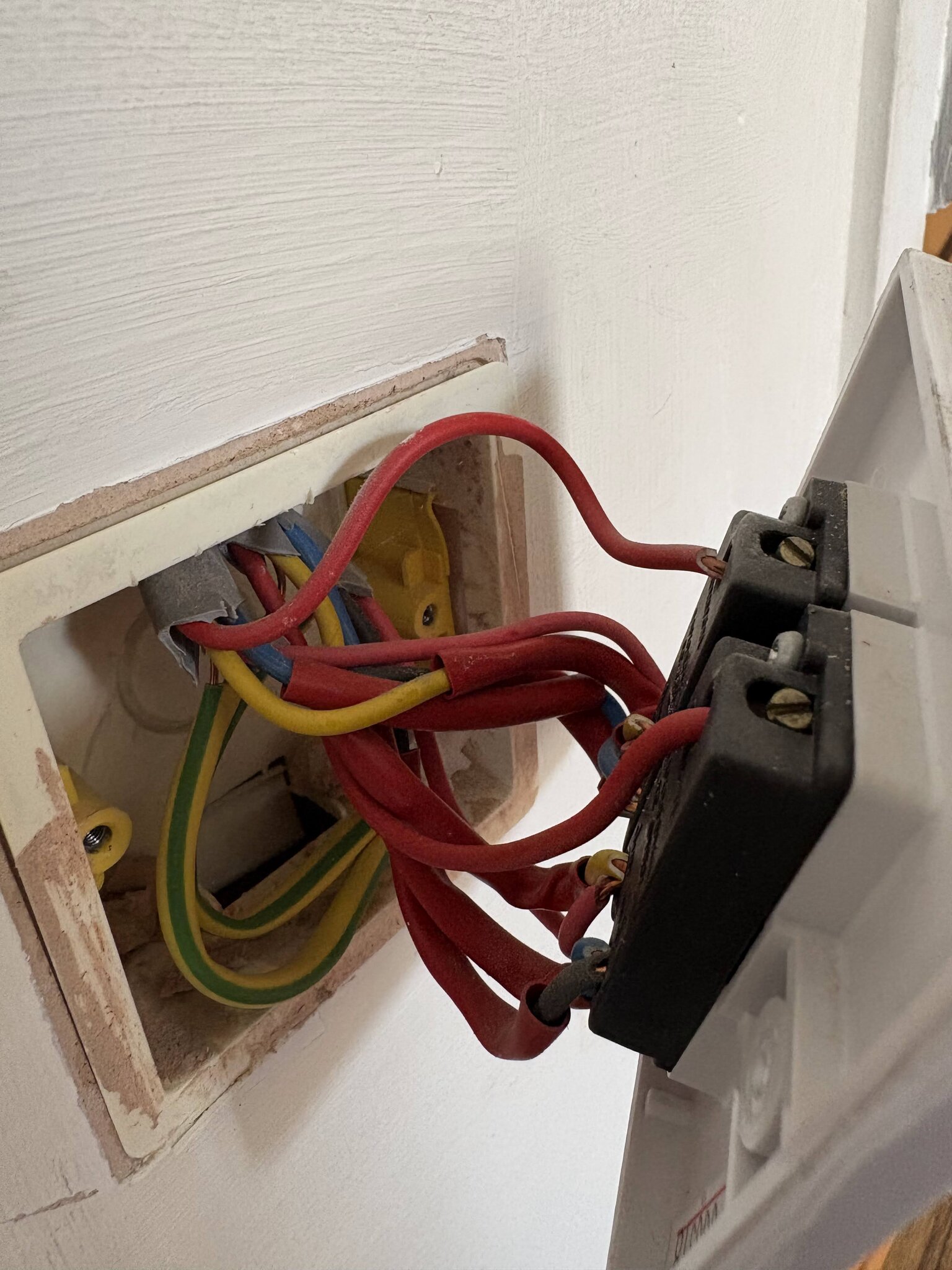

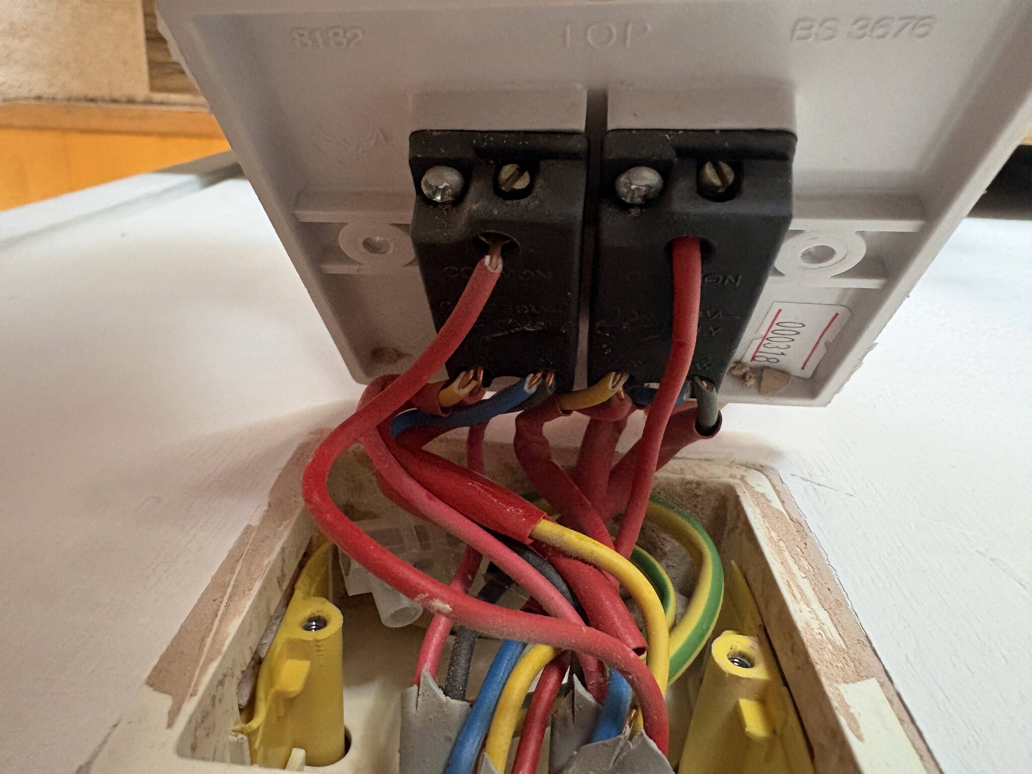

Need to replace this 2gang 2way dimmer with a new one as this one broke. There’s also 2gang plain button switch for the same room, both button seem to switch the lights on/off.
As only one switch/dimmer on this unit worked before I bought 1gang 2way dimmer (Varilight vpro, to also use dimmable leds).

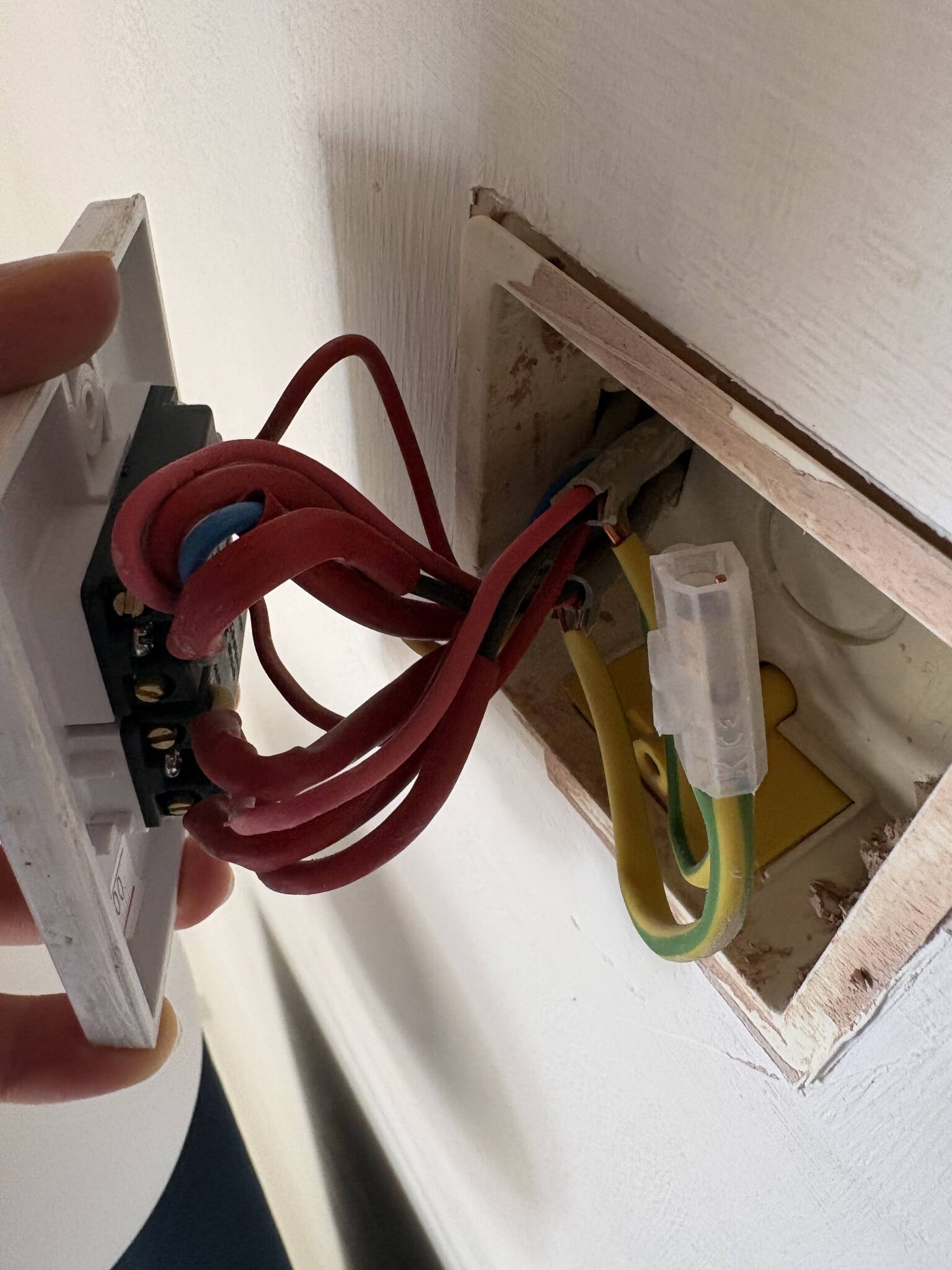

This is old wiring photo. I connected both reds to Live, both blues to L2 and both yellows to L1 on the new switch, left the earth as it was separately.
As a result of the dimmer switch change and bulbs swap to dimmable leds, the button switch works (both buttons), but the dimmer switch doesn’t dim or switch on/off. How can I correct the setup?

This is the photo of the old one.

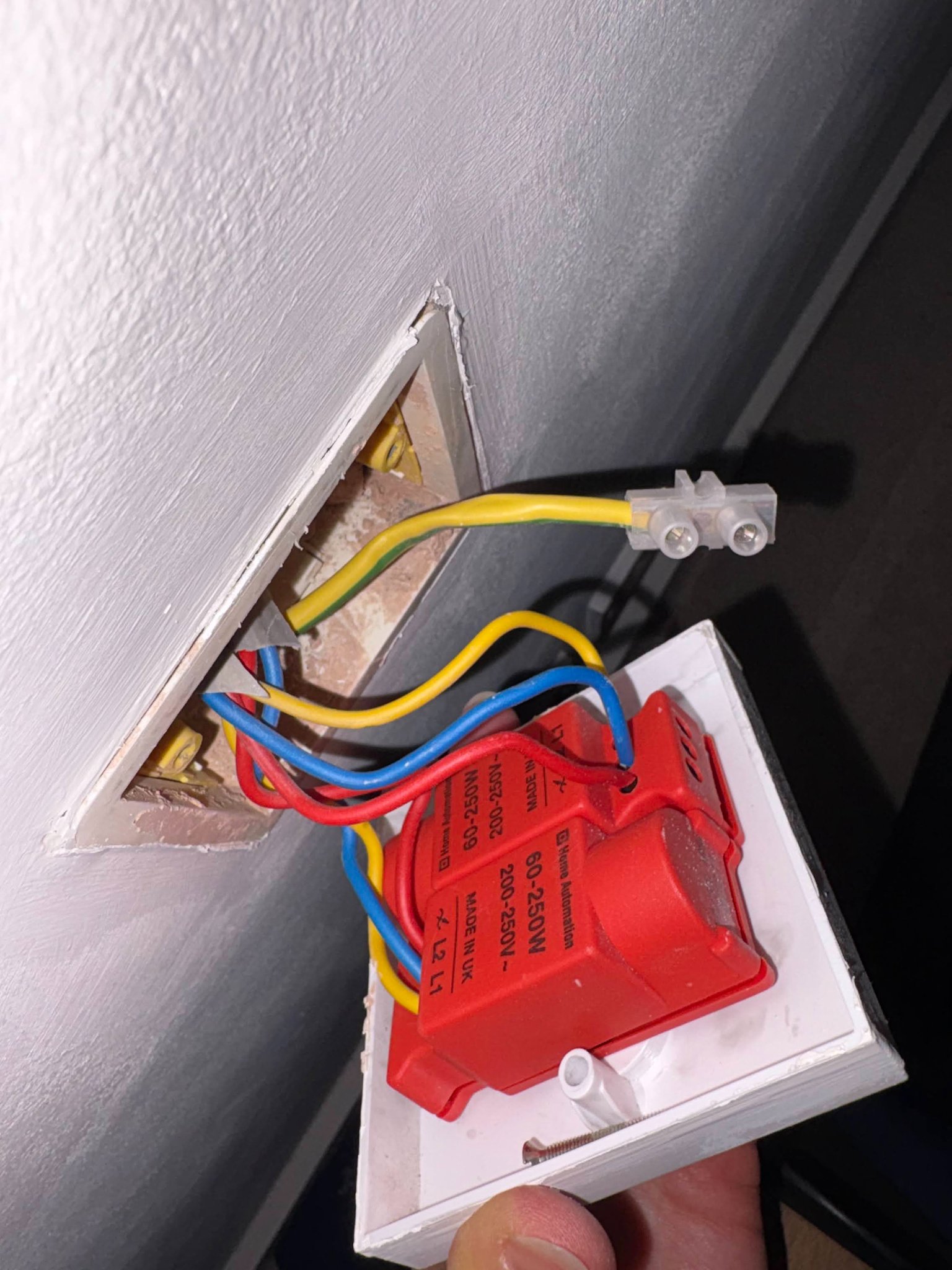

There are only 3 connections on the new switch (standard 1 gang 2way) - ~, L1, L2. The new one has 2reds together going to ~, 2 blues to L2, 2 yellows to L1.
I only need one button really - why do I need a 2 gang switch? It should control all the 4 lights at once like the old one did (the second button before wasn’t doing anything).
Can I wire 1 gang switch to control all the lights in the room, and also so that normal bottom switch (at least one button) controls the lights on/off from the other side of the room?
I need 2 way because I have a switch for the same lights at the other side of the room, but I don’t need 2gang as I want to turn on/off all the lights at once, so I got 1gang 2way to replace the old broken dimmer.

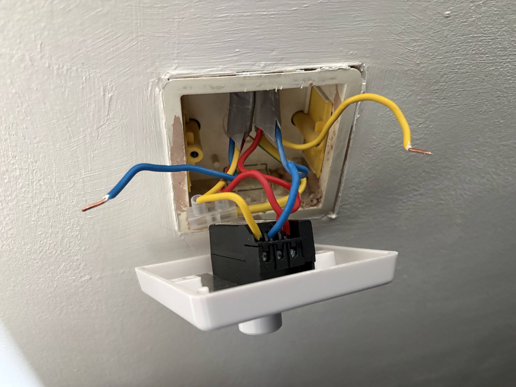

Can anyone please point me how to correct the wiring? The original is on attached photo, the new one I tried like this:
I connected both reds together going to single ~ connection, both blues to single L2 connection, both yellows to single L1 connection.
In that case, your wiring seems correct, so either faulty unit or perhaps in childlock mode?

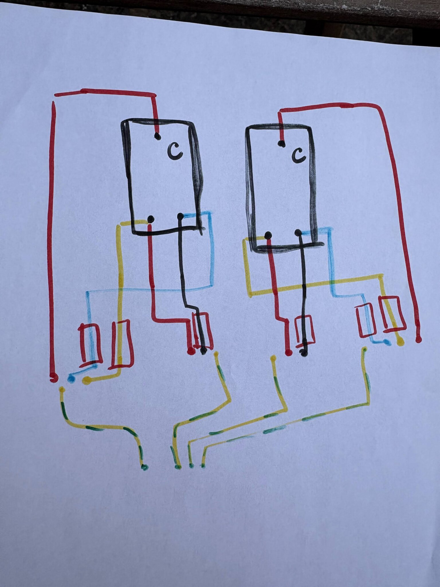

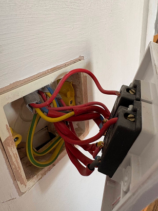

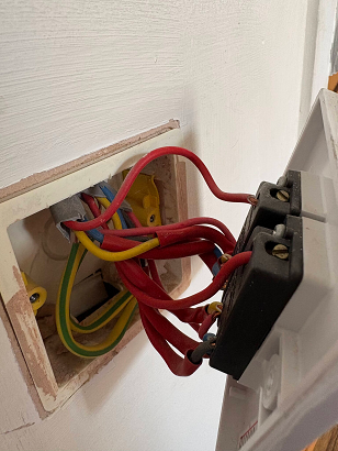

So here are the photos of the wiring on the other side - 2 gang 2way, but both buttons control the same lights (lots of wires here, so I took photos from different sides and also tried to draw the diagram to the best of my understanding):
And this is my new dimmer switch (1gang 2way) - I tried this or (like mentioned before) both yellows together, both blues together and both red together (C):

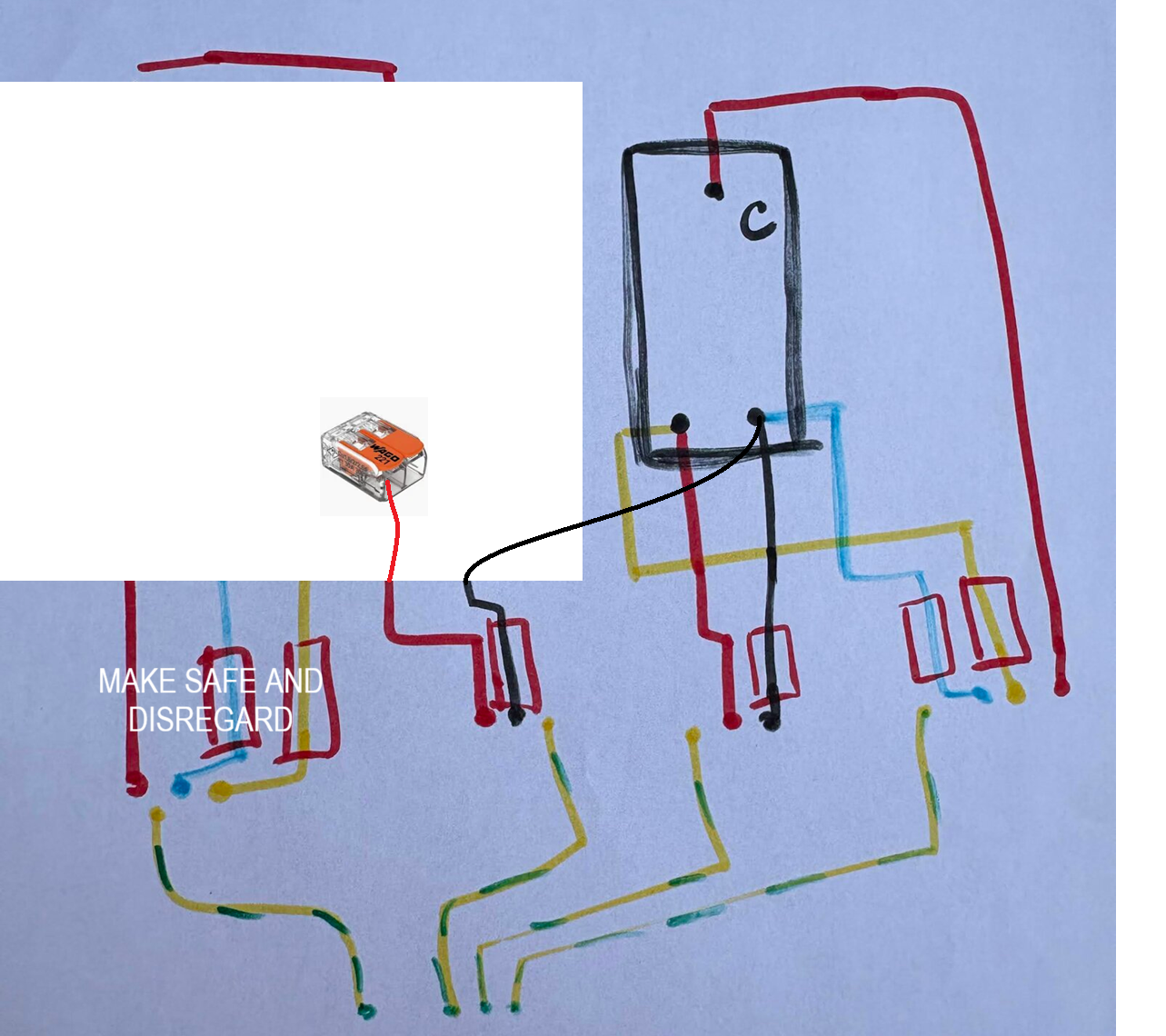

First thing you must verify both sets of lights are on the same circuit/fuse/MCB etc.
Second you must verify which of the red and the black are the permanent live and the switched live.
Assuming red is permanent live I'd expect it to be wired like this:
Personally I would make the second permanent live safe in a connector to save future confusion

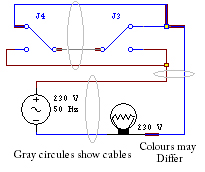

Looking at this switch 1782919348119.png it seems there are three cables one red black which is likely the ceiling rose to switch cable and likely goes to L1 and L2 with some wires from a triple and earth cable and if the wires of the twin and earth were moved to Com and L1 instead and the triple and earth cable disconnected that lamp would likely work simple on/off without the two way, however it seems the second switch in the bank is the slave rather than the master.
This is how I think your two-way is wired, moving to a single switch using the right switch is easy, not so easy if using the left switch.
Looking at this switch View attachment 417658 it seems there are three cables one red black which is likely the ceiling rose to switch cable and likely goes to L1 and L2 with some wires from a triple and earth cable and if the wires of the twin and earth were moved to Com and L1 instead and the triple and earth cable disconnected that lamp would likely work simple on/off without the two way, however it seems the second switch in the bank is the slave rather than the master.
View attachment 417659This is how I think your two-way is wired, moving to a single switch using the right switch is easy, not so easy if using the left switch.
There are 4 cables and and two sets of 2 way switches. OP wishes to do away with a complete 2 way circuit and have one remaining 2 way circuit operating both sets of lights.
