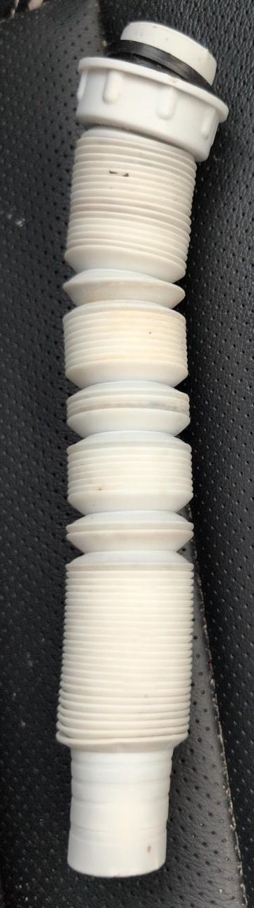

The basin has an overflow, and a flexible plastic pipe runs from the overflow outlet down into the trap. That pipe has developed a hole, so any water that dribbles into the overflow during normal use ends up leaking under the basin.
B&Q don't sell the part separately, which surprised me given they still sell the basin. After some searching I thought the McAlpine FLEXCON1 (1 1/4" uni outlet x plain spigot) from Toolstation looked right, but in person it was far too big. It's basically a larger version of what I need, and they didn't have a smaller one.
Measurements of the old pipe:
Photo of the pipe:
Does anyone know of a compatible replacement, or even what I should be searching for? I'm at my wits' end with this one. Thanks in advance.
- Narrow spigot end at the bottom: roughly 25mm diameter (about 1")
- Corrugated section: about 30mm diameter
- Plastic nut at the top: about 40mm outside, 32mm inside
- Length: about 200mm fully contracted, and I need around 300mm, which it extends to easily
Photo of the pipe:
