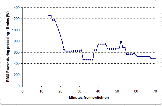

One can't, in the sense that you are trying to do. However, as I keep saying, one can have 'diversity over time' as well as 'across loads' - i.e. one can consier the average load over a 'reasonable' (say 30 min) period of time. I fairly recently illustrated (see here) that in relation to my ('single element) 1.7 kW fat fryer, the average draw over the first 15 mins (from cold) was 1,200W, and that settled down to about 600W (and remained at that level thereafter) within the next 5 minutes or so. Extrapolating from that to a ('single element') 3.6 kW oven, one might expect that the average over any 15 min period would quite rapidly settle down to about 1,270 W (i.e. around 5.5A) ......

I respect your view but, as I suggested before, by saying that one has to consider the maximum instantaneous current, rather than the after-diversity (i.e. 'average') current, you appear to be effectively rejecting the application of diversity.
