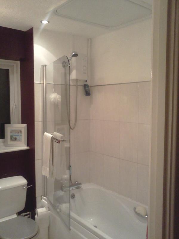

Hi,
Our bathroom ceiling has both a loft hatch and downlighters installed. Another (easier to access) loft hatch has been installed elsewhere and the downlighters are pretty shoddy so rather than fill in the gaps left in the ceiling we feel it'd be easier to simply replace the entire ceiling.
How would we go about this? Simply buy another bit of plasterboard and screw over existing? Knock down ceiling and install new? What about moisture protection?
Many thanks in advance :)
(you can just about see the ceiling / loft hatch in the picture attached)
Do you know what the material used on the ceiling is (plasterboad/lath&plaster)?
Is the ceiling sound an secure?
If it is overboard it using foilback board will offer a vapour check barrier, but if you have good ventilation in the room may not be need also if a vapour check already exist will not need one. But having it will be an advantage.
Knocking down ceilings is a messy job and if can be avoided, I would!
but the ceiling/joist must be secure and able to hold the additional weight of extra boards and plaster.

Remove the ceiling and replace with 12.5mm foil back (duplex) plasterboards.
You may have issues with board thickness conflicting with the downlight clips, should you double board.
Over boarding is by far the fastest and cleanest way to sort your celling. Use 9mm board and if you have concerns about spotlights going in. Then just simply make over size holes in existing celling before you board.
If you do choose to pull celling down then clean and hover in loft first.

I would never use 9.5mm boards on ceiling as they will sag over time and this will also mean that the joints will crack under pressure/stress.
12.5mm for ceilings.
I have found that some down lights actually fit better with a double layer of boarding on the ceiling, so it will really depend on the downlights you buy.
I would suggest you get suitable ones to prevent the spread of fire and moisture into the void above.
That would be rite but not when your over boarding. As you've got a solid backing a 3 8 board is fine.
i agree with ricke21 i always use 9.5 when over boarding & 12.5 when taking back to cieling joists.
just remember to use the correct length of drywall screw and locate the cieling joist to screw to when over boarding. this should not create to much of a problem has you have access above
