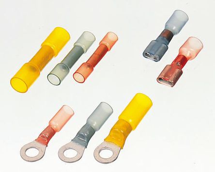

If you do use crimps, and you are concerned about insulation, RS sell a range which have quite a long overlap of heat-shrink insulation integral to the crimps:
They're made by Raychem, so no doubt available from other fine suppliers.

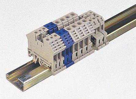

Also, FWL - I've wondered before about using rail mounted through terminals like these when needing to extend several cables:
You can get them capable of handling any size cables and currents you'll find in a house, and they have terminals where plates bear down on the conductors, so IMHO superior to ordinary JBs. You could easily mount a length of DIN rail in an ABS box on the wall.
Would they be acceptable?

Ban, using DIN rail mounted terminals would be a great way to go, although very expensive by the time you add all the costs.
They're not that bad..

Adaptable box & DIN connectors sounds good to me........
