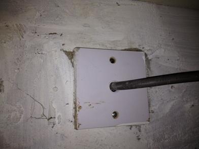

Hello,
I am replacing my washing machine which is currently hard wired beneath the kitchen shelves. It' supply is coming from a switch with inbuit fuse (image here).
I am thinking of installing a 13A socket for plug of my new washing machine beneath the shelves to remove hard wiring.
1) Is it advisable to use 13A socket to remove hard wiring which gets supply from a switch(with a fuse) as described above?
2) The new washing machine plug also has got a fuse in it. My worry is, Is this ok to plug in the new washing machine(having a plug with a fuse) to the socket (which I am going to install in point 1) which already gets supply from a fused switch(image here) as described above?
So this way I'll have two fuses in the supply one from the switch and second from the washing machine plug. Is that ok?

Yes there is no problem with doing that.
It should be fine yes. There is the chance one fuse will blow, and if the fused spur doesnt have an neon, you will need to check both fuses, until you find the failed one.
The other option, if the cable from the fused spur to the socket behind the washing machine is of a suitable size, is replace the fused spur outlet with a 20amp dp switch, with neon if possible. That way the only fuse will be in the washing machine plug. If you do this the cable between the switch and the washing machine socket should be 2.5mm T&E
Someone else can confirm, but I think a 20amp DP switch would be acceptable, as the socket could only draw a maximum of 13amps (assuming a single socket), so would not be able to draw the full 32amp of the circuit (if its a typical ring).
If you are the UK, this would probably be notifiable work, as you would be making a slight alteration to the circuit.
Before you do this check your measurements. Sometimes the hard-wiring you describe is to give a few extra millimetres so the washing machine can go all the way back under the worktop, especially if it's integrated with a "door" to match the kitchen units. If you replace the flex outlet with a socket and plug, the machine might have to project forward from the cupboard line.

I'd suggest a slim-line socket, and switchless. In the past I've pushed a machine back, to find something has knocked the switch on the way in!
If the cable to the machine comes directly out of the FCU, i.e. does not come from a flex outlet plate which you would replace with a socket, then the work would be notifiable.
Attached is the image for my current hard wired washing machine. Is this flex outlet plate? So can I replace with 13A socket without issues(as per you comment in quotes)?
