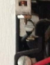

I am looking to change my old thermostat for a new one but am struggling to understand the wiring difference. The old type has 3 wires coming in (red, black and Earth). The new thermostat doesn't seem to be compatable as there is no mention of the earth cable on it. Anybody able to help?
You do not need the earth so just put a connector block on it and position safely out of the way.

Just to clarify I'm connecting the live to number 1, neutral to number 2 and isolating the earth in a connection block? Thanks
The wires you have are live (1) and switched live (2). If it were neutral there'd be a big bang.
And yes, earth in a terminal block.
Although with new thermostat neither earth or neutral are required and one would simply connect the two wires, with the old one neutral was likely required and it seems likely the wire coloured as earth is actually a neutral.
It does not matter now, but could matter in the future if the thermostat is changed again.
It might be an Earth used as a "neutral" to supply the accelerator resistor. This is NOT good practice but allows the bodger to use twin and earth instead of bothering with triple and earth. The current through the accelerator resistor is often small wnough that an RCD on the will not be tripped by it.

I think there is something is seriously wrong with your existing installation!
The old thermostat looks like a Satchwell Sunvic TLX to me, there are lots of variants out there but I believe it maybe a model 2259, The model number and a wiring diagram should be shown in the lid, or on the terminal cover. If it is a different model, then the following may not apply, so it is crucial that you find out what you actually have. If it is a 2259 then:-
It should be a four wire installation, the earth connection should be made to an earth terminal on a metal backplate behind what is shown in your photograph. [see image below which should have an earth sleeve but was the only picture I could find] My guess is that there is not an earth wire connected to yours, and so in the event of a fault, you may have a potentially dangerous installation.
The thermostat is then screwed to this backplate and the three terminals numbered left to right are 1, 3 & 4. [Terminal 2 is for cooling applications and not fitted to this model]
Terminal 1 is the switched live that leaves the thermostat to control the heating
Terminal 3 is the live supply to the thermostat
Terminal 4 Should be a neutral to operate the 'accelerator' (it seems like the earth wire has been used for this function and even wrongly identified as an earth by fitting an earth sleeve, on the other hand if it really is connected to earth at the other end, it should not be connected to that terminal)
The remedy is to remove the existing 2 core and earth cable and install a three core and earth, or install a thermostat that doesn't need a neutral connection.
The new thermostat you show looks like a Honeywell, you can download an installation guide here. Unfortunately, they do normally need a Neutral connection to work effectively.
