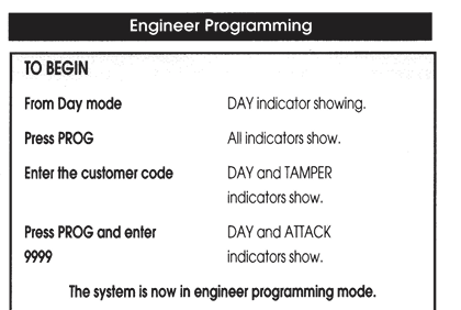

Hello folks. I have an Optima xm6 alarm system and may have to replace one of the PIR sensors. Could anyone tell me if I can change the sensor without setting off the bell box. Is this possible? What would be the modern day make of sensor to replace the existing one? Someone told me to link out the pir zone but I am not sure what they mean by "linking out". Is "linking out" a zone on the board to do with the small metal connectors (of which there are several) in the control panel? Thank you for your help.

If you put the panel into engineer mode, then you can open the panel without setting off the sounder. This is from The XL6 but the XM6 should be the same. It has been quite some time since I last did anything with one. Give it a go!
Many thanks for the answers from secureiam and Deryck Tintagel. Ps. I have the engineers code and it is prog, customer code and 9999 as you have stated!
