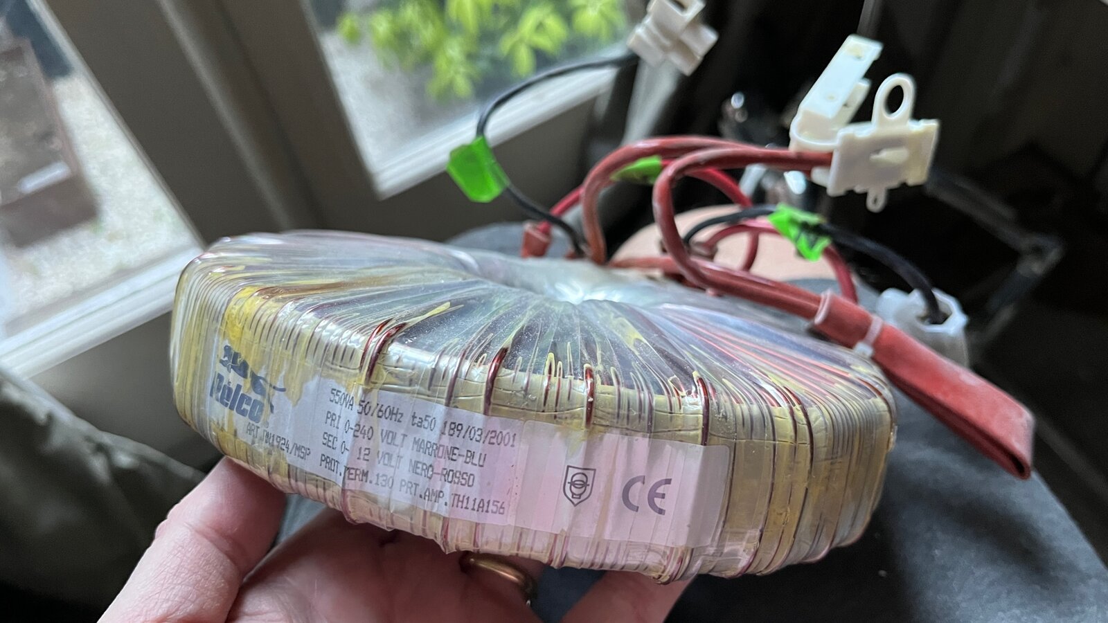

We're currently refurbishing a dining room and our current chandelier pendant light has lost half of the 20w halogen bulbs over the past year. Upon inspection it looks like some of the wires from the current transformer have burnt out ( looks very suspect and keen to replace). With 48no. 20W lamps currently fitted, we wanted to upgrade to the light to LED and thus reduce the power requirements. The transformer say its a Relco ART RN1924/MSP and is rated at 550VA. If we replace this with a suitable LED transformer to power 48no. 2w G4 LED bulbs, what should we be looking for?

Some led lamps do not like running off them electronic transformers, you previously had a toroidal transformer, try and get one of them, as long as the wattage is above your new led total wattage it should work fine.
Be careful fitting them in the base as if metal you can create a shorted turn and you may need to fit insulaters
That has happened because the light was designed for 10W halogen lamps.
48x10= 480W, well within the 550VA rating of the transformer.
With 20W lamps, it's 960W, well above it's design rating.
