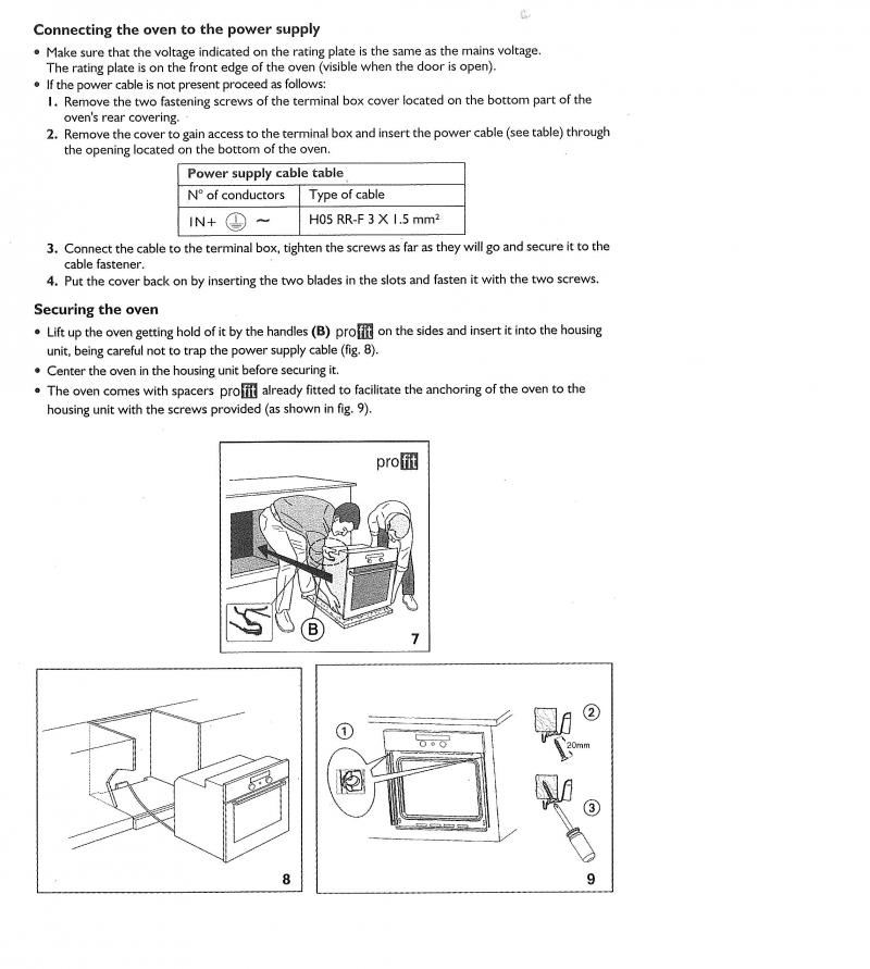

What size is the cable from the oven?

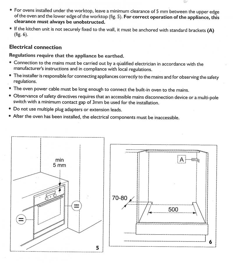

Do the installation instructions say what rating the circuit should be?

Anyway - the spec says 1.5mm² cable, and you should not put that directly onto a cooker circuit. But without knowing the actual rating there's no way of knowing if an FCU can be used.

There's usually a power rating buried somewhere in the technical specifications along with things like the dimensions and weight, rather than in the installation instrructions. There should be a rating plate or sticker, either on the back of the oven or on the door jamb so you can read it after installation by opening the oven door. The plate usually reads something like "220 - 240 V, 50 Hz, xxxx W". The 'xxxx' is the interesting bit.

There is a socket on the wall above the worktop, built into the control unit/cooker switch, however the lead which comes from the oven won't reach that far, and there are no other plug sockets that side of the kitchen. Is there a way to convert the terminal outlet box into a plug socket? Or will I need to get a sparks in to wire a plug socket down to below the units, as I believe any new wiring can't be done by me.
