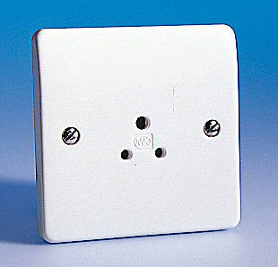

Plus there is the question of how big it is. If it is small (2 amps), then it is for lighting.

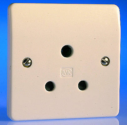

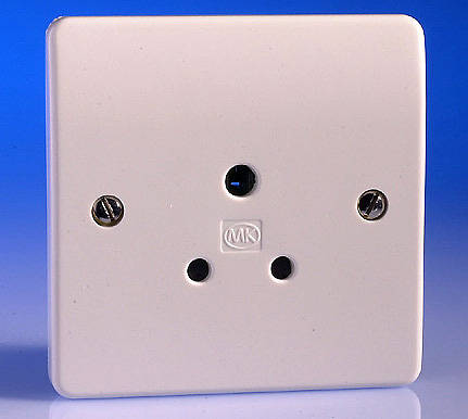

There are also medium (5amp) and large (15 amp) which are for different purposes. I.e. 5 amp would be ideal for a toaster, a tv or a larger light, and 15 for a washing machine, drier etc. You shouldn't wire on an over or underrated plug, the three sizes are for different loads. In someways its better than having fuses in plugs like we do now, as the fuse is at the CU , and it forces using the correct rating(how many times have you seen 13 amp sockets, attatched to a clock radio that have a 13 amp fuse in, simply out of lack of knowledge).

2 amp
5 amp
15 amp
