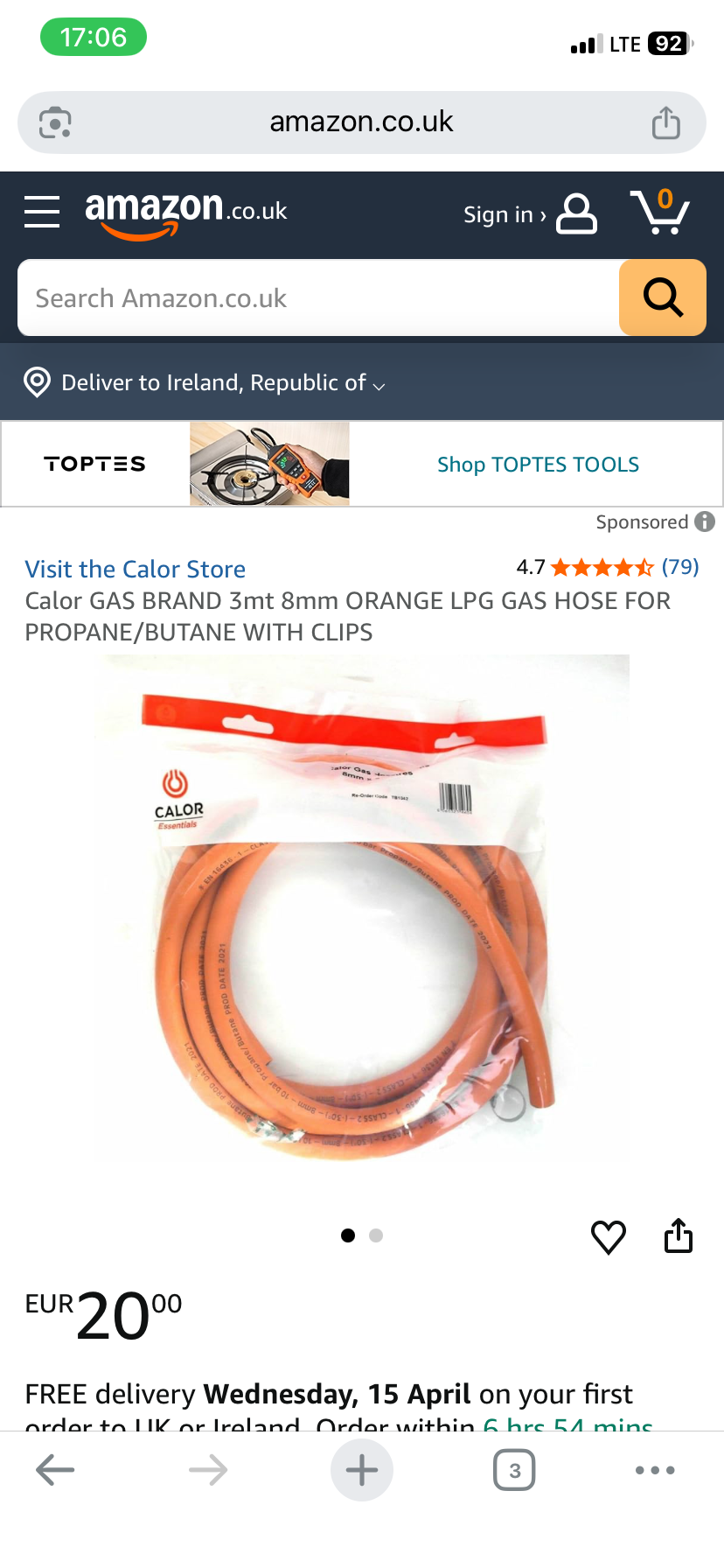

Im replacing the gas bottle regulator and hose but I see some hoses are 8mm and some are 9mm
Is there a standard size ?
And how do I reconnect the hose to the copper end ? Does it need to be lubricated ?
Will be stamped on regulator the hose size.
Probably 8mm.
You just push the new hose on
If it's tight dip in hot water for a few minutes. Half that price on eBay.
