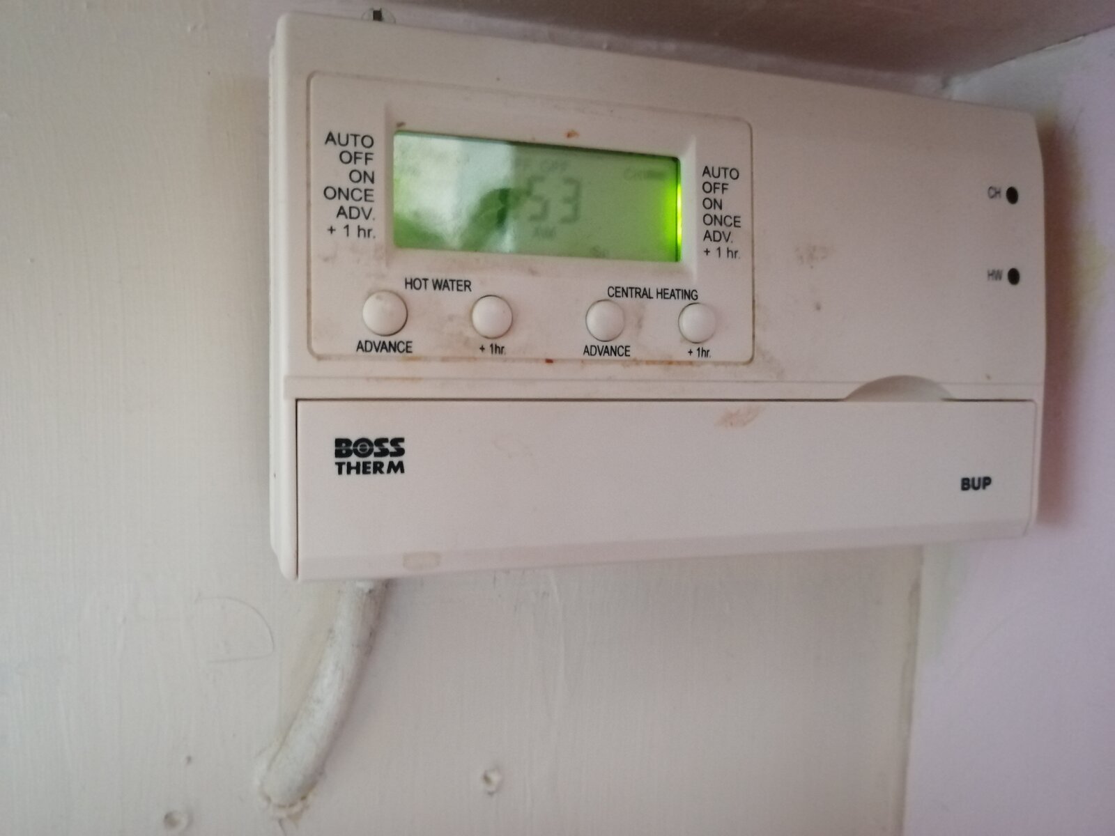

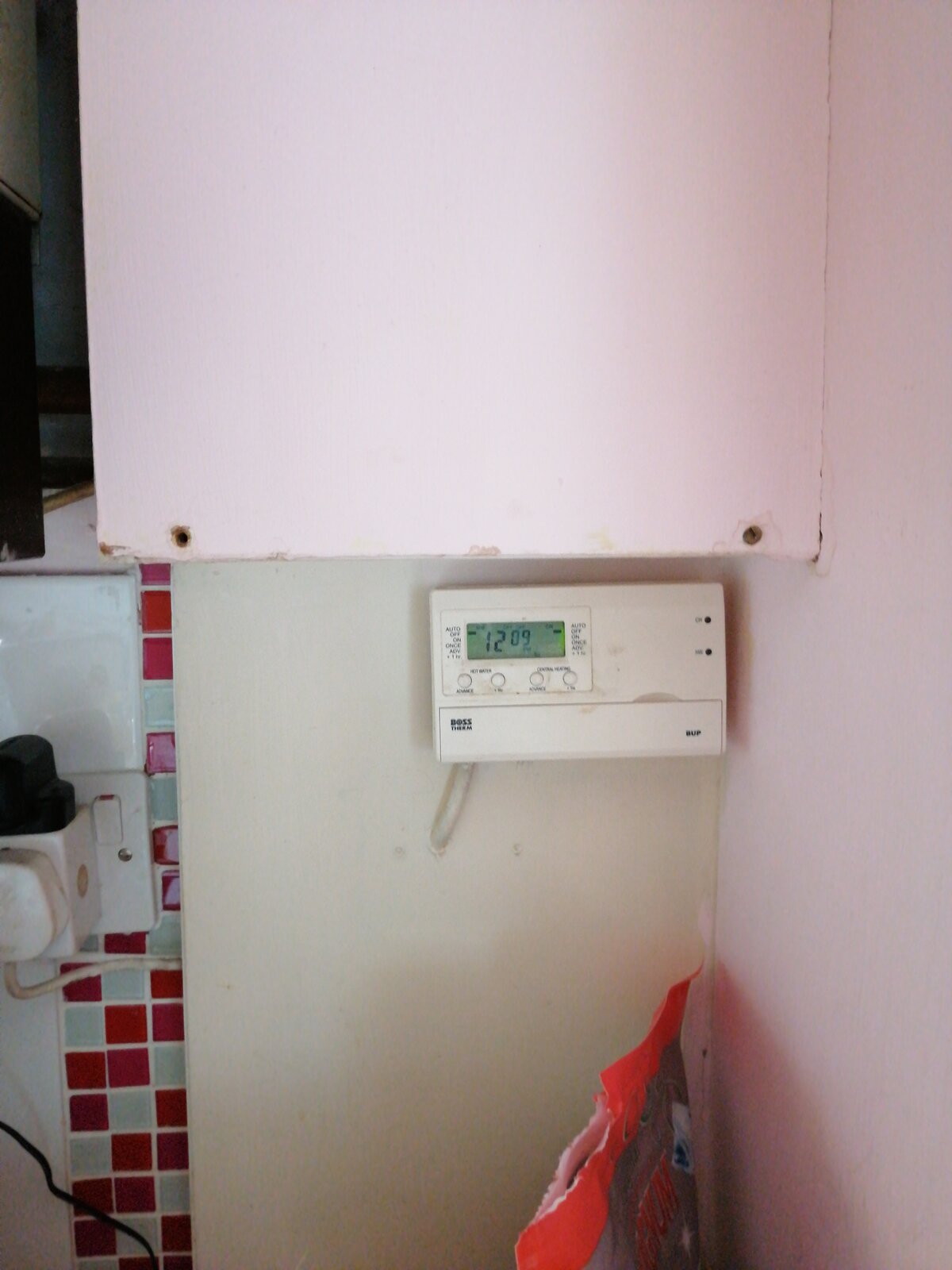

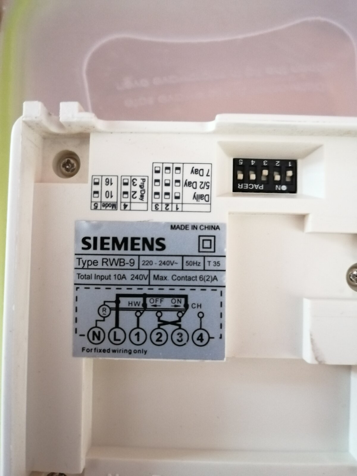

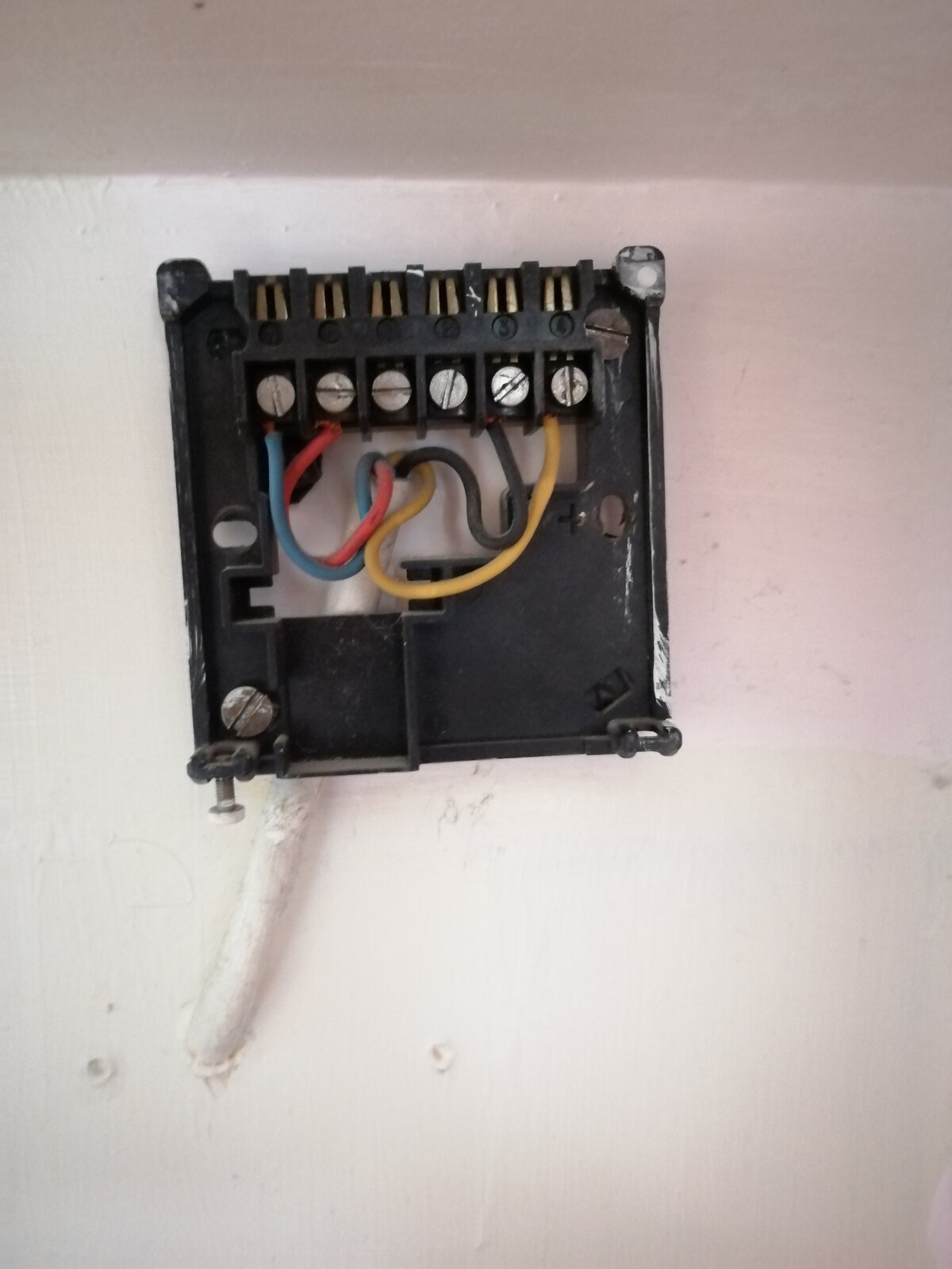

Hi All, redecorating downstairs and my wife would like thermostat removed. Wireless seems the way to go. I last replaced programmer 17 years ago. I recall then the backplate was common to the last programmer. Any recommendations please best programmer with wireless thermostat. Also is the back plate still commonly used so I don't need to wire up in a bug way. Thanks all for input. Simon

Are you talking thermostat only OR programmer.
I have 2 programmers installed Honeywell CM927 They are brilliant.
Think Hive uses that back plate. However the question is what boiler and control do you want?

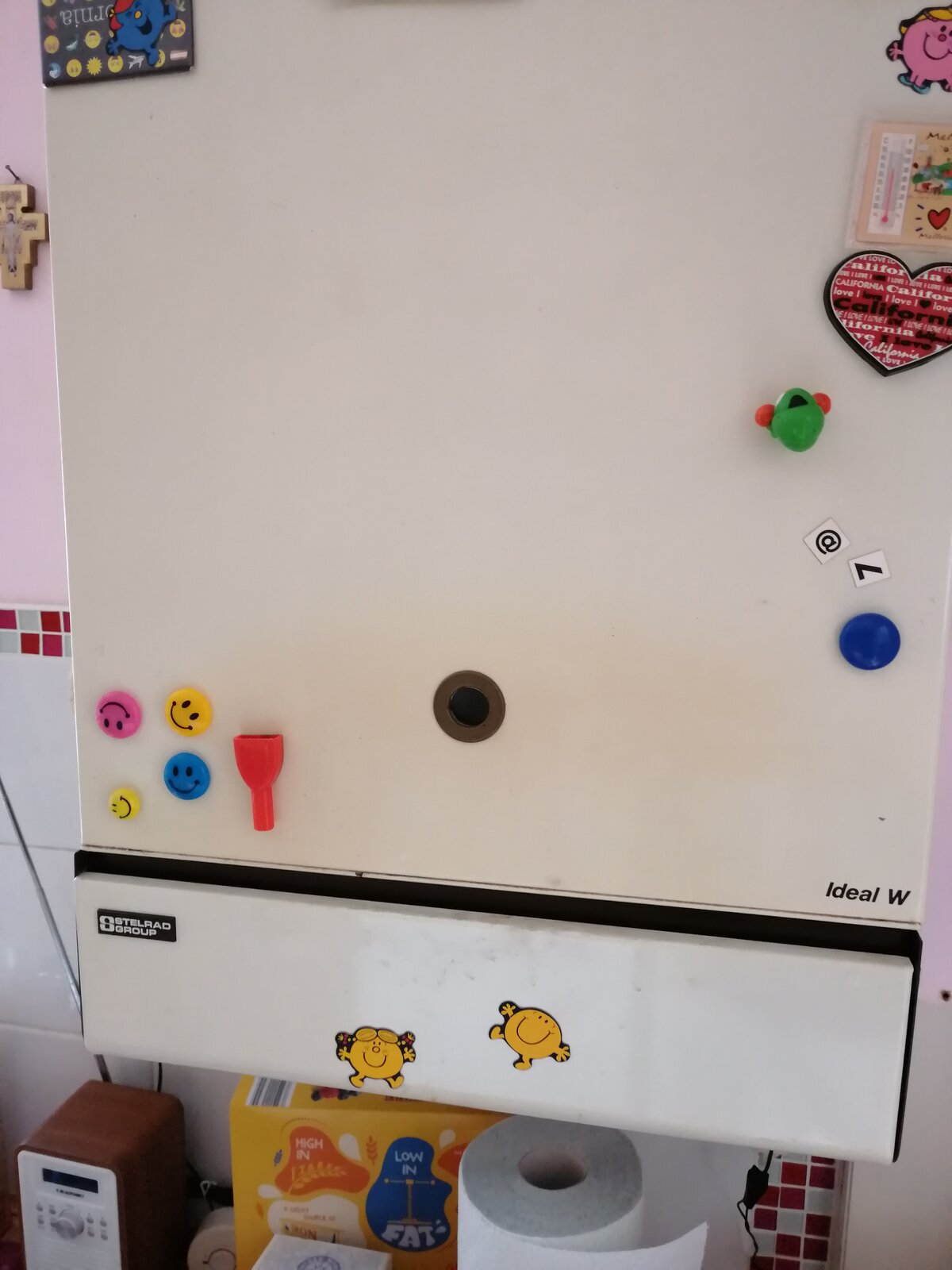

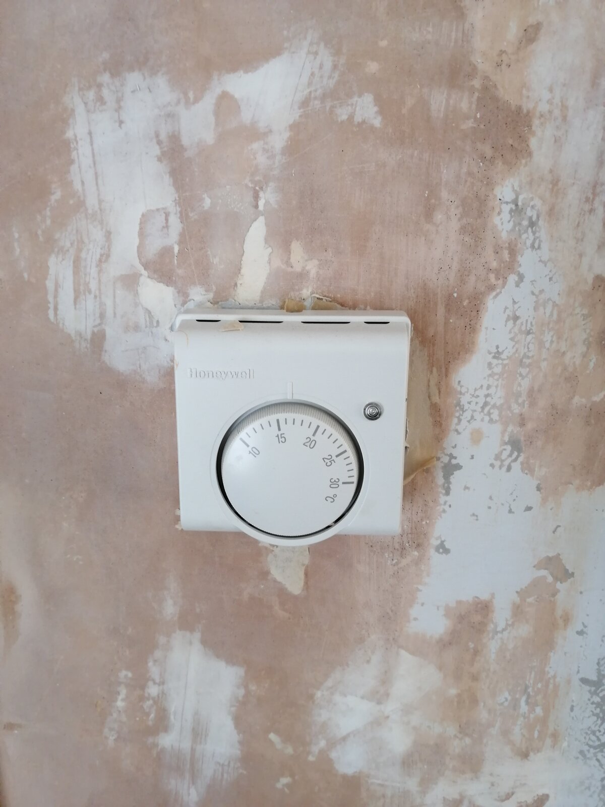

Thanks all, I'm looking at programmer and thermostat. The boiler is old, 40years but still running strong. The main work is around decorating (skimming) walls in living room and my better half wants rid of the room thermostat, tbh I'm also keen to go wireless as in RF linked or possibly WiFi to router and be able to control switching via mobile application. That all said, I have a few WiFi sockets that's about as far as my knowledge on smart home controls extends. I don't want this to be a big project, it's incidental to the main decoration tasks, I'm trying to use as opportunity to upgrade though not familiar with current programmers on the market. Boiler heats hw and ch, have two valves being switched, gravity feed system. Thanks for parting with your knowledge, will check Honeywell. Simon
The boiler and thermostat. Thermostat cover not on correctly, about to tefit

Programmable room thermostat might be a good option. Some people like the Honeywell T6 range, I haven’t used them personally.
Thanks, T6 looks nice, not sure I would appreciate all functionality at present. Honeywell Cm927 is RF as opposed to WiFi or smart app control able. Proven and on market many years, looks good, though..... Only controlling CH and not hw.... I continue checking reviews, thanks all so far for input.
