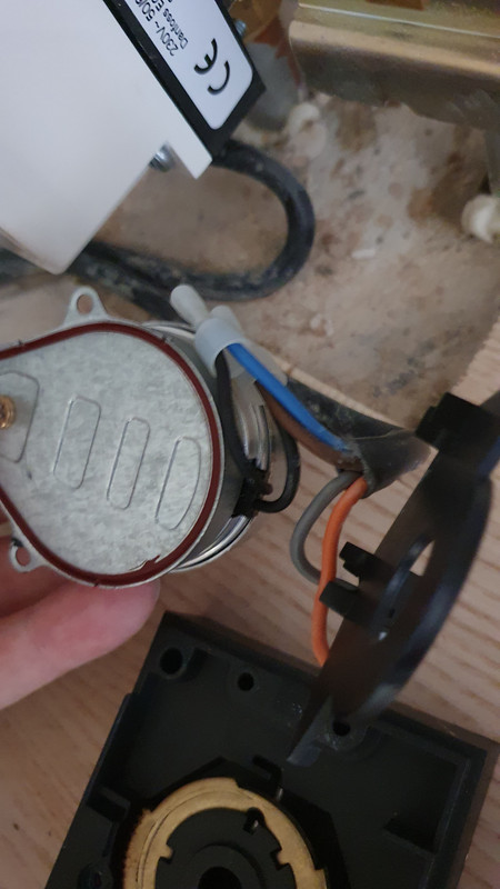

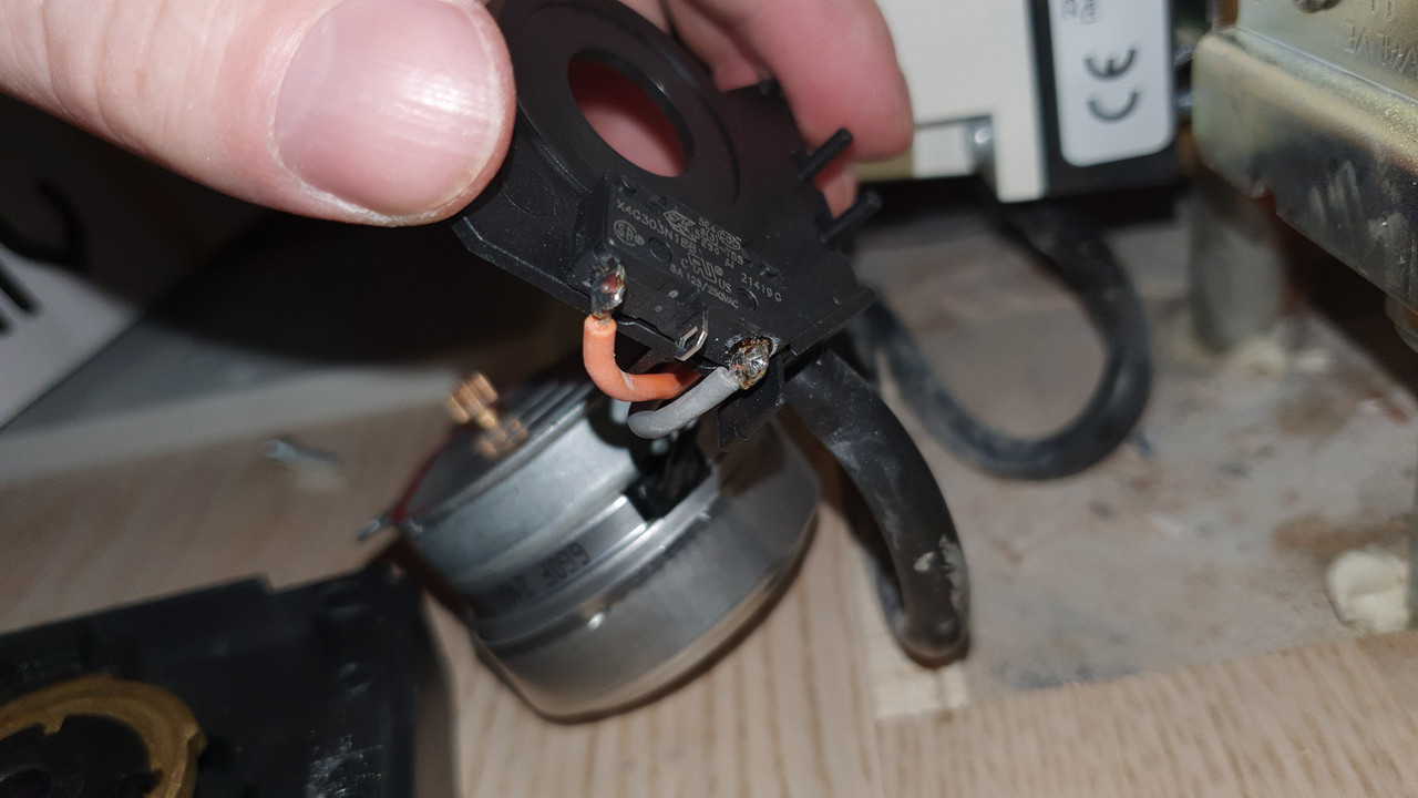

I found where are my motorised valves, however, I'm not sure what to do next. This is my motorized valves
and this is how it looks under the white cover

Do I need to disconnect any wire here and reconnect to my Nest Heatsink? or my Nest Heatsink connects in addition to all of this?

Not too sure why you’re dismantling your zone valve, as the heat links required would connect to the wiring center.

As @Chris_W says why are you taking the zone valve to bits, the receivers get wired into the wiring centre, not direct into the zone valves, follow the cables from the zone valves and you will find a wiring centre with lots of wires going in to it that is where the receivers get wired into

your pics arent showing but you dont wire anything into the boiler all the other wiring remains the same, your builder wont have a wiring diagram for your house and only the colour of the wires from the factory fitted cable on the zone valves actually mean anything, do no rely on the colour of any other wires, it is very simple, identify the Brown wire from each zone vave and this now goes into terminal 3 on the corrosponding hive receiver, the receiver needs a permanent live and neutral, then you have to disconnect the old thermostats , it is as simple as that
