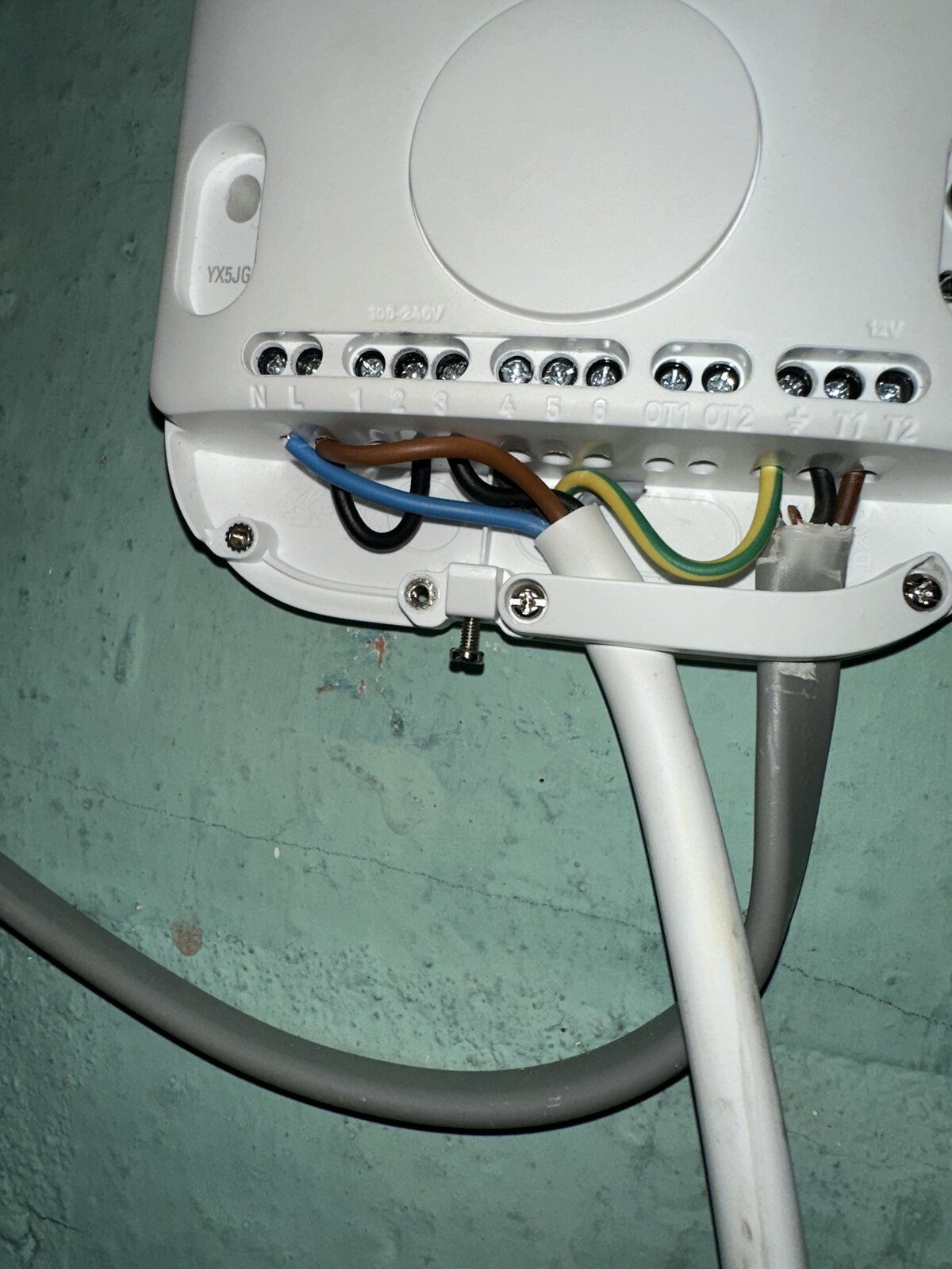

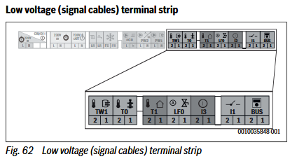

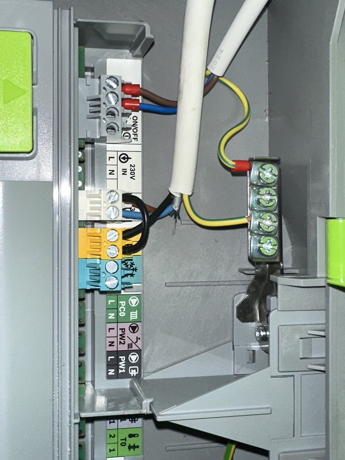

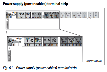

seems to be the CH (top) and DHW (bottom) links. I don't know why DHW can be turned on/off with a combi boiler, and you have not linked to the manual. I would only connect Nest to the CH and would leave DHW always on.
Seem to remember two DHW options, Eco on and Eco off, with Eco off the boiler had a small reservoir of hot water, so taps don't need to be full on to get hot water, but if used with a shower it can run out and go cold under the shower while the boiler get to temperature.
