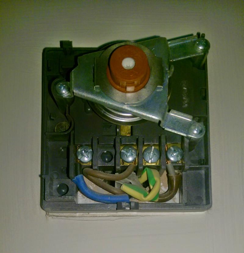

I've now been able to go inside my current stat and have confirmed that it is indeed a Danfoss RMT230 (with parallel accelerator) and is fitted to a metal back box.
The cable is 3-core-and-earth with old colours : Red, Blue, Yellow and "Bare".
Connections are currently wired as follows :
Red (presumably "Live") → Terminal 1 (COM)
Yellow (presumably "Switched Live") → Terminal 2 (ON)
Blue (presumably "Neutral") → Terminal 4 (N)
Earth → Back Box

Sounds right. You can always check the red and yellow with a meter, if you have one.
