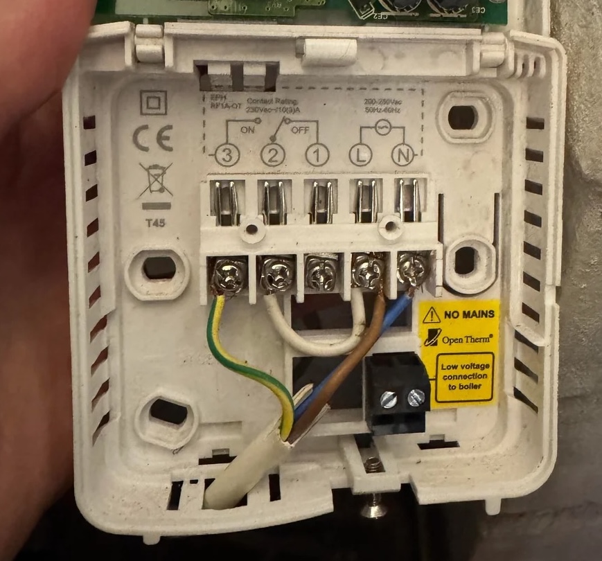

I’m trying to replace my old EPH receiver that is wired to my boiler with the Hive receiver, though do not know if more wiring is required. How can I make this fit the Hive? Live and Neutral are connected and there is a a wire going from live to 2 and earth is in 3.
With the Hive, I obviously put in live and neutral. Should I link the live to another, and should earth go to earth or should it be connected to 3 ie?
Any help is greatly appreciated!
The green/yellow wire is not an earth, but a switched live - it should be oversleeved in brown and would go into the Hive receiver terminal 3 (assuming single channel Hive).
The short white link wire would join between L and terminal 1 of the Hive receiver.
