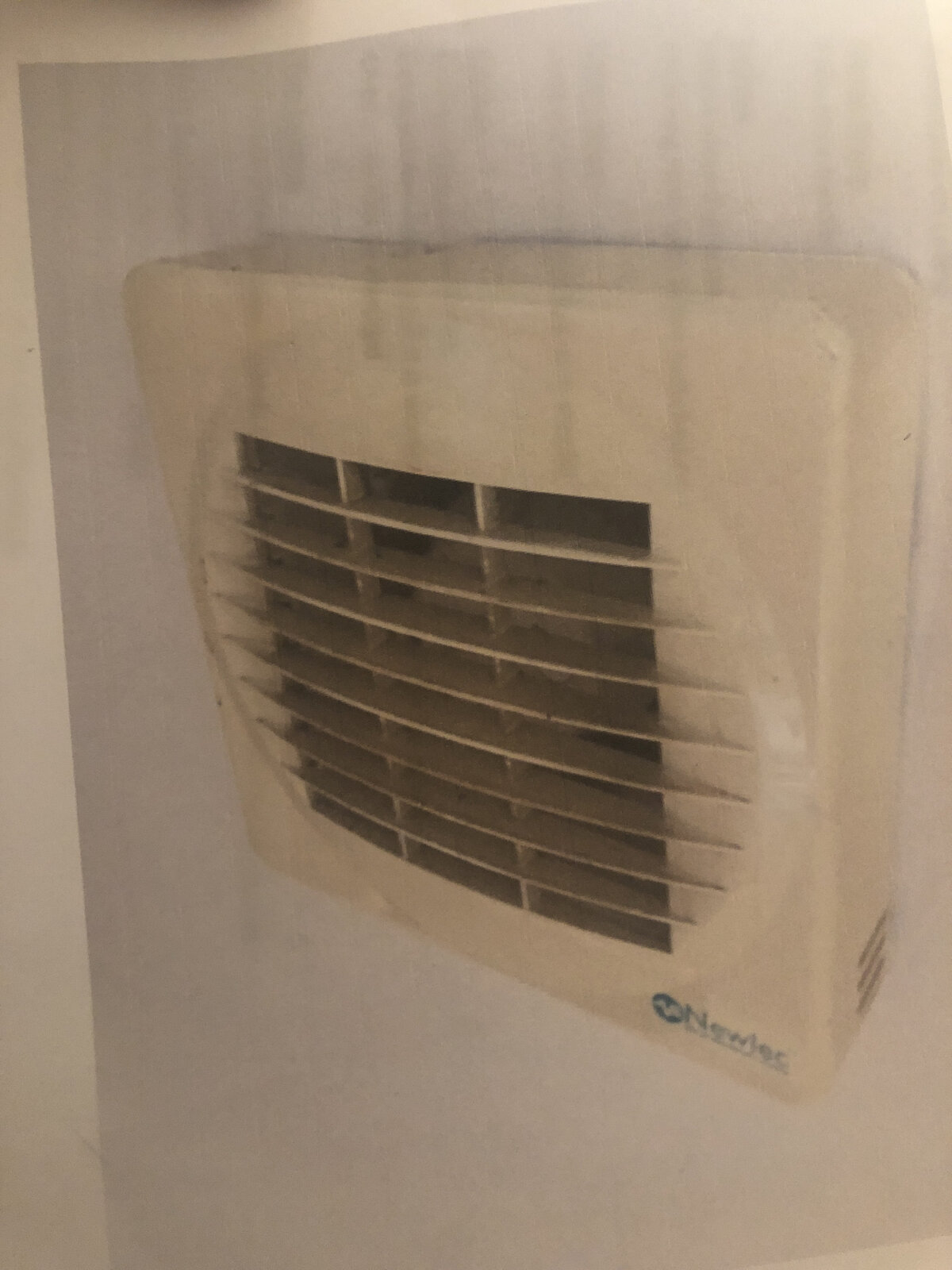

Hi I want to replace this extractor fan, but I want to make sure the new one fits, any guidance on what I can buy please. The outside cover measures 6” x 6”

Take it off and measure the duct size. Usually about 100mm diameter
Is it in a bathroom?
How far from the bath or shower?
How high above the floor?
If you measure vertically down from the fan, how far is it, horizontally, from the footprint of the shower tray?
And how far, vertically, from the floor?
Please be precise.
