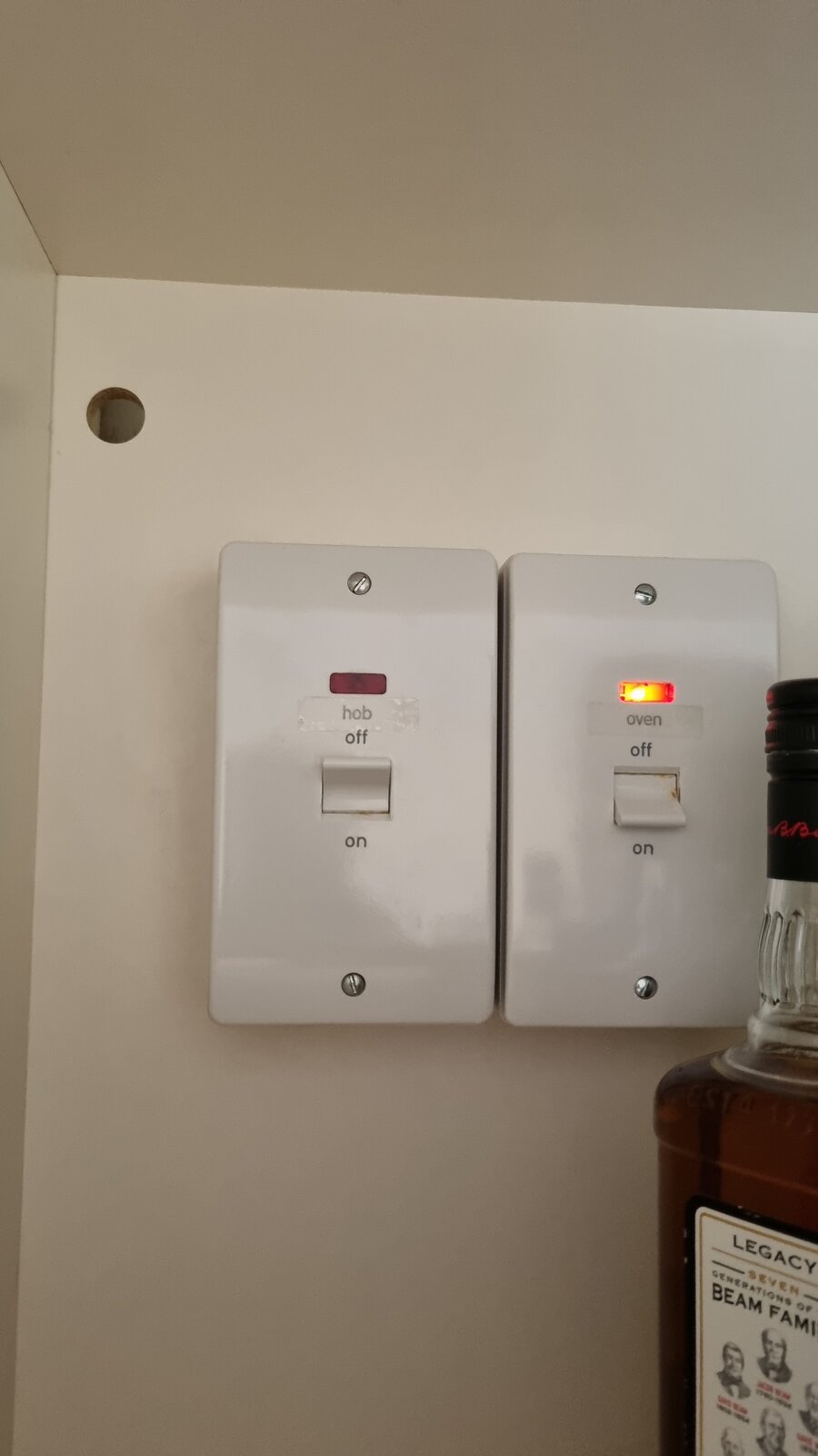

I've purchased a new induction hob and it comes with a plug. The hob I am replacing is hardwired in and the terminal outlet box is likely to be hidden behind the fitted kitchen cabinet and not accessible. The hob isolator is located in an overhead cupboard. Any advice or recommendations on getting this installed is appreciated?

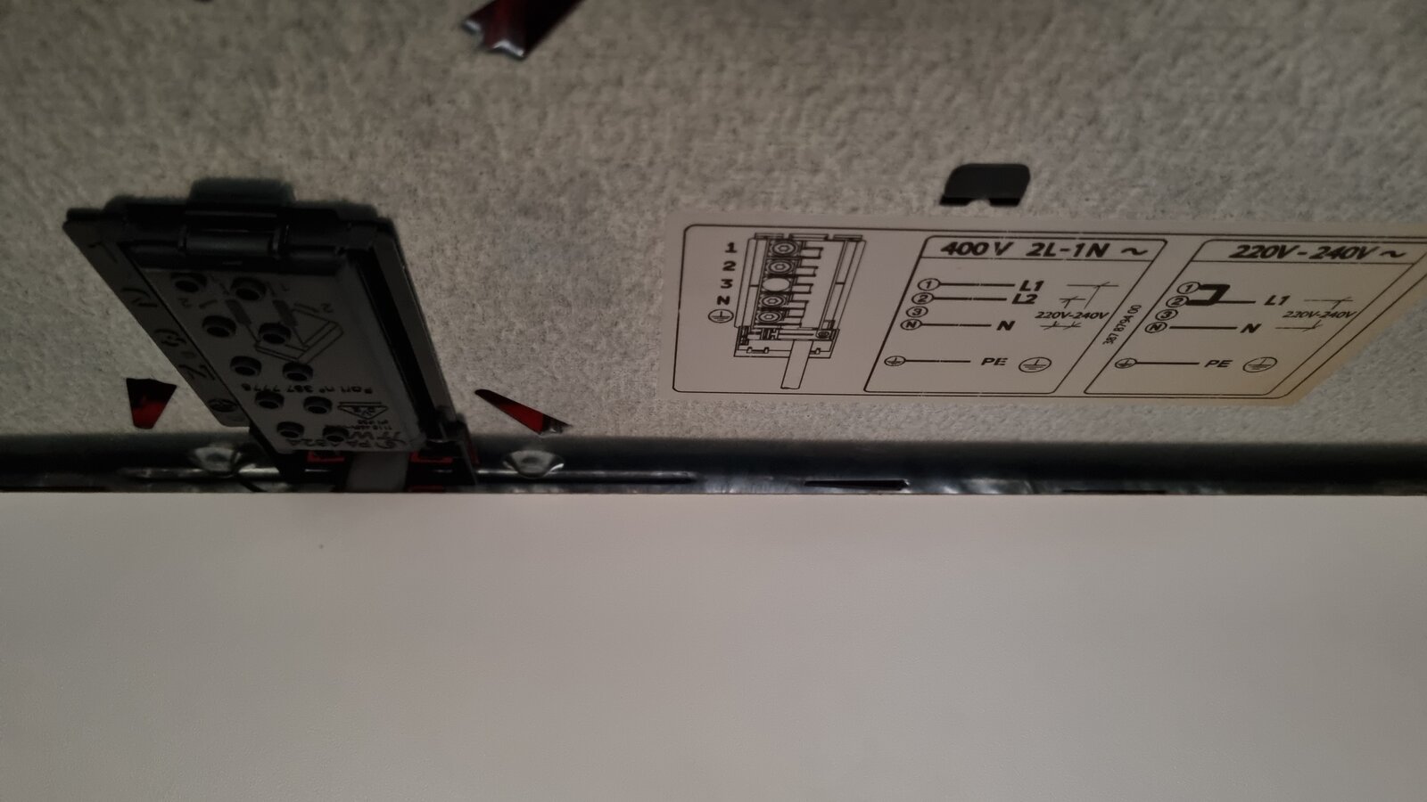

I know this does not sound helpful, but even as an electrician, I have to read the instructions. There are a myriad of methods to configure an induction hob so the same hob and be used with 13 amp supply 32 amp single phase and 400 volts, three-phase, and 460 volts split phase.
I can see the hob seems to be designed for the French split phase supply, and well as the British single phase, but to advise without reading the instructions would be wrong.
Someone must have been able to fit the old hob. By taking it out there is likely to be a cable that could connect to the new one. You don't have to use the new plug, and in fact it may be better not to.
As for the new hob:
Well, you could remove the flex and attach the existing supply cable to the new one, or
you will have to somehow access the connections, or
buy a different hob; one without a plug.

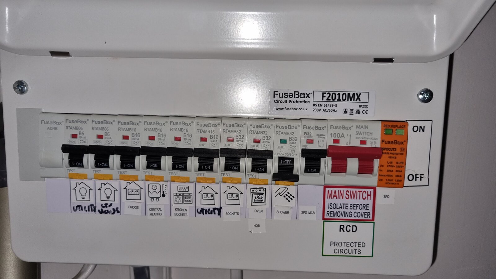

The photo is of the old one wired in and it shares the RCD with the oven. The new hob is a bosch induction hob with a molded plug. Is cutting off the plug and wire it in an option?
