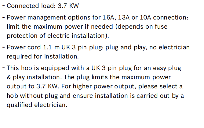

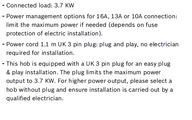

I see the model is PUE611BB5B
This part of the installation manual states this:
Therefore, to comply with the MI's you need a qualified electrician to connect it with anything other than the supplied 13A plug.
And, it seems, some adjustment of the hob's power management settings.

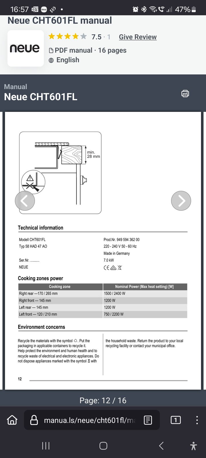

The old ceramic hob has these power outputs (attached)
