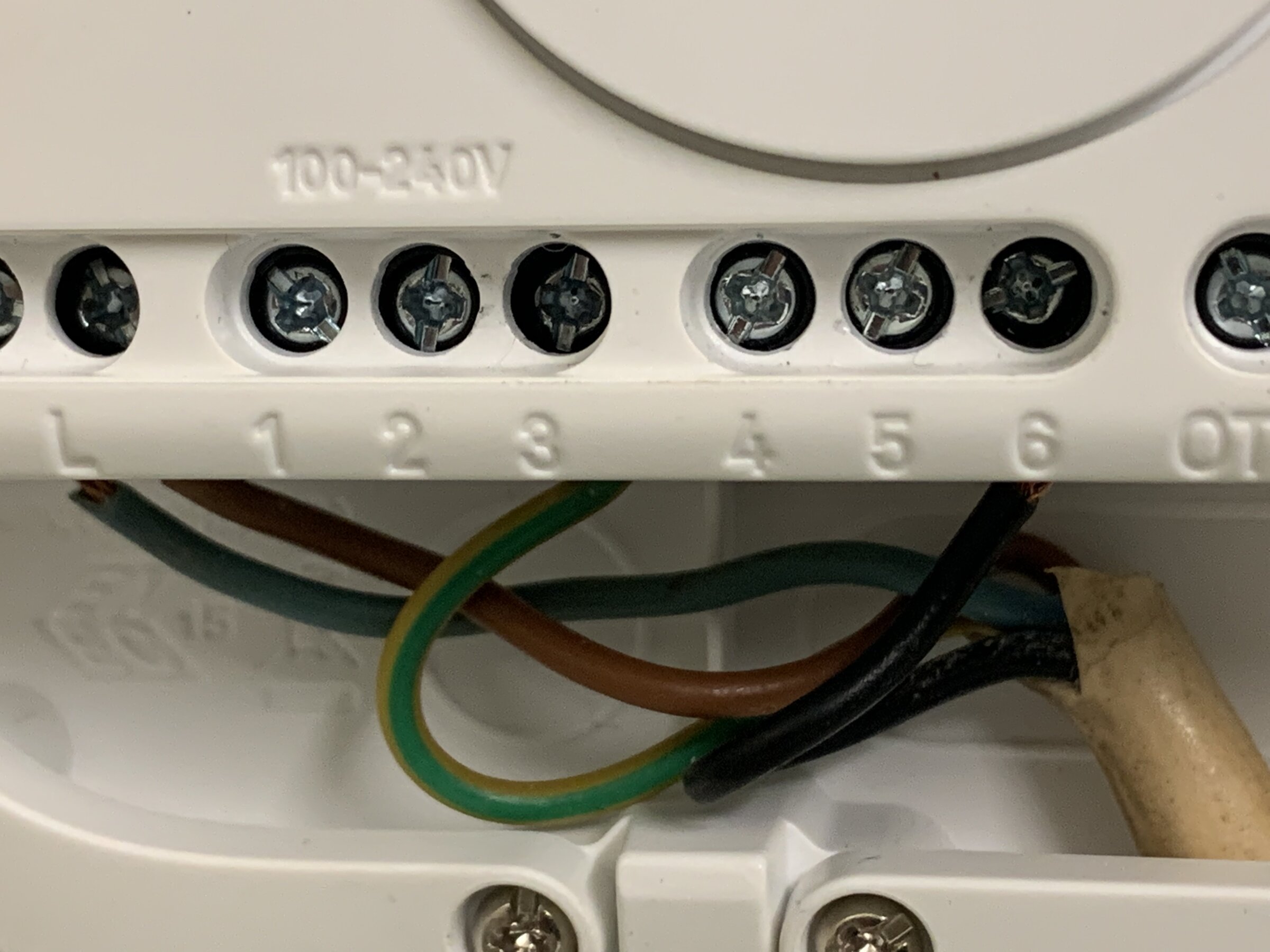

UPDATE: Now resolved this myself, thanks to earlier post by Muggles. I just forgot to put the additional live connections to T2 and T5. Silly mistake on my part but all working fine now.

Following another thread on here I attempted to wire up the Heat Link as in the photo below. It powered up fine and connected with the Nest Learning Thermostat but won’t actually switch either the heating or hot water on or off. I can hear a click but I assume this must be coming from the Heat Link only.

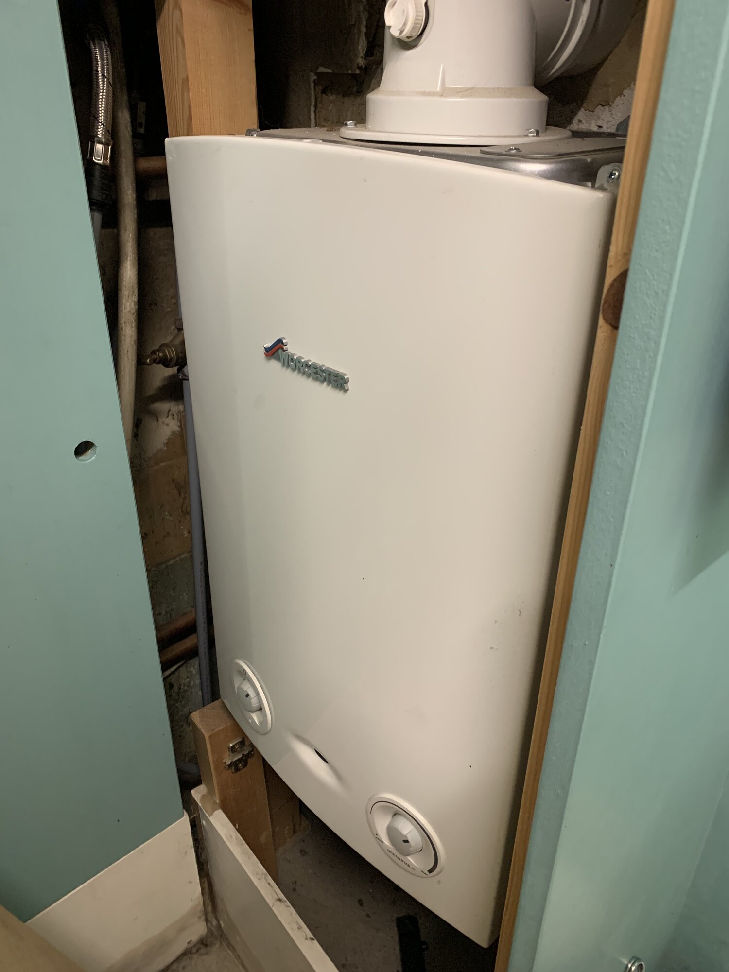

I’m not sure what our boiler set up is. it’s a Worcester Greenstar Ri. It has no pressure gauge and there is a separate hot water cylinder upstairs and a header tank above the main water tank in the attic. The last two pictures show the boiler and its external plumbing.
