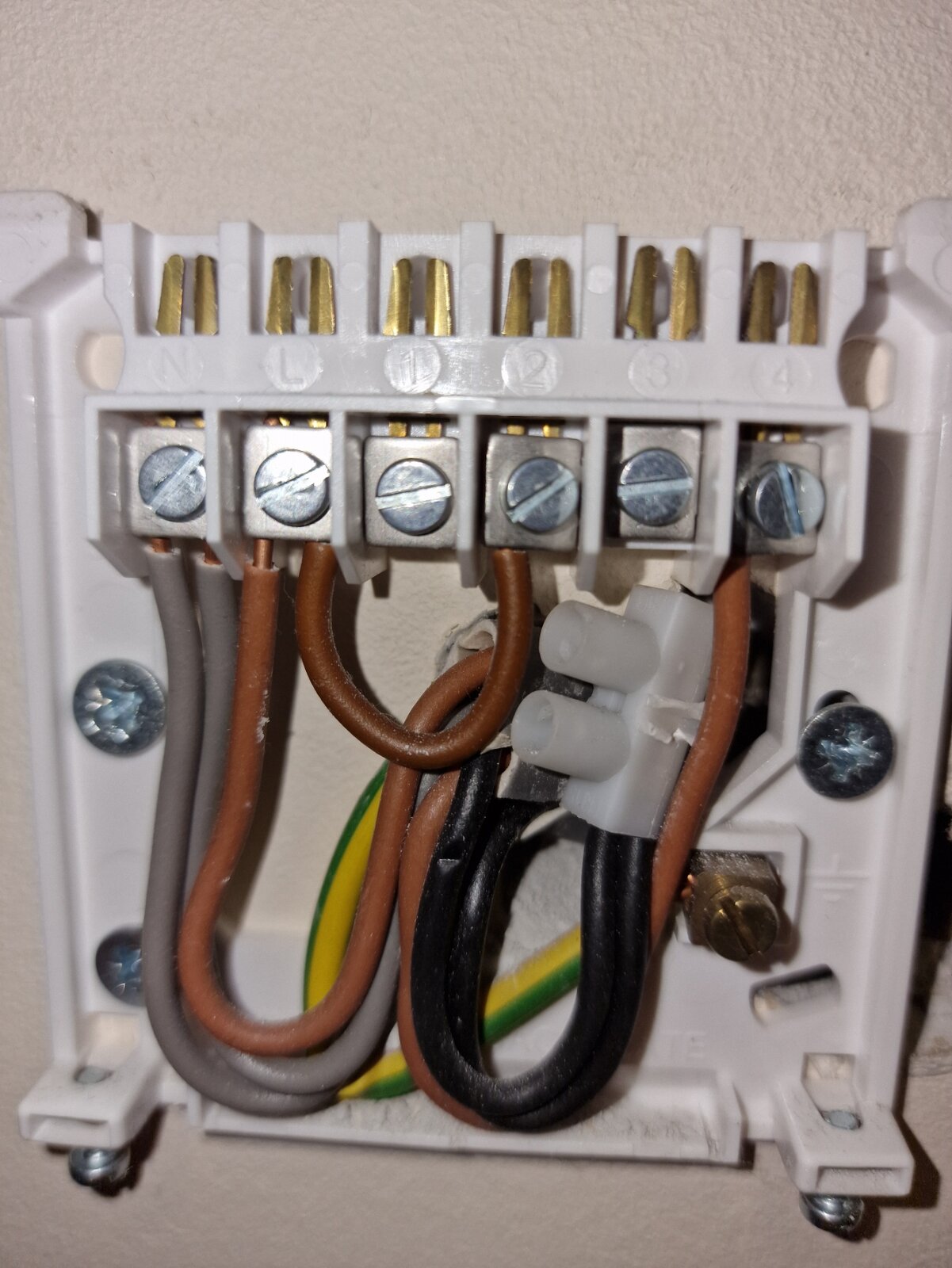

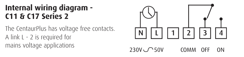

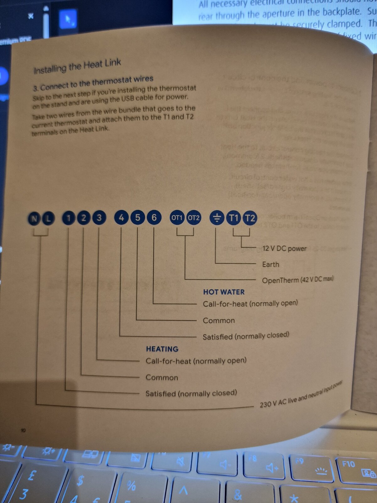

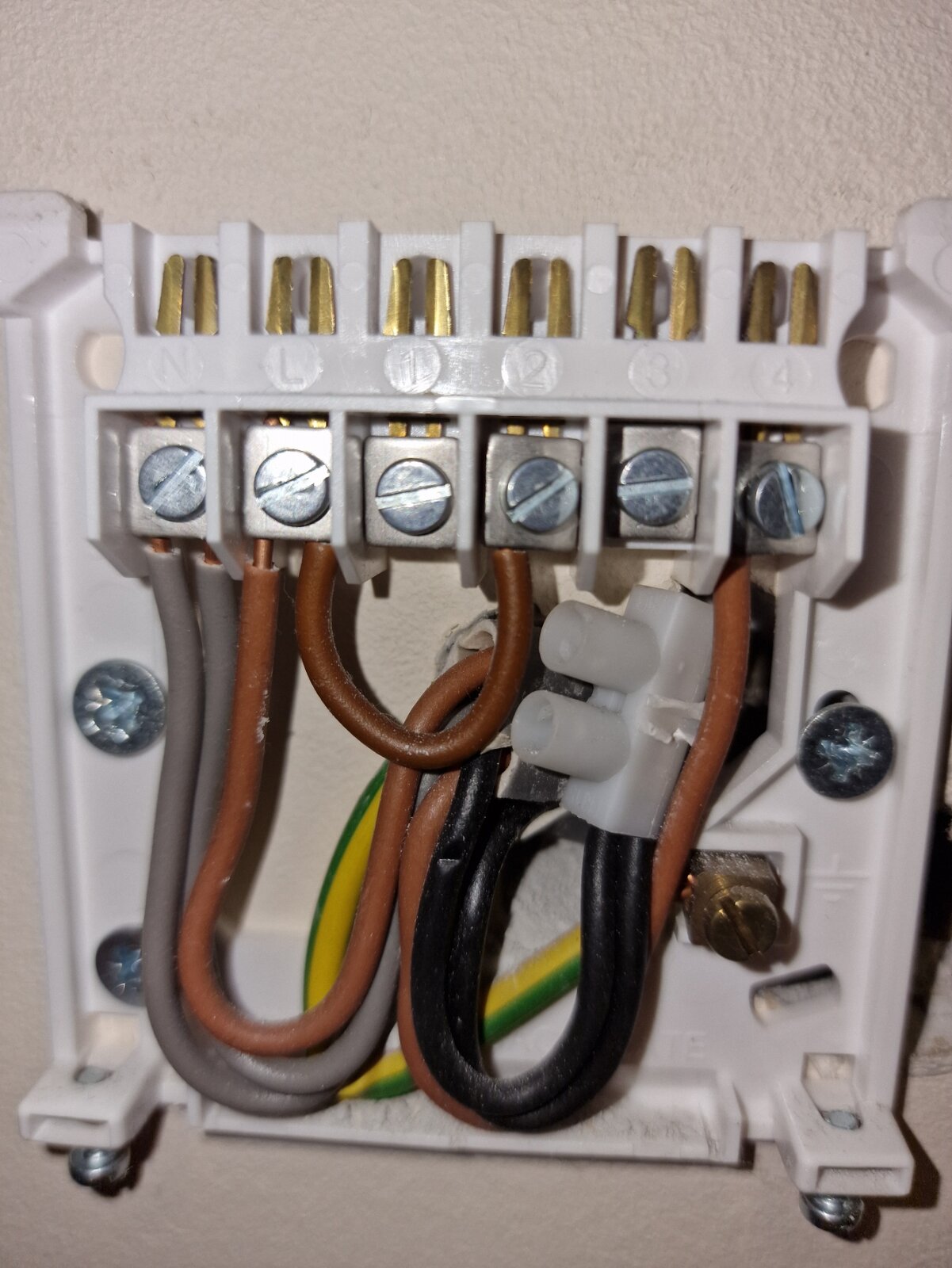

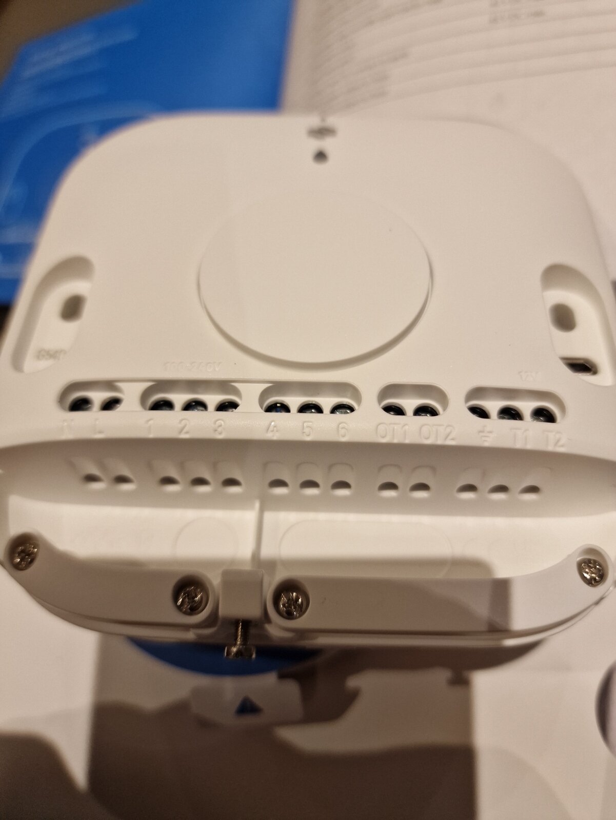

Hello,
I've currently got an air to water heat pump being controlled via a Centaurplus c17 series 2 with Honeywell thermostats in every room.
I'm looking to replace the Centaurplus with a Google Nest Learning Thermostat 3rd Generation.
I'll attach photos of internal wiring diagrams and what's currently wired
Any help greatly appreciated
Kind Regards

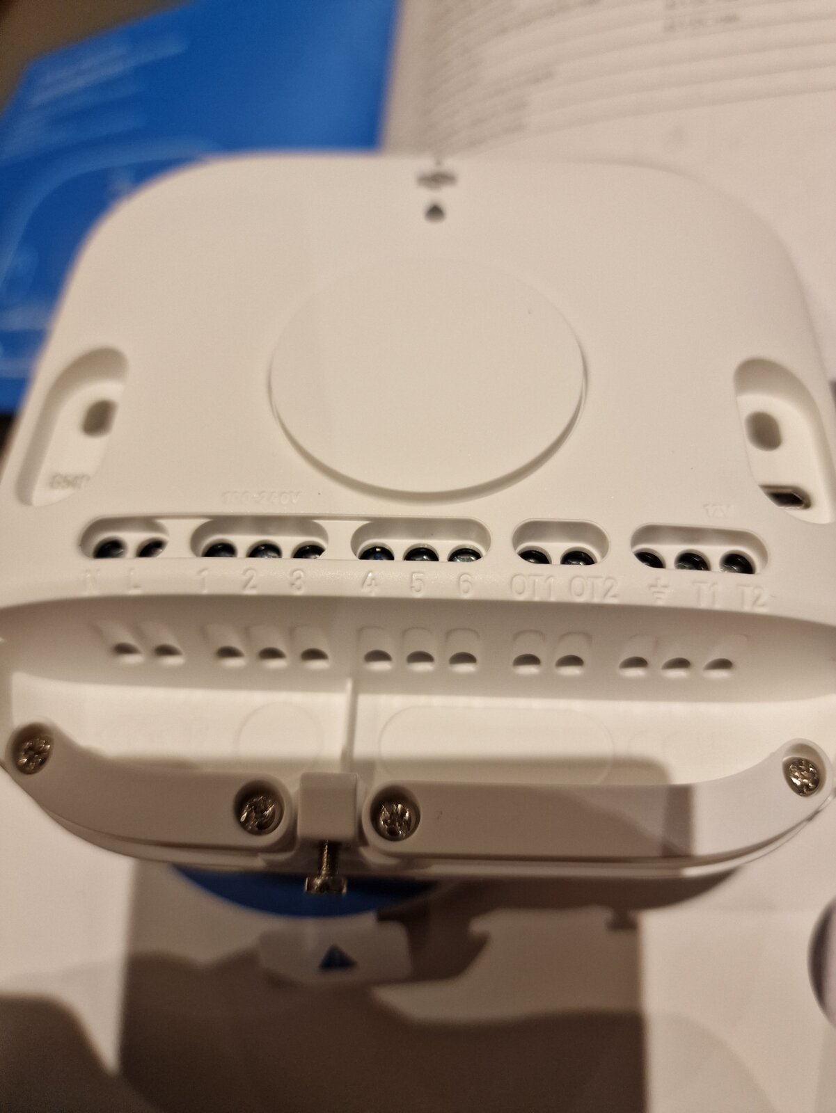

Almost identical wiring - Centaur to Nest heatlink as follows:
N to N
L to L
Link L to 2 (small brown wire)
4 to 3
When you say Honeywell thermostats in every room, do you mean trv’s?
we have honeywell home 1 channel wired mechanical room thermostats in every room
