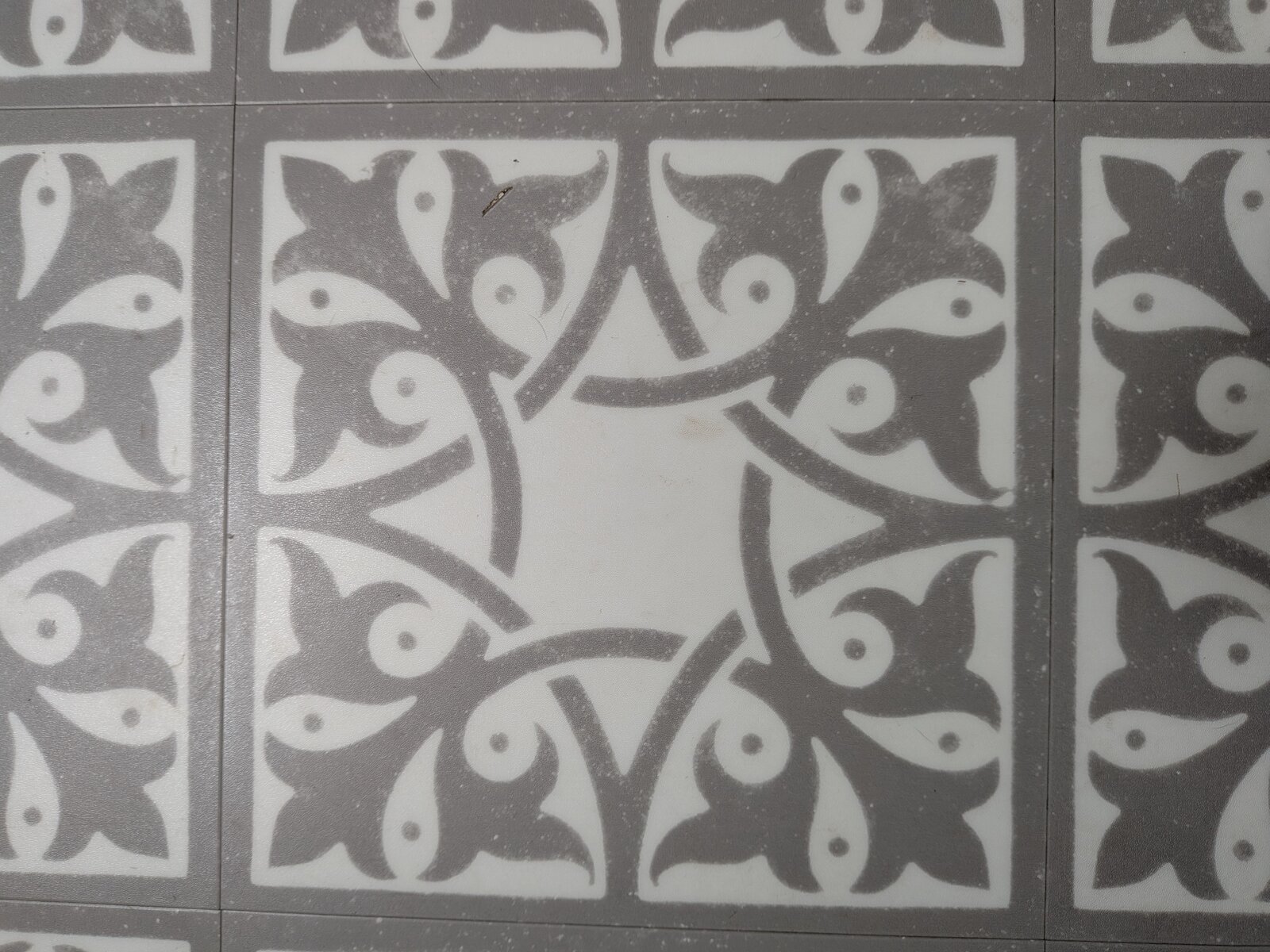

Is there a way I can replace individual LVTs? I have 5 tiles that have small bits of damage like the one in the photo. I've still got a lot of tiles left over from when the floor was laid. The tiles aren't tongue and groove, they're just stuck down. Thanks for any help

Warm them up with a hairdresser the use a knife to get a corner up.
Hopefully the glue strength is less then the screed strength so the scredd stays down.
I used a heat gun to release , most didn’t need any extra adhesive , enough staid on the floor.
I forgot about the screed. I'm starting to wonder if this is a job for a professional
