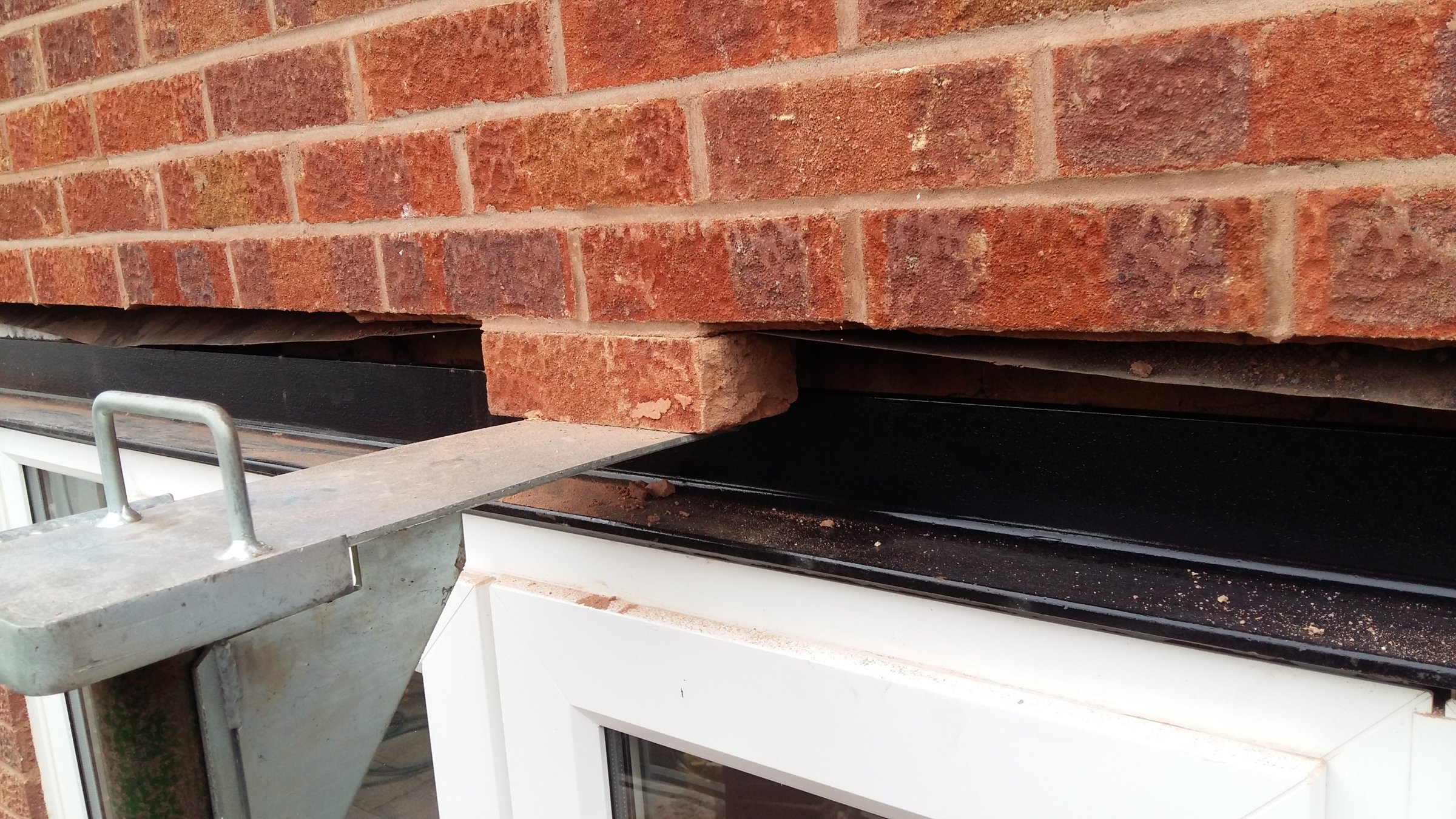

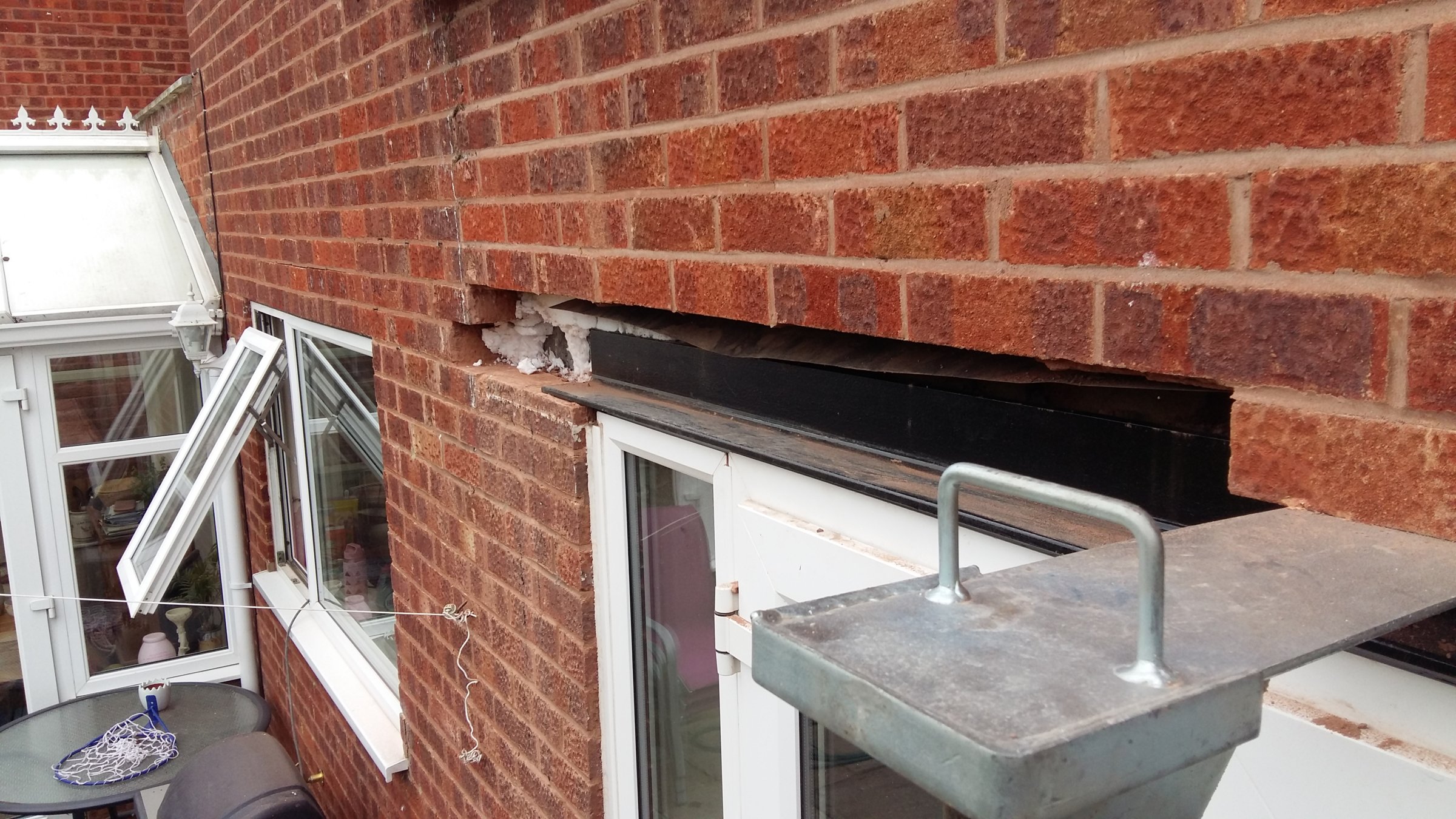

So the conclusion is....f*** it and just go with the angle iron.....?
This cannot be an isolated issue as there must be 1000s of properties without external leaf lintels - I assume they just get an angle iron most of the time too...
Most times, the old window would have been providing the support for the inner and outer leaves, but when they rot and get replaced with thinner Upvc windows, the window installers just stick them in the most convenient position. They're just paid to install windows unfortunately.

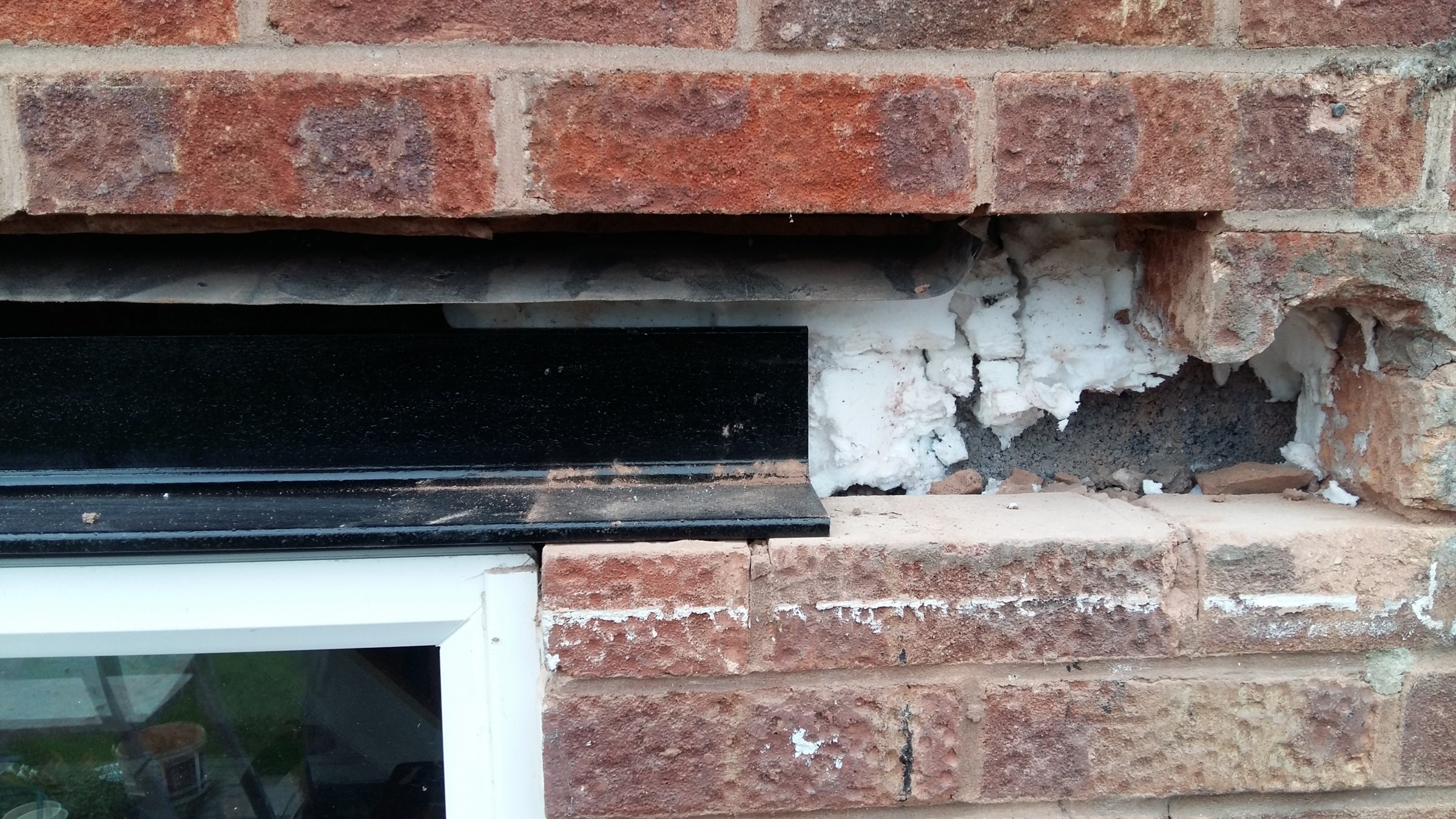

My only further query would be, what is the most appropriate way to deal with the soldier course not lining up with the mortar bed at the top of the normal brickwork. As you can see in the image below. The soldier course ends in the middle of a normal brick.
View media item 99776
PS, The current quoter mentioned they would have to rebuild the dropped brickwork too.
To answer your last question I would sit the lintel on the next course higher than the frame, and get the window fitters to use an add-on to the top of the frame... say 25mm or so.

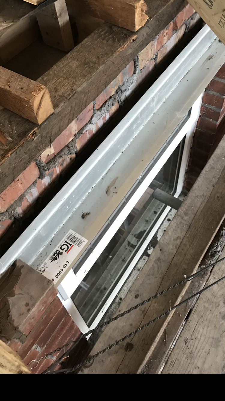

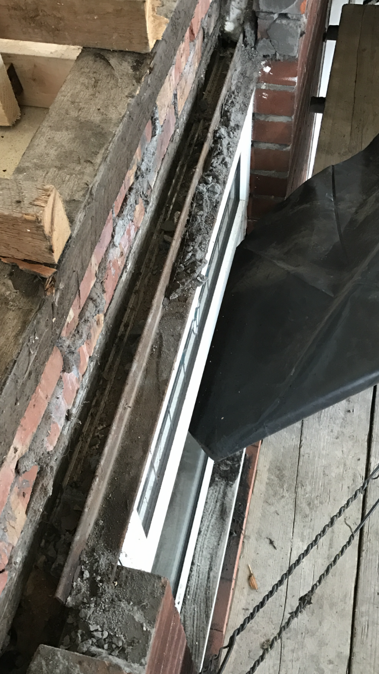

I changed a 70year old one on my house last week. The angle iron was a little over an inch, I have no idea how they managed to balance the bricks on it
Old:
New:
I already noticed your thread, nice work. The angle iron looks a lot thicker too.
Would the angle iron have been 70yo? Or was it installed when the last upvc windows were fitted? I would have assumed the latter.
In fact (before you posted) I paid special attention to what lintel you used over the window....and I was very happy to see you used a proper one..... :)
Is that lintel specifically for just the outer leaf? ( I just checked myself IG L10)
Did you fit a cavity tray into it too?
I'm not sure it's specifically an outer, but definitely for a single leaf.
I didn't fit a cavity tray because the window is so high up. The eaves sheet is directly above it and the facia covers most of the bricks above so I could never imagine any water getting in above it.
