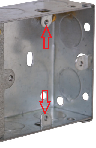

Does the back box have only 2 screw holes to fix the switch into or does it have a couple top and bottom too?
Something like this
that you could use?
If not I'd drill a small hole in the back of the metal box and use a self tapping screw and washer to create an earth terminal.
Thanks for your answers. The box only has screw holes at each side to screw the face plate to so I'll add a screw and washer and connect the earth wire to that.
