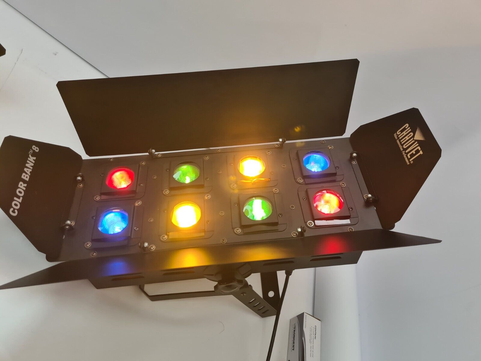

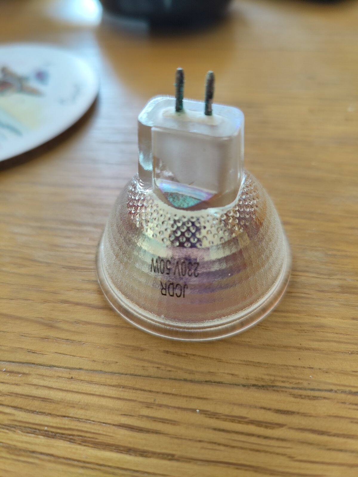

I am refurbishing 2 Chauvet Colour Bank 8 disco lights. These get very hot when in use as they use 8x 240v 50w JCDR Bulbs.
Is there any reason I can't replace them with an LED equivalent? I can't see an LED alternative as most MR16 are 12v. Would I be better changing them to GU10. Could they handle the flashing?

Thanks for your reply. I did however state it is a 240v bulb.
Thanks. I have since seen a video on YouTube where the publisher says he has done this. Do you think LEDs will run in it ok?
I would get an LED (GU10 or whatever) and try it, even if you have to wire it to the back of the existing holder temporarily. The only reason it wouldn’t work is if they are switched with triacs - these are pulsed on and rely on a minimum current to hold them on for the rest of the half-cycle. LED current will likely be too low

A problem you may encounter is the focus of the beams.
The halogen lamp will usually be a very small point source whereas a LED equivalent may be much larger so the lenses won't focus as well for creating beams.

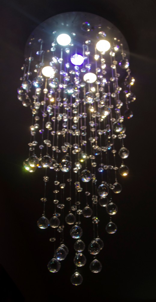

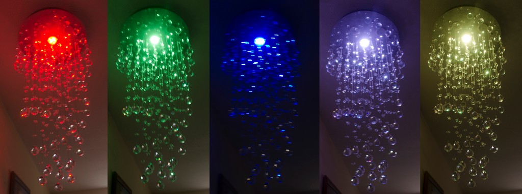

I look at this 1692370945724.jpeg and wonder how your going to get the colours with LED lamps, yes my LED lamp DSC_6799.jpg has the centre lamp colour changing so can get Centre_bulb_colours.jpg varying colours, but to get it to change colours disco style needs it to connect to the phones microphone. Can set it to just change at varying speeds, or to have one set colour, but a colour changing LED is typically around £10 so looking at around £80 to convert to LED.
I see it includes "Includes 8 color gels, (2) x red, (2) x yellow, (2) x blue and (2) x green" so maybe white bulbs will work, but also note "

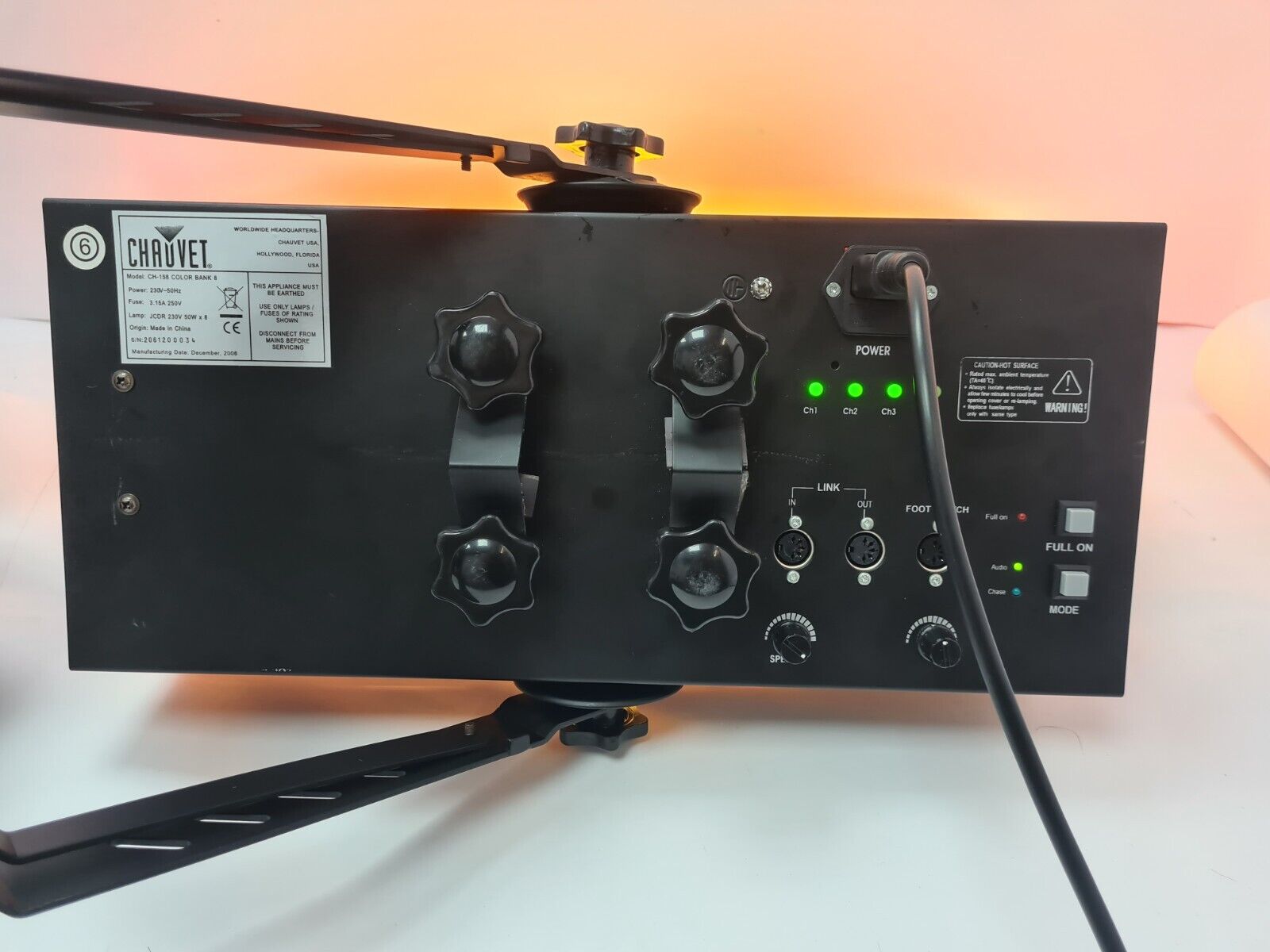

Power: Switchable 110V/230V • Bulb: 8 x JCDR 50W 120V so question is how is yours configured? Reading the bulb it does say 230 volt 50 watt, but it seems likely you will need a full rebuild to change to LED the panel 1692371818702.jpeg seems to offer many options, and says
so I would not expect it to work with other than 50 watt lamps.
Good, at least from that picture you don't have to worry about beams, it's just a flood. Would be interested to know how the colors look in the gel as leds don't output a smooth spectrum of light.
Also, how does it switch the lamps to make it chase?
If dimmed i.e Ramps up and down in a fade, the leds may not like having dimmers attached to them.
If it does sound to light it probably has a built in mic to pick up ambient sound.
