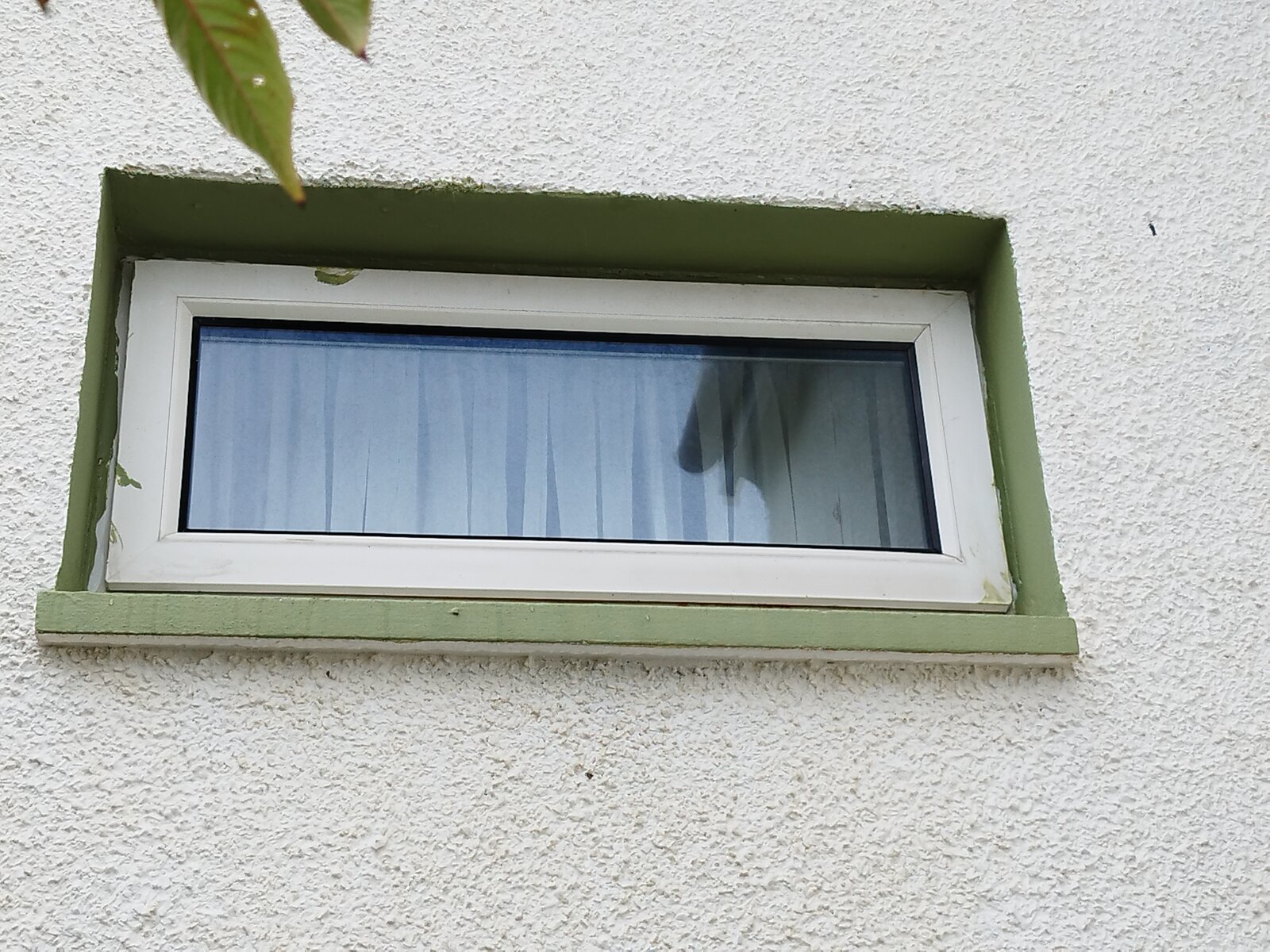

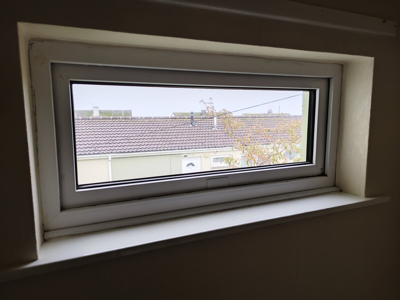

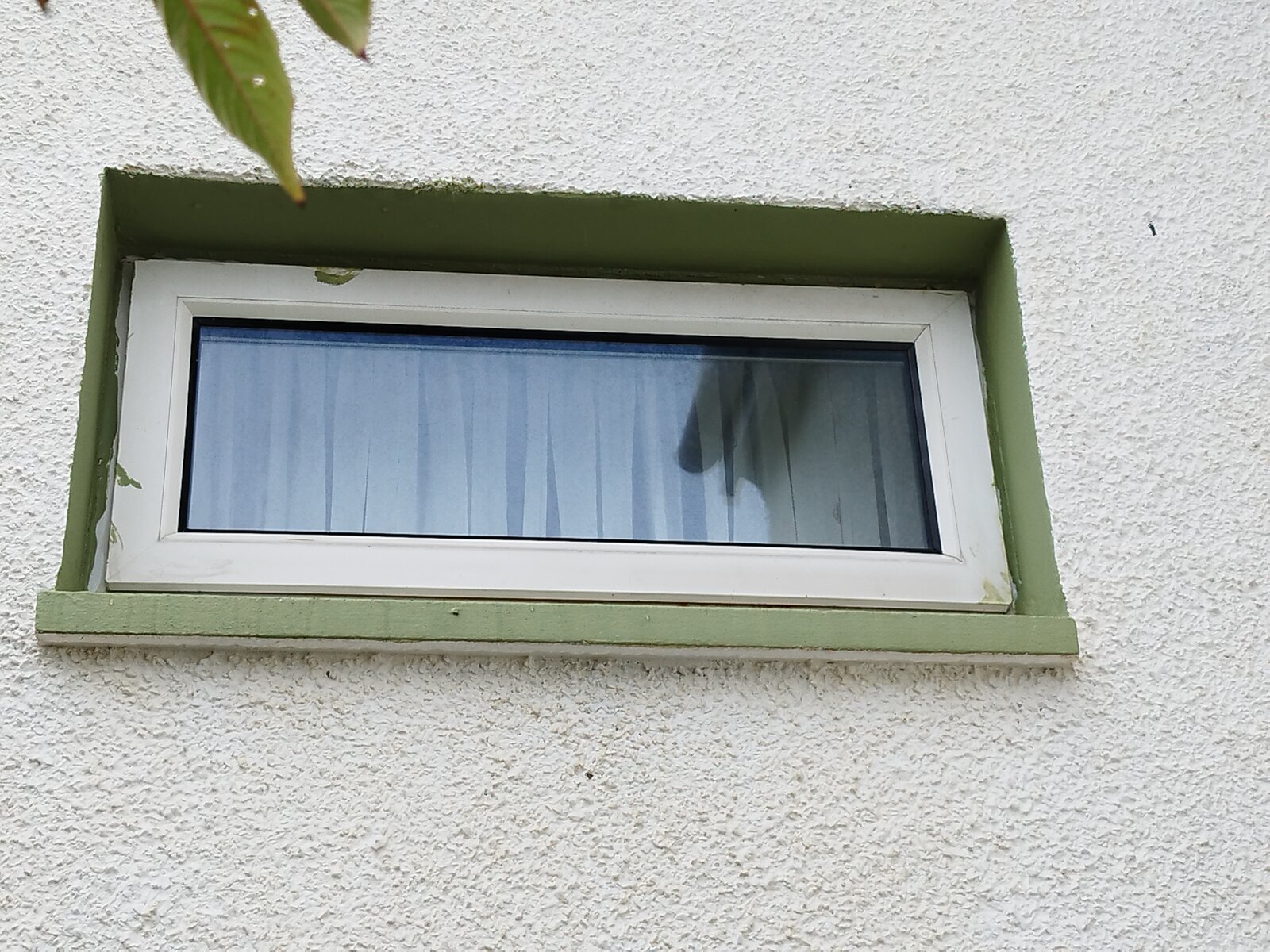

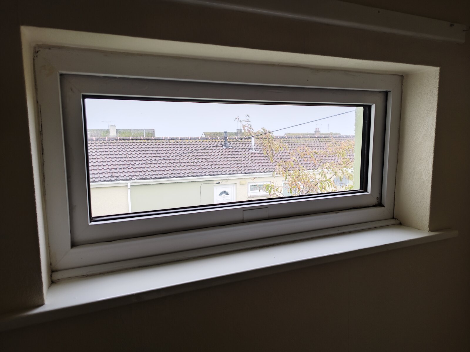

How difficult a job would it be to replace it for diyer? Also would it make much difference to condensation in this area, being able to have a window that you can open? Cheers

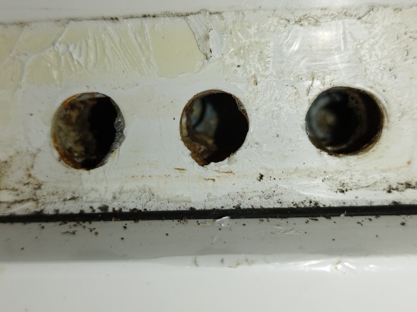

I suspect that might already have some hinges fitted, also take that plate off and you might find 3 holes, 2 are fixing holes for a handle with a centre hole for the spindle, try it
As Crank says.
the window may have an espagnolette lock fitted and just be locked shut - in which case you might just need a handle
given that the window has both frame and sash, it must’ve been fitted with the sash not in it, to screw the frame in place - and a common way of fitting fixed sashes is to hang them on friction stays like an opener then fix them shut.
it might be screwed shut, in which case it will need deglazing to find the screws

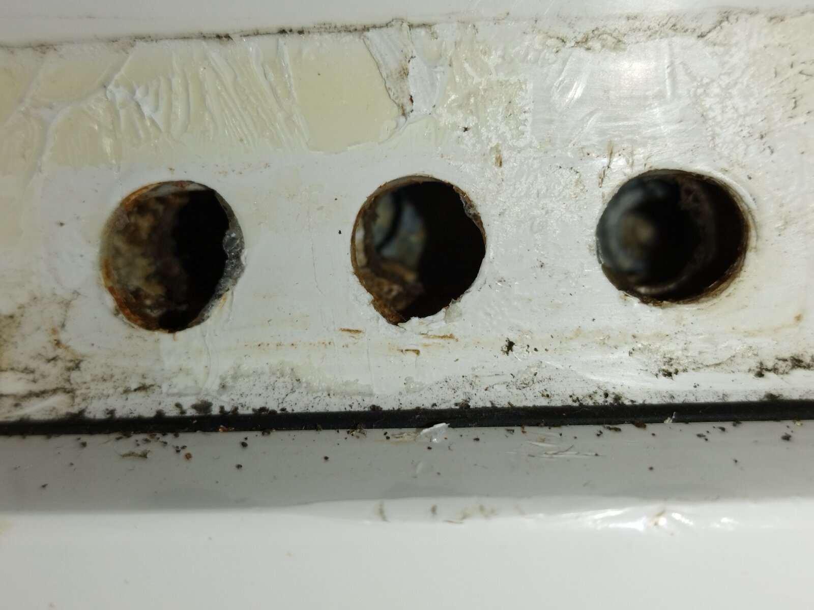

Cheers crank39, your right. Can't see much inside the hole's, what should i be looking for?
Any idea why this was done in the first place?
Theres a mechanism in there by the look of the middle hole, can you see a square drive in there, put in a wide flat bladed screwdriver in there and see if it'll turn one way or the other

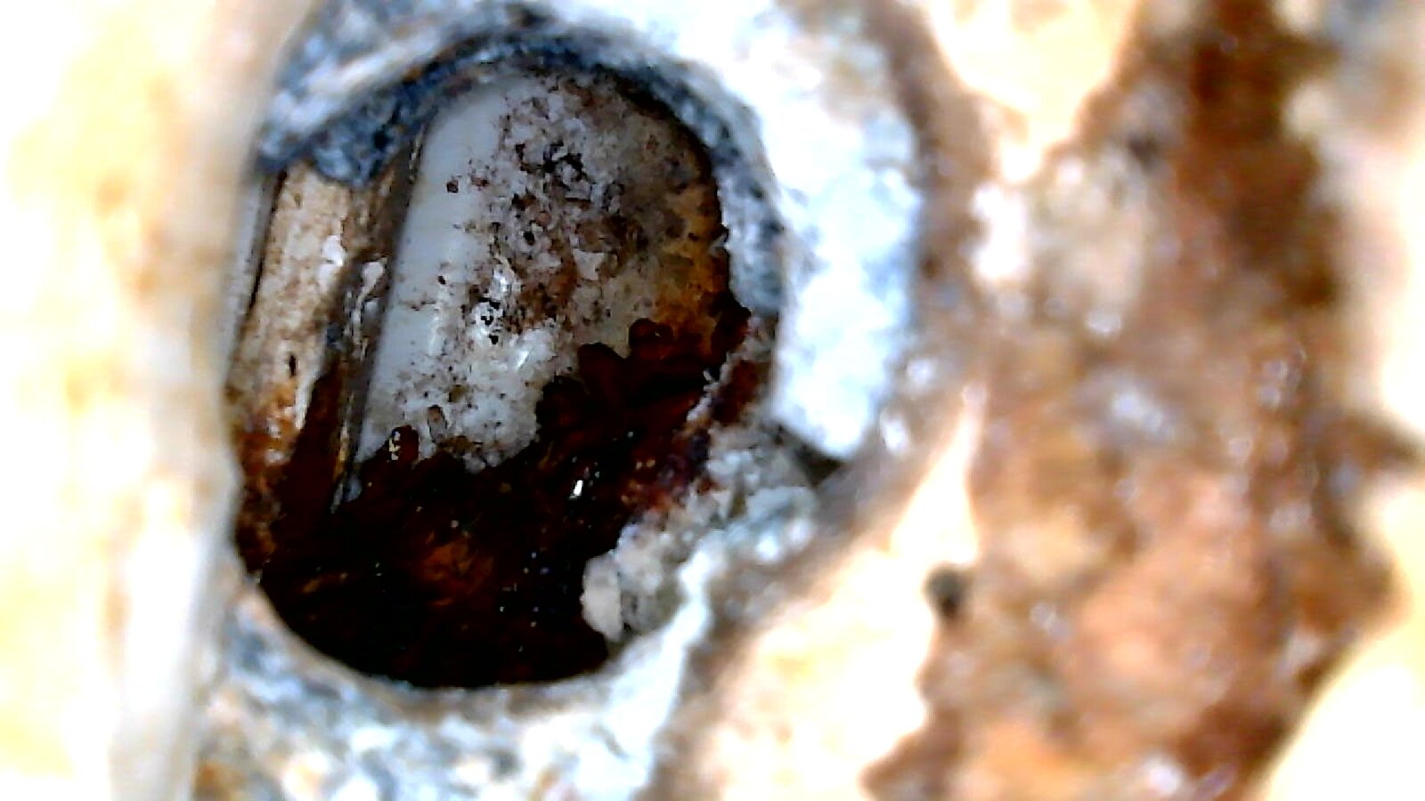

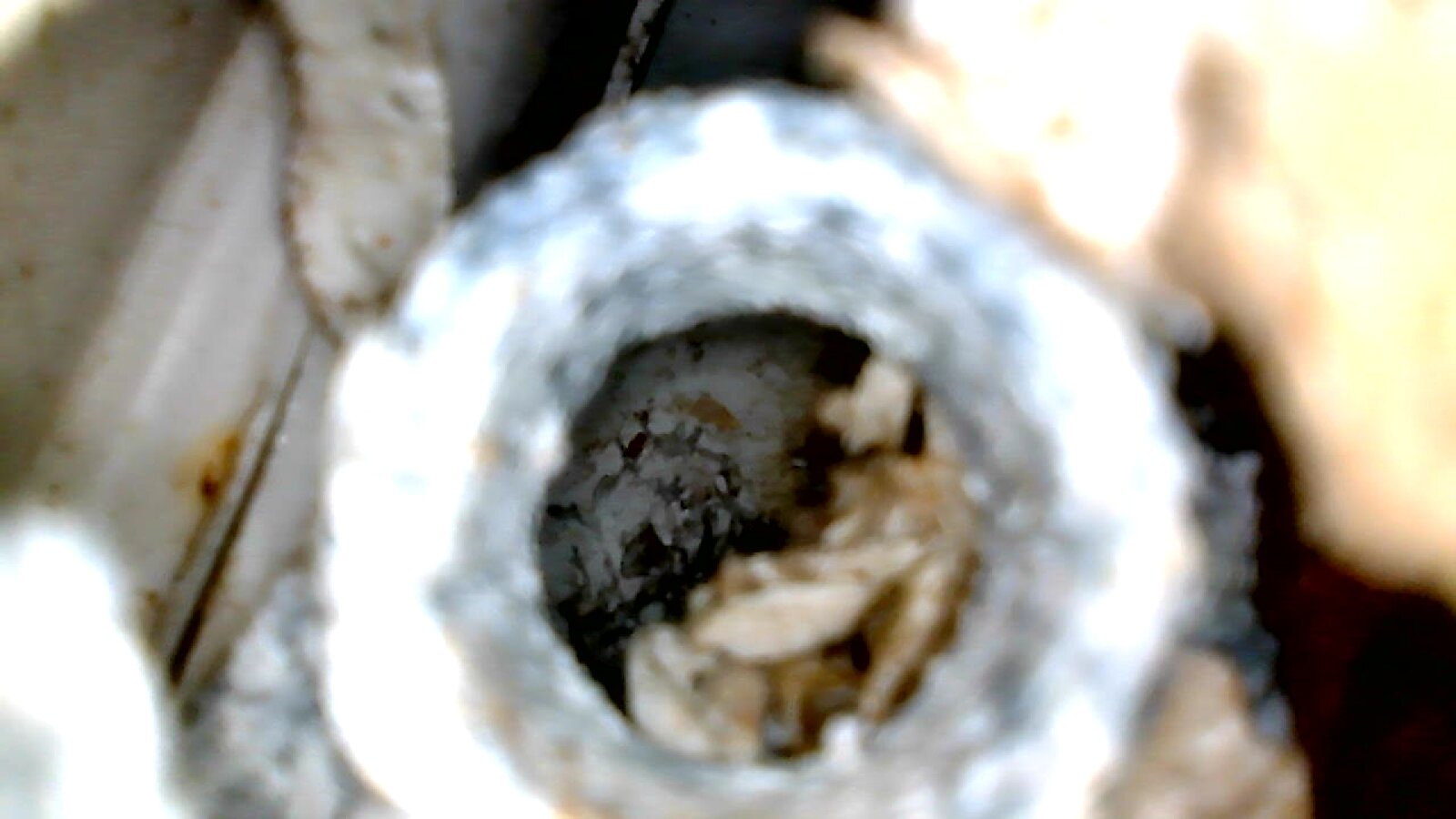

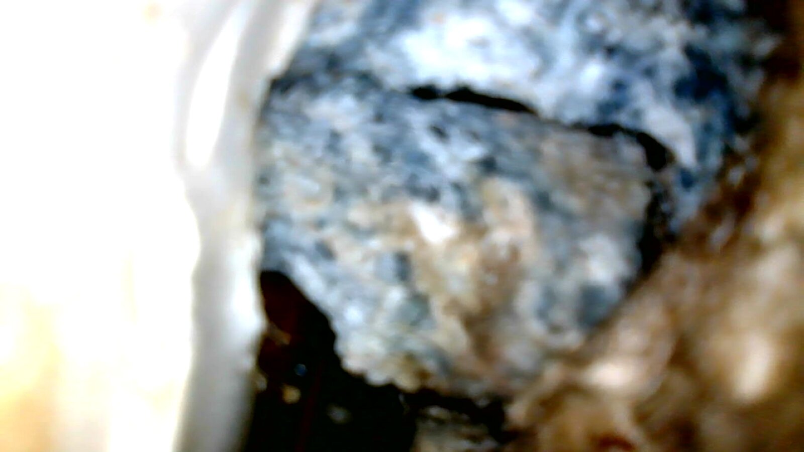

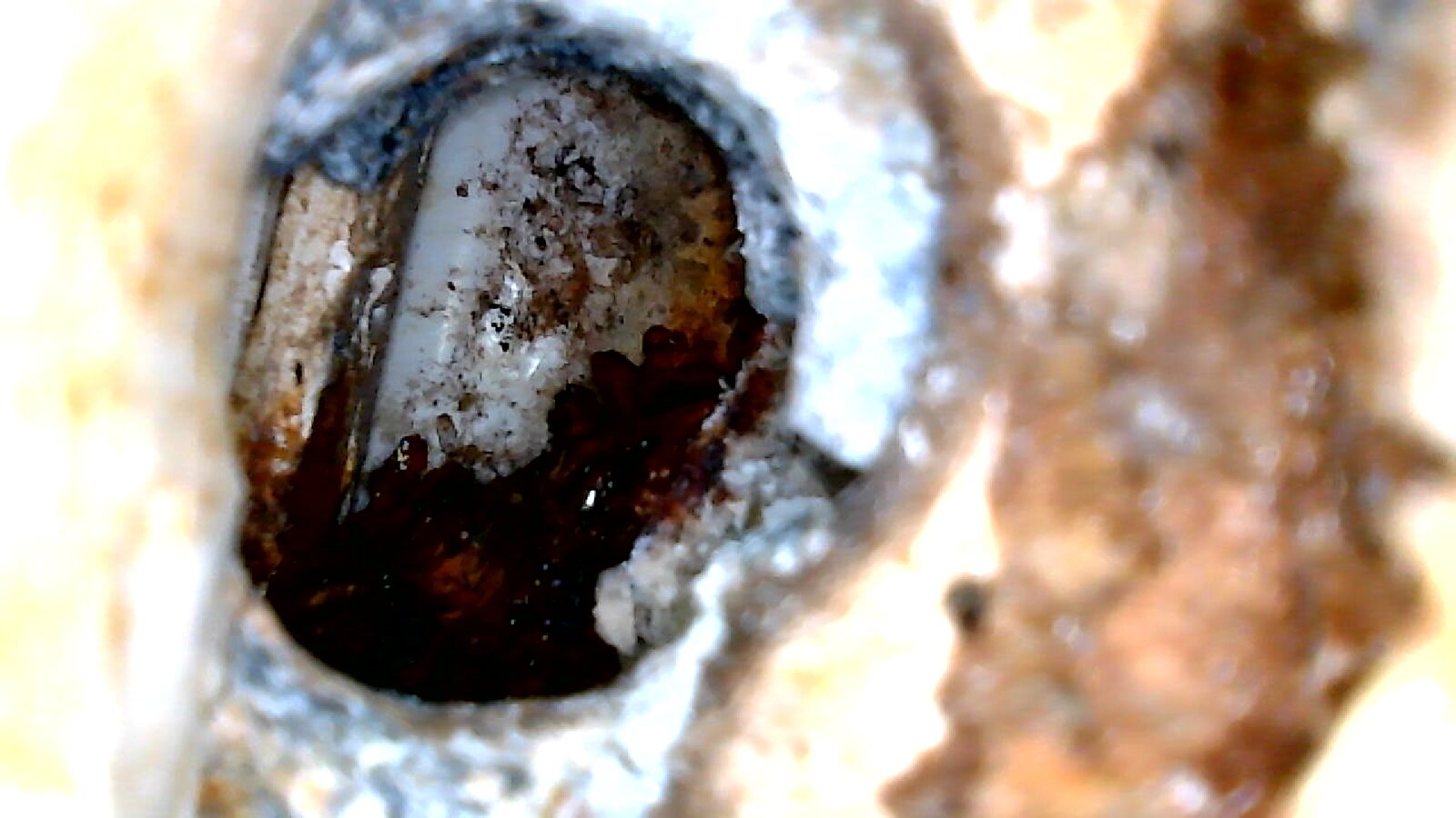

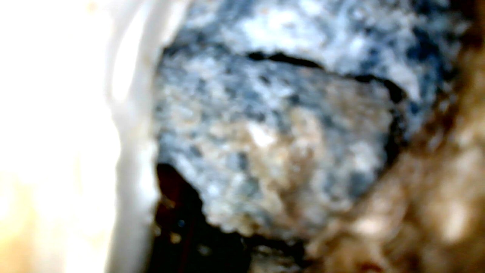

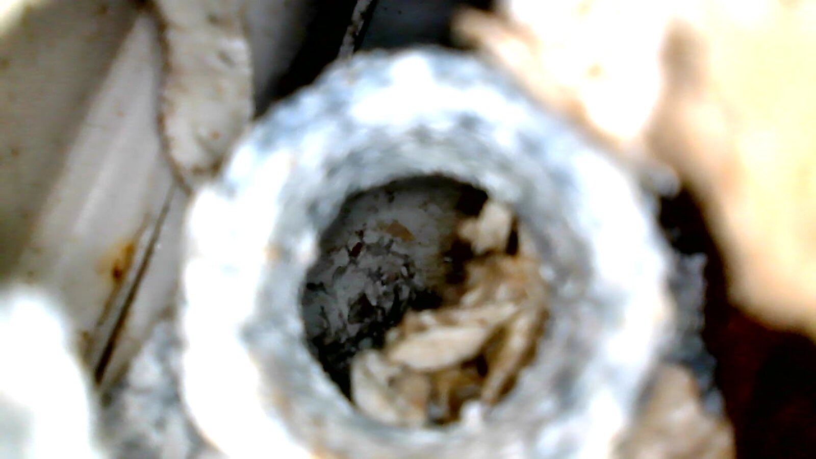

Managed to get photos from inside frame, looks ******ed to me.
That'll explain why is closed... the mech is broken and rather than get it fixed they've just taken the handle off and trimmed over it. Had to say if it's an espagnolette or a shootbolt... either one are openable depending how rusty/seized it is... and hopefully with little damage to the frame
