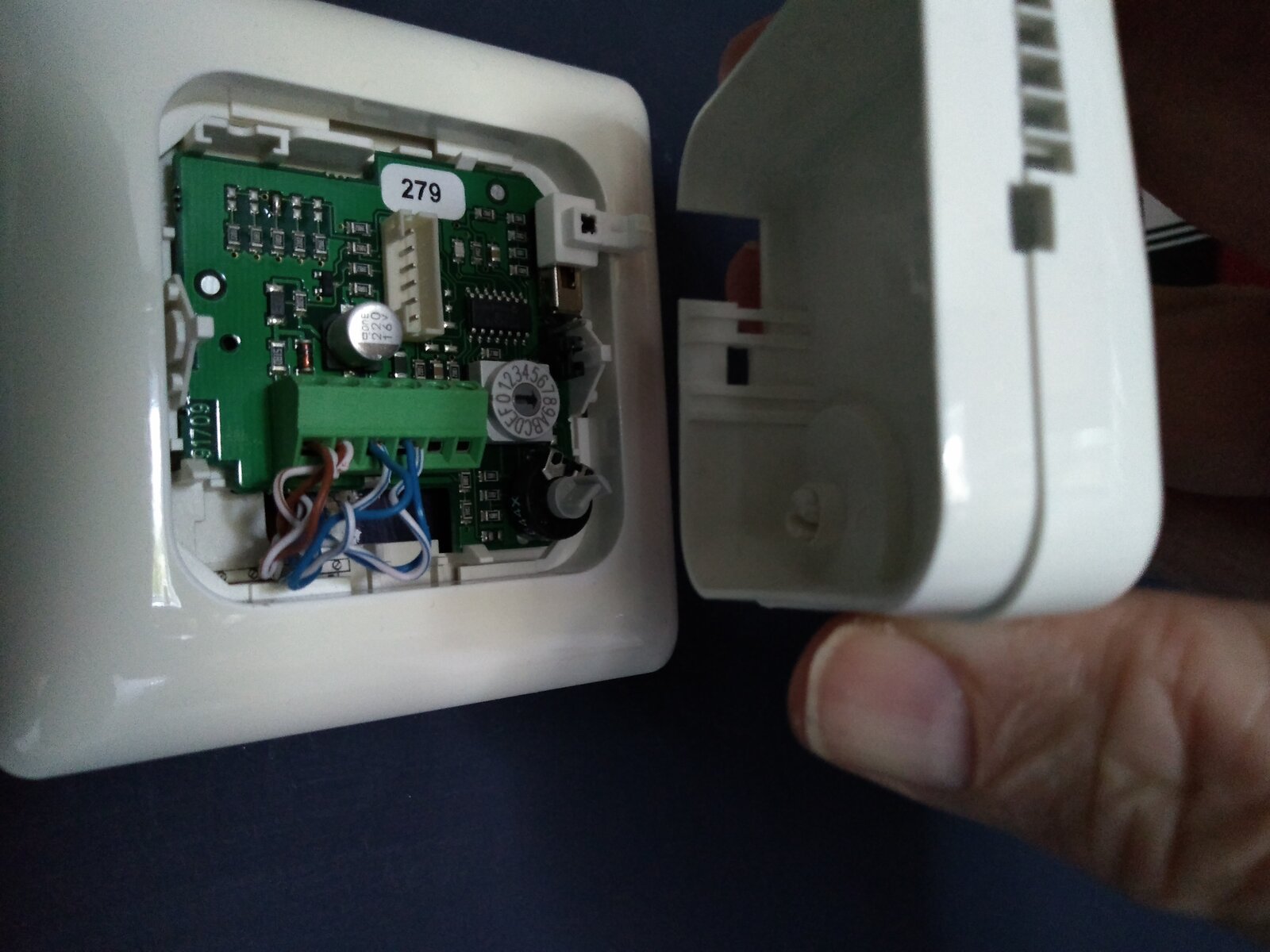

Hello,
We have OJ thermostats and controls. They simply pull out and off their backplate - but they are quite stiff.

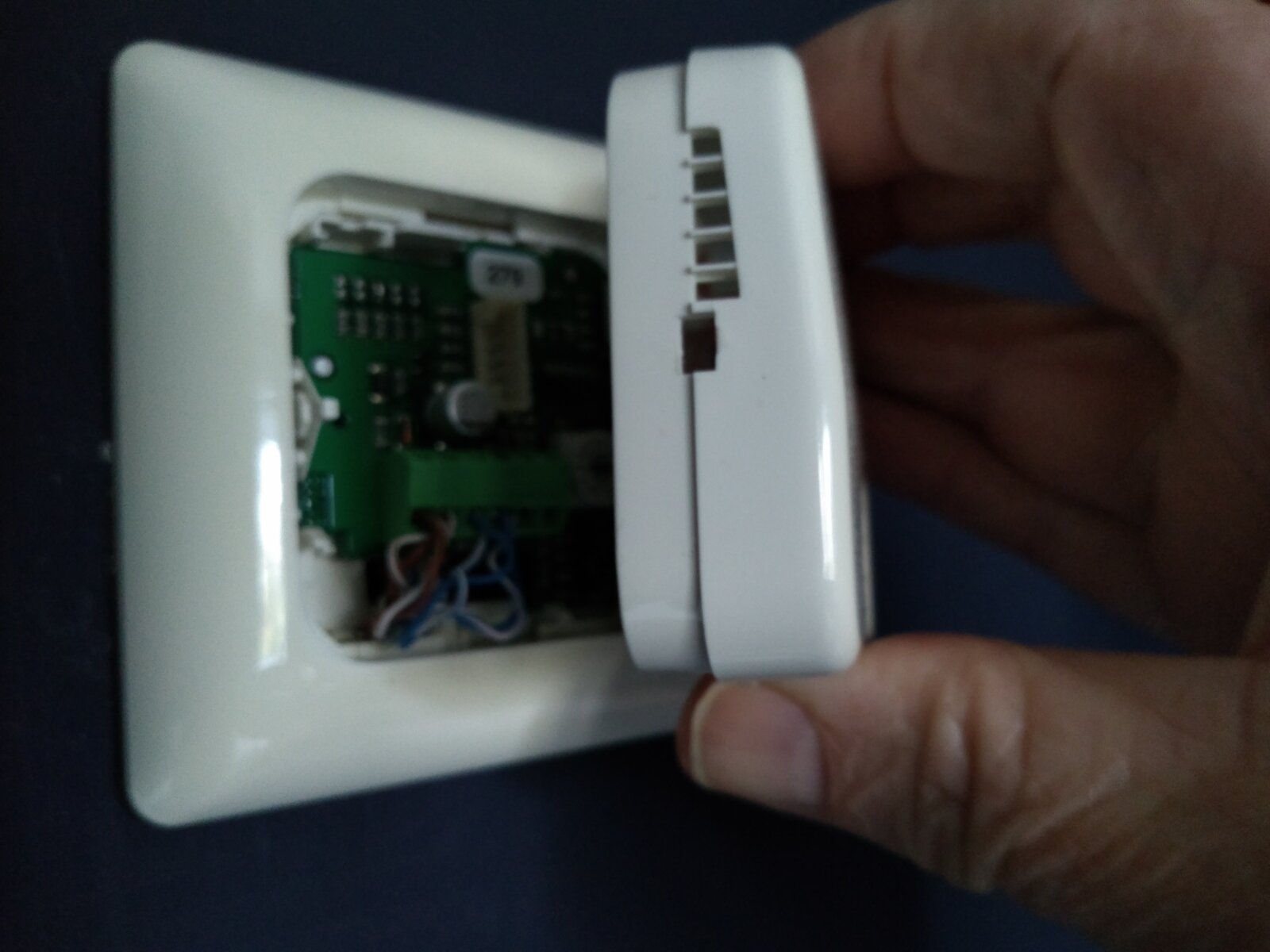

So, to remove the thermostat, I just need to pull the part that sticks out and it will unclip? I still need to find a replacement, but until I remove it I cant see how it is wired.
Our thermostats were made by OJ about 2010 and branded Rehau.
They are a different style to yours but I suspect OJ use the same sort of mounting arrangement.
The middle part simply pulls outwards - it's held in by friction. There is no latch to release or screw, etc.
Of course I can't guarantee yours are the same.....

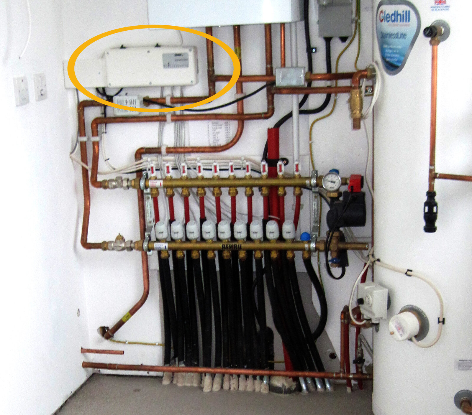

Is your system hydronic (water based) or electric?
Do you also have a master panel somewhere that these sensors link to?
Ours is water based ufh with a manifold with 10 circuits.
The actuators on the manifold are wired to an OJ control box - circled in the photo.

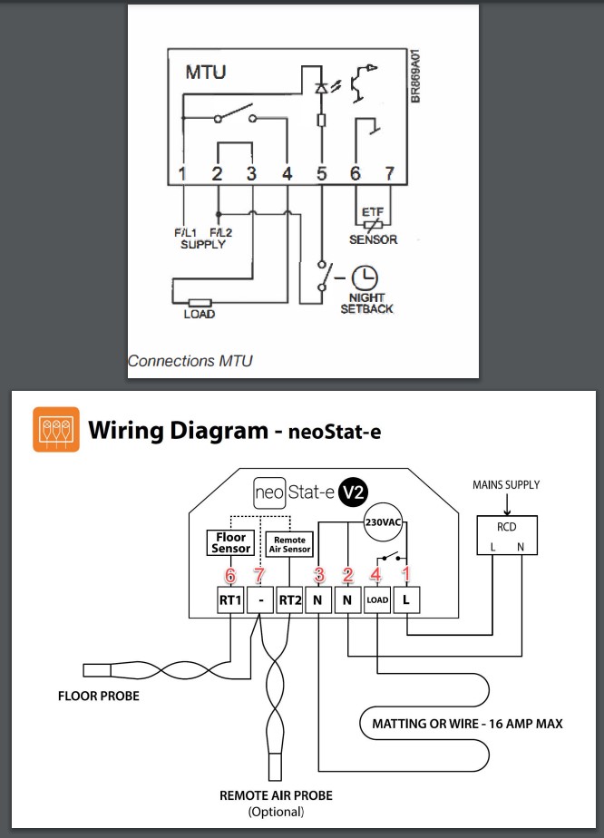

Could someone on here help with the wiring as per the attached document. Have I got the wiring to match correctly from the old thermostat top (MTU) to the new one at the bottom.
Also, does the polarity matter on the heating wire and floor sensor?
The diagram you posted shows the correct connections. The numbers in red on the neoState-e correspond to the MTU terminal numbers.
So:
1=Live
2/3=Neutral
4=Live Load
6/7 Floor Sensor
The heating element and floor sensor [ETF='ElectroThermal Feedback' which is generated from a resistor that provides a temperature dependant resistance value] are purely resistive, so normally no polarity, but if you keep them as they are (i.e. in the same terminal numbers) it won't be an issue if they're not.
