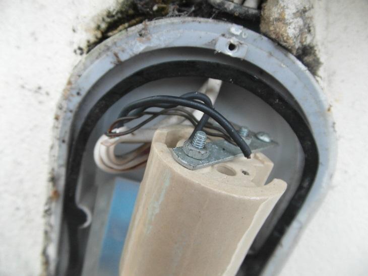

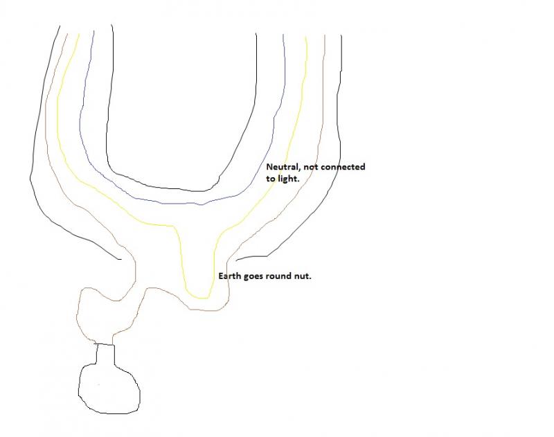

I need some guidance on wiring in a light. I have an old bulkhead light which doesn't work, the wires aren't safe and needs replacing. It is connected to a 3 gang switch which also operate my kitchen lights. I have drawn a diagram with all the information I have and added some photos.
The problem I have is the new light has connections for Live, Neutral and Earth. The old light has a wire coming in, which has L,N and E, the Live goes into one connection then out another, the earth is wrapped around a nut and the neutral isn't touched.
Anyone know how I wire this up? Is it simply a case of putting the 2 lives together in the new light, and the neutrals and Earth?

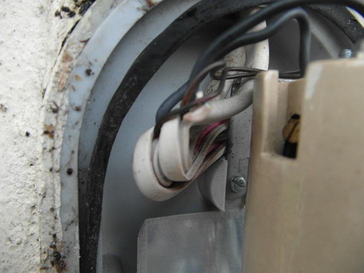

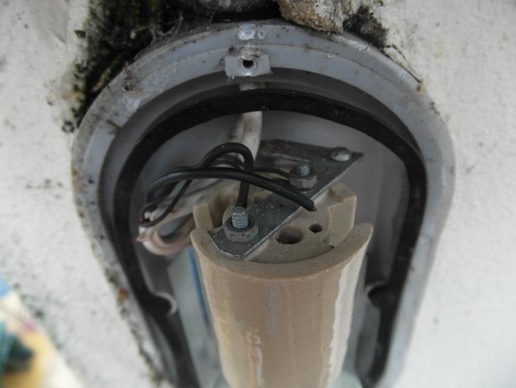

I think the poor pictures show a black a drift from the bulb holder.
And hence why it doesn't work
The wire is adrift, if I connect it then the light works.
The new light does have a PIR.

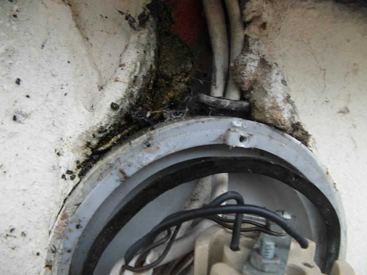

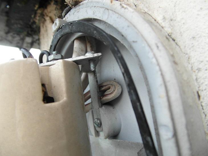

I can try and get better photos, but this thing is old and likely to fall off. At least it is relatively safe at the moment.
It looks like only the Live wire has been cut, with the light in the middle. The other wires haven't been touched.

One cable comes in from the lighting circuit.
The other cable does to the switch.
Red in, to Red out (live to switch)
after the switch, it comes back on the black 'switched wire' to the lamp holder.
The other black is the neutral and connected to lamp holder also.

All quite easy then. And yes the switch will work as you require.
Turn off the power at the CU
Remove the old light.
Fit new light and route cables in as they are (without cutting).
Connect one black upto L
Connect one black upto N
Put some green/yellow tape over the earth wire if you have some, or if its likely to come into contact with something it shouldn't
