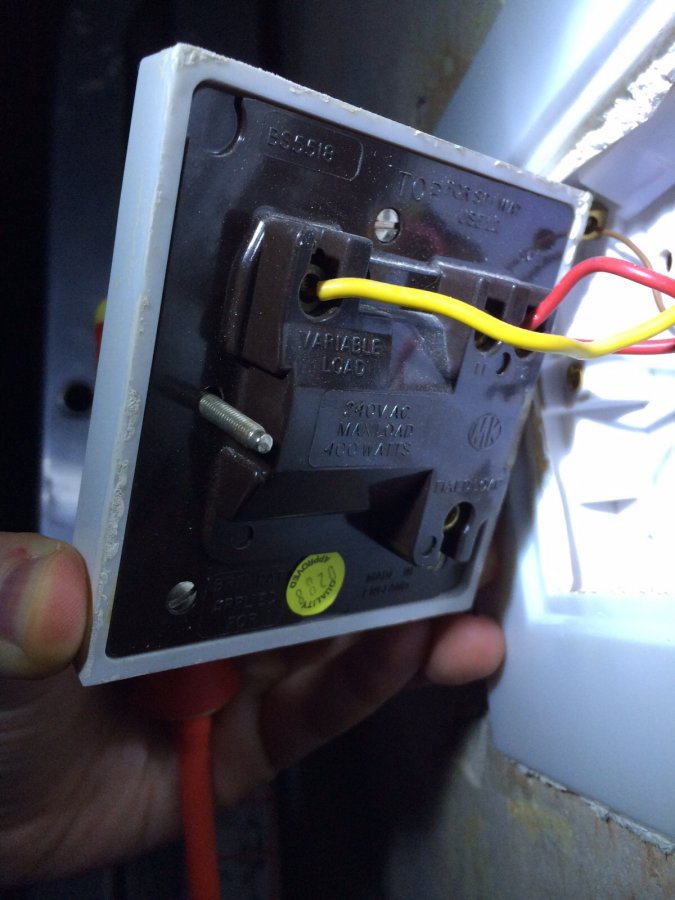

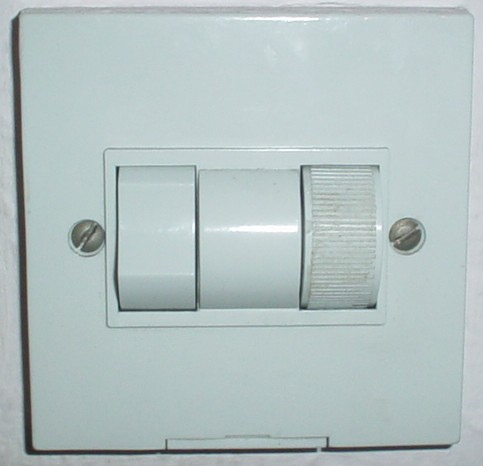

Just moved into a house with an old dimmer switch in it, that requires a BS646 3A fuse to work. The fuse has gone, so was thinking I'd just put in a modern 1G1W switch. The front of the existing dimmer looks like this.
The wiring at the back (this house has the old UK wiring colours) has 2 reds in L1 and a yellow in Variable Load.
I'm thinking that all I need to do is put the two reds in the Common of a new switch and the yellow into the L1. Does this seem right to you experts?
Thanks!
Yes, a straight swop as you have oputlined is all you need.
If you go for a metal fitting, the front plate will need to be earthed.
Hi securespark and PBC_1966. Thanks for the input, that's good to know. I've done some ringing around and found a small independent lighting shop that sells the fuses I need (can't get them in B&Q, apparently). Appreciate the assistance!
