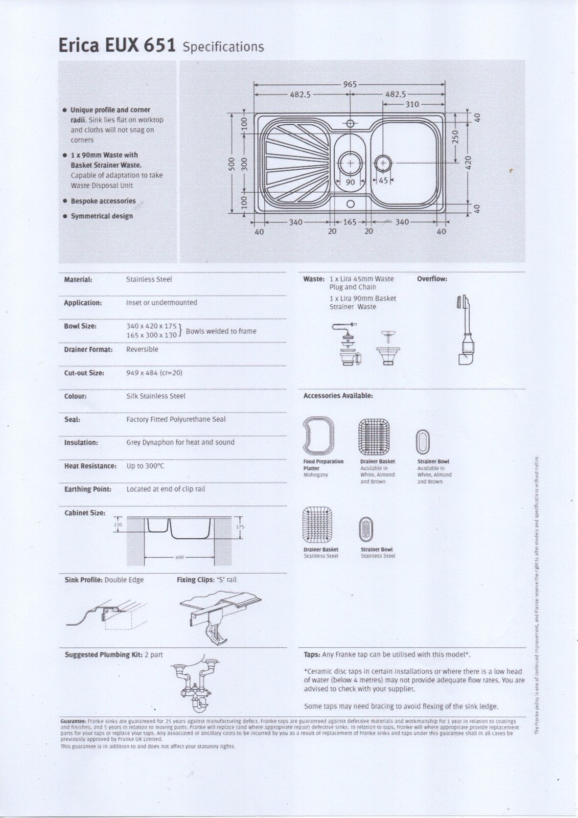

Hiya.
We want to replace out old sink Franke Erica that is a 1.5 and the size is 965x500 and the hole size is specified at 949x484. I have attached an image
I have strigglued to find one that is a direct replacemant with a 90mm waste (the wife wants a WDU in the main sink) I have found this
https://www.bristan.com/products/Kitchen-Sinks?code=SK INXSQ1.5 SU
I cant seem to find a direct replacemant but this looks close even if the bowl is a bit deeper.
Can anyone suggest anything else please?

Hiya. Thanks. That looks good but i'm sure the boss will moan about the shallow half sink. Any other suggestions?
No need for a Waste Disposer, personally I think they should be banned. Everything apart from food waste should go in the bin, and if your local Council doesn't offer a Food Waste collection, put that in the bin too. The only things going down the drain should be the 3 P's. Pee, Poo and (toilet) Paper.
