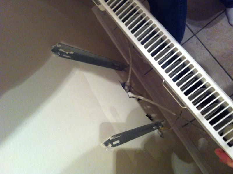

I've decided to replace the radiator in my (smallish) bathroom with a heated towel rail.
I've found guides on the internet on how to install the rail but how would you guys tackle this?
Behind the radiator is one big hole where the pipes come out off. Now would you leave this & just fill the hole, so it doesn't look so bad or drill 2 smaller holes to feed the pipes through?
Also, is it possible to cut the water going to that radiator or do I need to empty the whole system.... if so how?
Any suggestions or ideas would be great

With plastic pipe and push fit fittings you will want to leave the fittings exposed. The rubber seals inside are only guaranteed for about 25 years so you'll want to see when they develop a leak. If it's copper on the other end of them, I'd take out the plastic and do the lot with new holes in copper to leave a tidy job.

If it was me, I would
Drain the system
Hang towel rail
Open up plasterboard below
Bring pipes out of the wall in copper off of speed fit elbows
In line with rad valves
Connect up to towel rail
Refill system with some inhibitor
Make good wall below with some new board and paint
Make two 20mm holes in the correct place and put the pipes through them from below where you have opened the wall
Tadah!

So this is what I'm going to do (step by step, I like to make sure):
1. Empty the system.
Q:
I have a sealed combi boiler, so how do I drain it, as there isn't a drain pipe on any of the radiators?
2. Remove radiator & take off the plastic pipe.
Q: Is the plastic pipes connected to copper pipes, if so would I be able to bring these into the bathroom or is it best to connect new copper piping to them?
3. Line up the Rail to drill new holes for the pipes etc...
4. Fill existing holes / paint etc...
5. Fit Rail.
Done?

You would normally have a drain cock under a radiator/ by the boiler at the bottom / sometimes on a pipe run from upstairs at the bottom/ a drain valve on the rad valve/sometimes outside the property.
Failing that you would have to manually drain a rad downstairs and then drain it from a valve or get a self cutting drain cock
