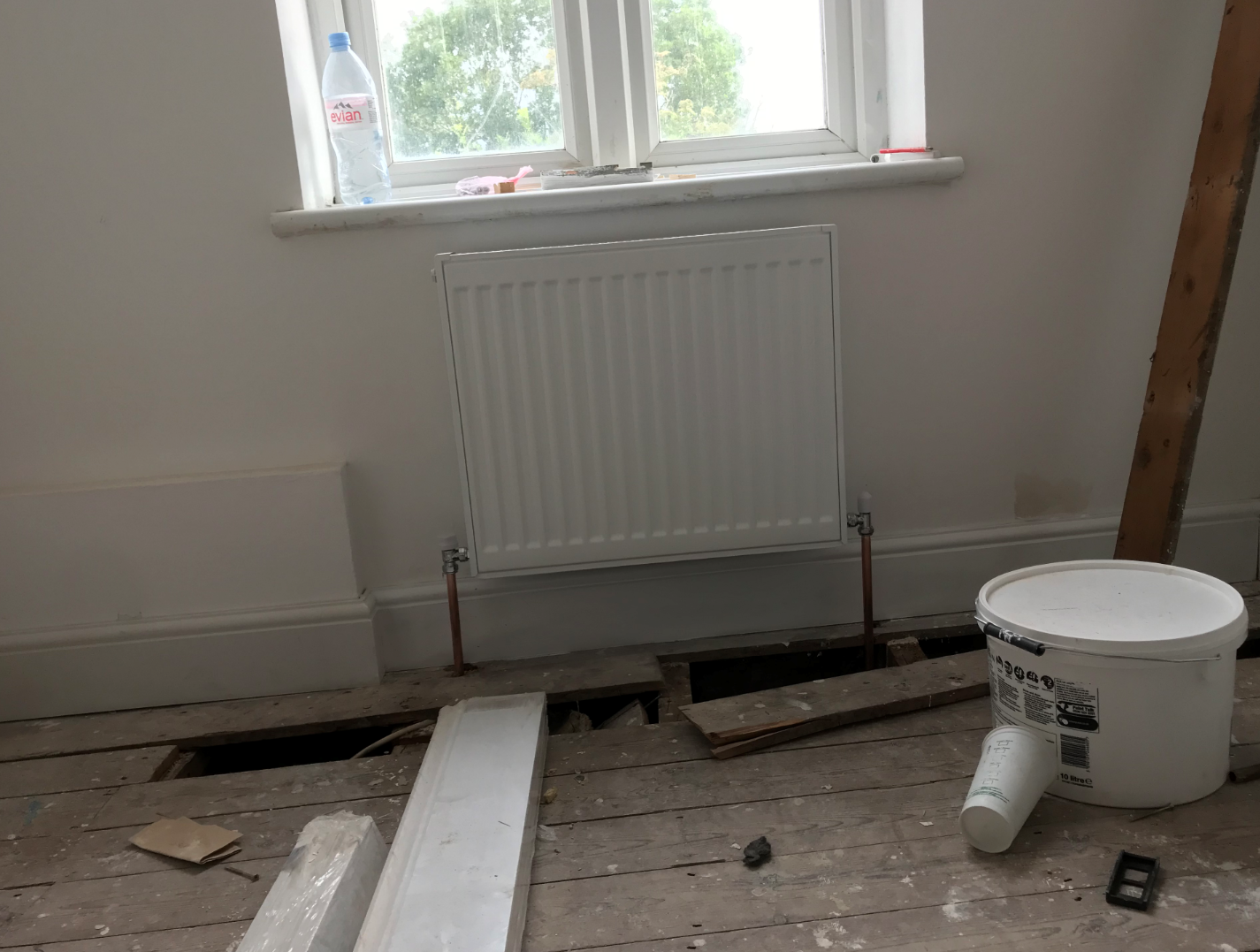

Replacing radiators with same sized rads

Isnt the ops question ...where should the rad sit in relation to the window sill ?

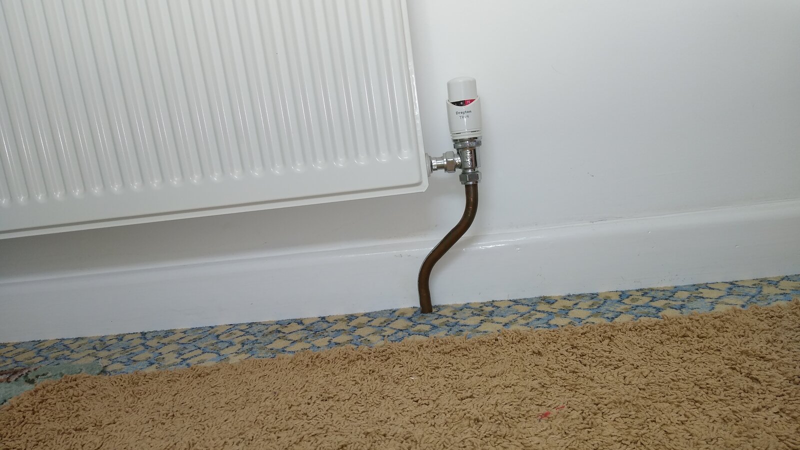

The question was where the radiator should sit between the floor and window sill and I suggested 25mm above the skirting to the bottom of the radiator.
Sills can be all sorts of different heights and I wouldn't normally take them into account.
As skirting sizes range from 70 mm to 350 mm ,I wouldn't take them into consideration in determining the height of the rad ,only the height from the floor to underside of the rad , typically being around 150 mm.
If your completely repiping both pipes and valves, then I usually just measure from the bottom of rad to top of brackets on the radiator (say that’s 21inches) and then measure that size from skirting board up. That will be where top of the bracket will go. So the idea is the rad will be flush with skirting....my old tradesman showed me that first day on the job and it’s always stuck with me (Obviously if you want to see a bit of skirting and easier for wiping skirting etc then go another inch higher)
UPDATE: Based on your very helpful advice, I set this out earlier today. Dry fitted everything, cleaned and fluxed and then calamity struck!

Oh! if its not too late I wouldnt solder with the valves in place,I keep some old ones to keep pipes in line while heating.
Oh! if its not too late I wouldn't solder with the valves in place, I keep some old ones to keep pipes in line while heating.
I haven't soldered yet. Are you suggesting that I tighten the rad valve end before soldering?
I Just wouldnt solder with new valves on the pipework as in your picture , excesive heat may damage them.
As in my first reply I have some old valves I temporary nip on to keep joints in place to solder.
