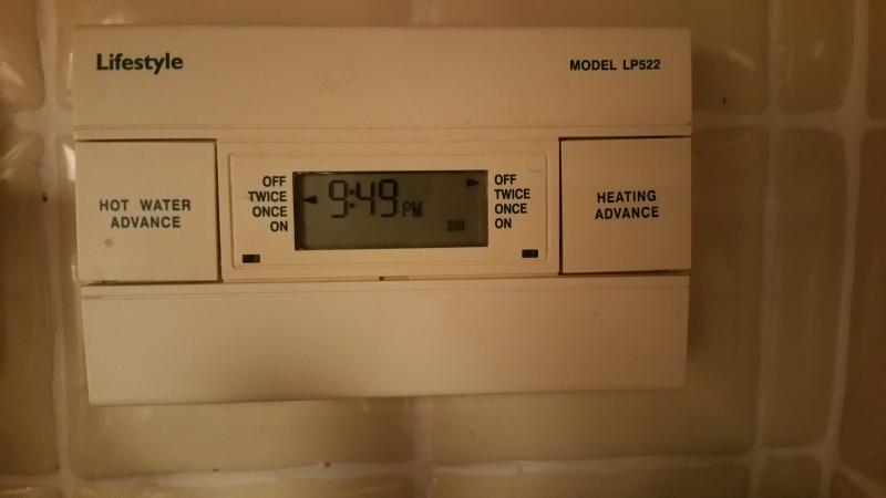

Further worrying development...Now even when my programmer is set for the heating to be constantly off and I have the old Satchwell TLX2259 re fitted, when it starts calling for heat, the boiler now fires up the heating even though it should not as I have effectively turned it off using the programmer ...Have I damaged the programmer or the boiler as well?
