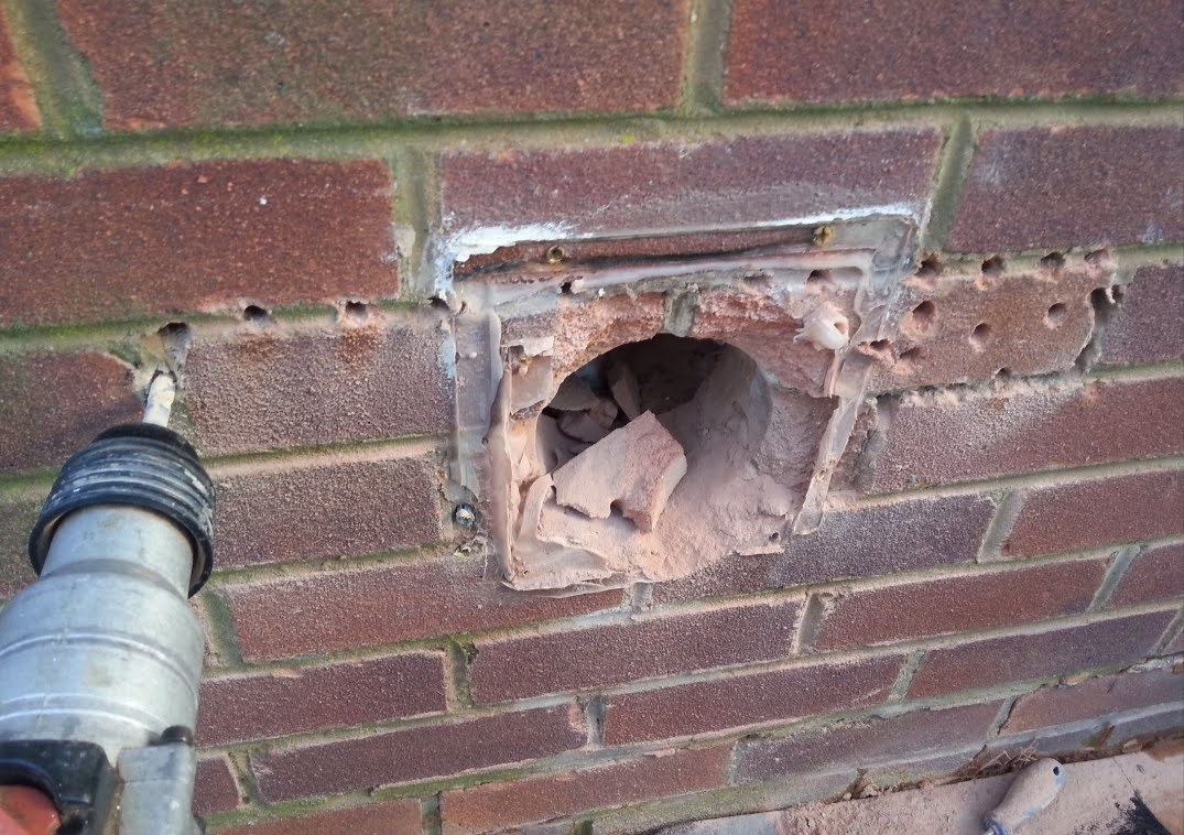

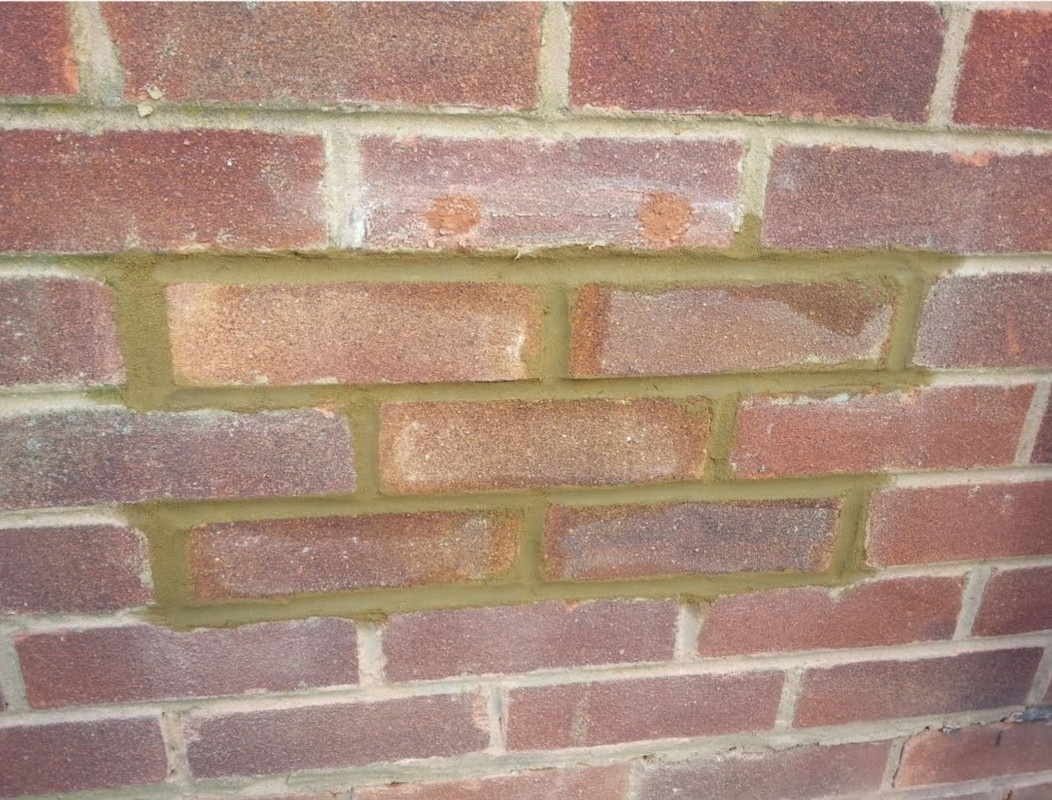

Duck tape to cover surrounding bricks and replacement brick. Really keeps bricks clean.
Never had a problem and easy job. This took 2 hours but I don't have a picture with duck tape over bricks. Wedged bricks to pack in correct position.
I drilled around bricks to loosen.
Pull duck tape when its all set.
