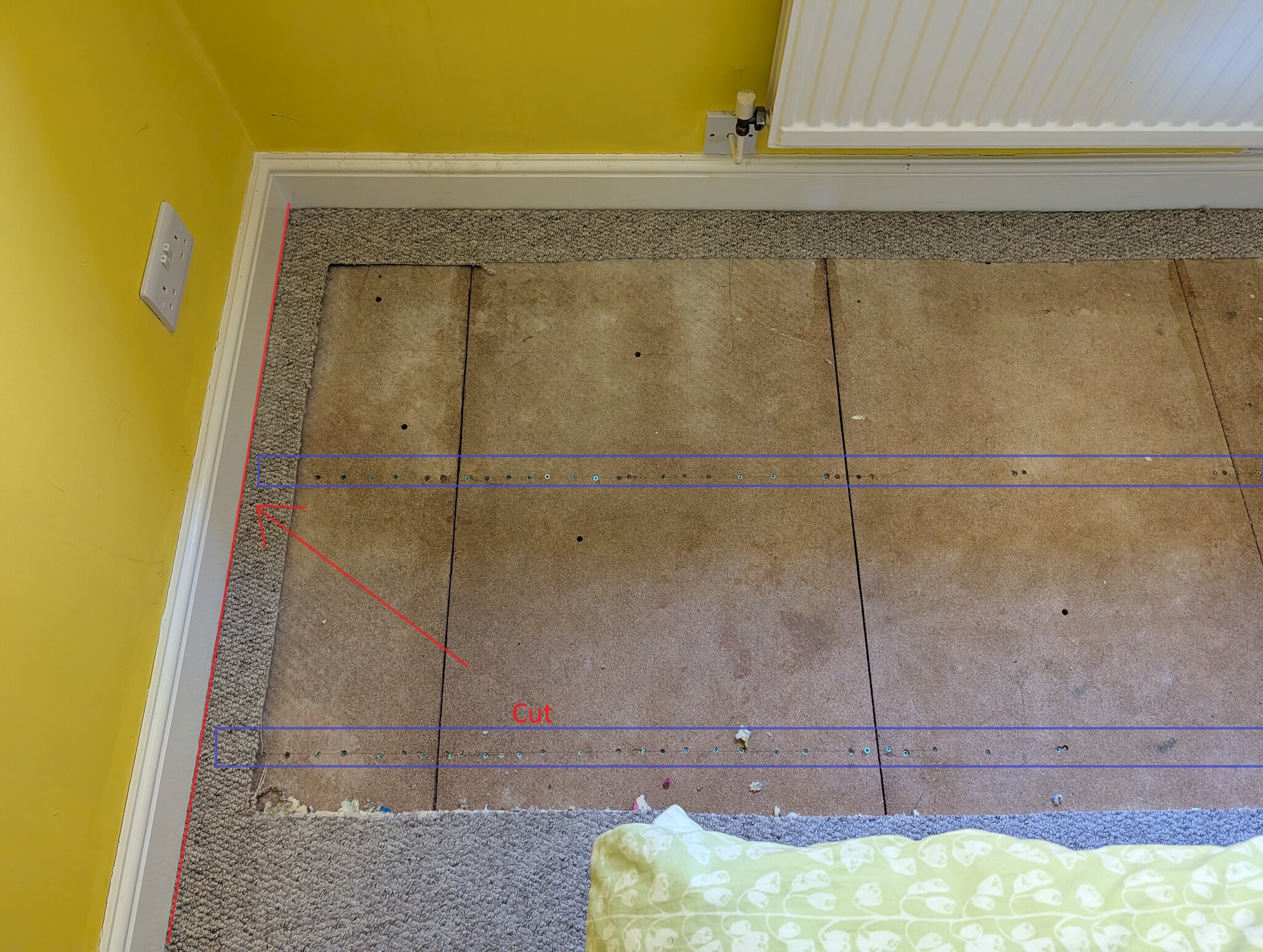

Hi all,
I’m hoping to get some advice on an issue I’m trying to resolve on the first floor of my house.
The house has been plagued by squeaky floorboards, and as I’m currently renovating one of the rooms, I’d like to address the problem while I have the floor up.
It appears that the existing floor is 18mm chipboard T&G. As you can see in the photo, the stud wall on the left has been built directly on top of the flooring. I suspect this is making the problem worse, as movement/creaks in one room can be transmitted through the floor into the adjacent room.
My proposed solution is to run a plunge saw along the red line shown in the photo, effectively separating the flooring in this room from the flooring in the adjoining rooms. I would then replace the existing chipboard with 18mm plywood.
Does this sound like a sensible approach? Has anyone done something similar, particularly where a stud wall has been built on top of the flooring?
I’m aware that I’d need to provide support underneath all the new board edges, so my plan would be to add noggins where necessary. I’m also considering using larger sheets of plywood rather than T&G boards, to minimise the number of joints and therefore potential points for movement.
Is there anything obvious I’m overlooking? In particular, I’d be interested to hear whether separating the floor in this way is likely to help with the squeaking, or whether there are better ways of tackling it.
Any advice or experience would be much appreciated!
I should have answered this before, but I did touch on it in my previous post. Stud walls on upper floors are invartiably built on top of the sub-floor (e.g. chipboard), but in a modern house they should run directly above a joist (or better a doubled-up joist). When a wall creaks it is often just down to incorrect installation of the sub-floor, rather than the wall, so the first thing I'd do is try to fix the floor (extra screws, glue injected into joints, etc).
Only then if you are still having issues will it be worth looking at the wall sole plate. If the wall runs across the joists it should be possible to take the skirting off on both sides and fix the wall down to the joists below using long screws skewed through the plasterboard and sole plate into the joist - just be careful not to hit any services beneath the floor. I'd also consider trying inject some PU glus into the joint between the sole plate and the floor at multiple points
If, however, your wall runs in the same direction as the joists you need to check if it has been properly supported with solid strutting. One way to do this is to drill a 25mm hole through the floor next to the wall at an angle to make an inspection "spy hole". If you have solid strutting (as opposed to, say, 3 x 2s) you can then try the same stitch to the top of the joist trick as before, only you'll be stitching to the solid strutting (on something like 300 to 400mm centres). BTW it may require a few holes to find the strutting, however.
Well, it will work, but floors and joists have a nasty tendency to have bits of ironmongery, etc embedded in them - the older the house, the bigger the issue. Best get yourself some cheap blades in case you miss taking a nail or screw out which will then find and wreck your blade. Also be prepared to deal with kickbacks - in other words don't kneel directly behind the saw, instead work to one side.
Frankly, though, I'd try fixing the issue in situ first if I could, and only resort to ripping the floor out if you can't fix it. The technique I've quoted for laying a chipboard floor is bulletproof, and is what based on what manufacturer's like Egger recommend. Properly installed T&G chip doesn't creak - the problem is some of the muppets who think they know how to install it...
Advice based on about 5 decades as a carpenter and joiner, so I have dealt with issues like this before far, far too many times for my liking.
Thank you very much for the extremely comprehensive reply, I will read it a few times and make sure I understand it all! All the potential fixes you have suggested I have unfortunately tries so I will be pulling up the floor.
So you would suggest that maybe I don't need to go for plywood T&G? It is quite expensive but at this point I don't care if it costs twice as much if it makes squeaks less likely.
Thanks again for the reply, I'll be using all this information as a guide throughout the process.
Cost is one reason for using chipboard, the fact that plywood has plain edges (which can move sgainst each other unless you take steps to stop it), and the complete PIA that is manhandling 8 x 4ft sheets if plywood is a third.
Surprised you'd tried all the stuff I mentioned - even glue injection? That's a useful fix for squeaky laminate or engineered flooring (and refilling holes with coloured hard wax filler)
Chipboard is awful stuff and I did the same.
18mm will fit straight in without a step, but, as well as putting all the joints on top of joists, add struts "noggjns" under all cut edges. Otherwise there will be a small amount of flex when you walk on them.
You can screw them down, which will be useful if you ever need access. This is a good time to add a floor safe, or a hatch to the void.
You can paint or varnish for improved cleanability and water resistance. I used hardwood faced ply, and dyed and varnished it before fitting (including the edges) in bathroom and kitchen.
On the ground floor, consider packing between tge joists with mineral wool to block draughts and reduce heat loss.
On other floors it will slightly reduce airborne noise transmission, but the heavyweight batts are more effective for noise muffling.
Thanks for the reply, so I don't need noggins on T & G joints? I was basically going to add noggins all around each board so no edge, even if its joined via T&G would be left unsupported. Have I gone abit over the top with that?
I've had floors relying on the T&G, and I say, add a strut and screw both pieces down.
They fail first in high traffic areas, like in front of the sink, at doorways, and at the bottom of the stairs where people step (or jump) off.
(I am no professional, just a householder enraged by shoddy floors)

When I did my 2x bedrooms, ensuite and landing, I noggined all board ends at the correct level plus, infilled any low joists with timber slithers. The whole lot is as solid as a rock, no squeaks and level. We've porcelain-tiled the ensuite floor. Quite a ball-ache at the time but, 14 years later, all still sound.
I have nothing to add to @GhostIntMachine 's sage advice but I would say that I have never seen microbore rad pipes run through a blanking plate with a flex hole. Is that normal?
I replaced all the boards with 22mm chipboard and there is basically no improvement... I didn't bother gluing down as I could tell the floorboards are not the issue, the joists are the things that are creaking. Standing on the joists directly with no boards still creaked. Could I try sistering the joists perhaps?
