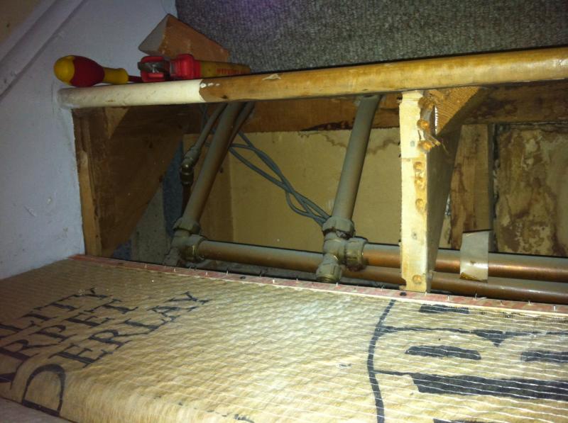

Hi guys, I was looking to replace the treads and risers for my parents.
I have never even thought about doing this kind of thing before, so please be gentle! :D
I was expecting to remove the treads/risers, to find stringers, then cut new treads/risers out of a sheet material then fix them down tight, but this is not the case.
The treads appear to be slotted into the side skirting, and supported by blocks underneath at each side. Then there is piece of timber in the middle for the riser to attach to.
Could anyone give any advice on how I should go about replacing them?
Many thanks,
Adam.
Unless you can get access from the back(and it looks like a no no)you have a real job on your hands. The treads are fitted from the back into blind slots in the stiles.
Personally I'd forget it. As wingcoax said, the treads will be pushed into blind slots cut in the strings from the back The slots are usually tapered, being deeper at the rear than the front. They then secure the treads by driving in glued wedges to really tighten them. You will wreck the staircase if you attempt this.
Why do this anyway? If the treads are in poor condition (eg cracked) could you glue something over each of them, such as thin plywood?

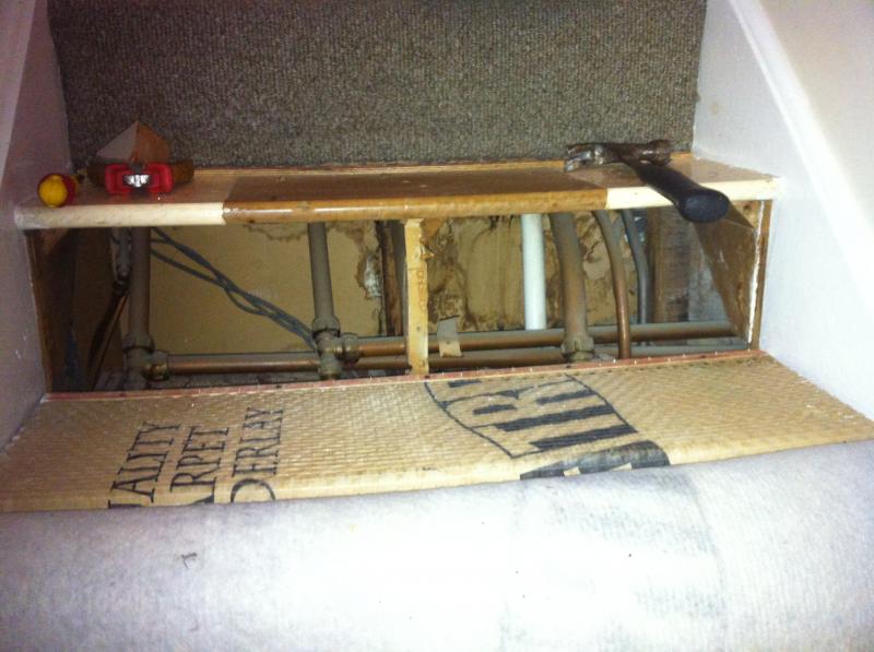

Hi guys, thanks for explaining how the staircase is constructed.
Would it still be a massive task if I had access from behind? As the pantry is underneath the stairs. Obviously I would have to pull the sloped plasterboard ceiling down and replace it afterwards. (not that great anyway).
The reason I would like to replace these is because almost all of them squeak really bad! They will be carpeted back over afterwards though.
Any alternatives?
Thanks again,
Adam.
nothing is impossible,but as already said it will be a knightmare to do.
the folding wedges are glued in as is the tread/risers.
work out how much time it will take you aswell as the cost of materials,then price up for a new staircase.
take into account redecorating etc.
If you completely uncover the back of the stairs, you might see small triangular blocks of wood glued in the internal angles between the treads and risers (they will be original and are called glue blocks)
If so, these are intended to help stop stairs from squeaking. Sometimes they work loose (or are non-existent). If they are there and some are loose, try taking them off and re-gluing and screwing up tight; use the white PVA glue.
If there are none, consider gluing and screwing some new timber in. Thiis could well stop the squeak and will be a whole lot easier than trying to replace the treads.
