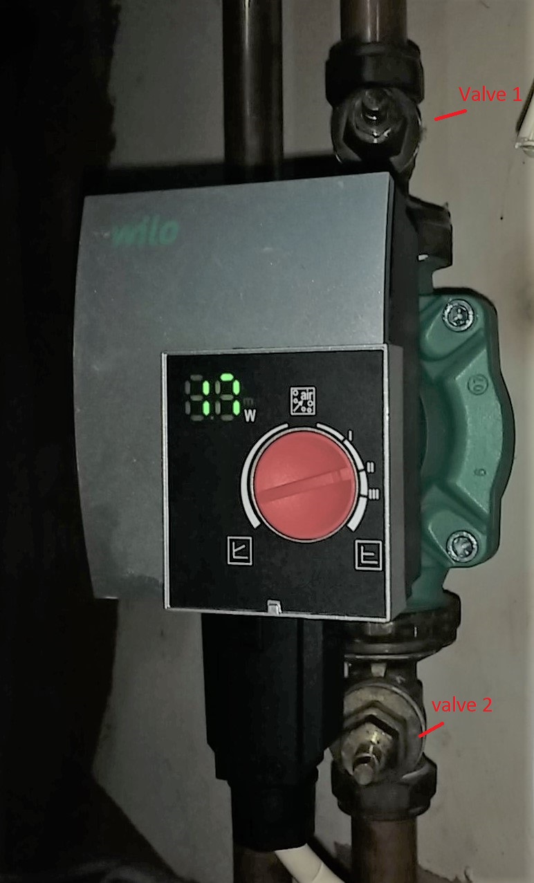

Hello everyone,
My Wilo pump - same as Steve's mentioned above - has been running for a few years with its head fitted upside down. Clearly a plumber in rush did not read instructions and I wish to correct this error.
Would there be any leaks or adverse effects if I were to remove the four Allen key bolts and rotate the head? Given that water has flown through it, do I need to close the two upstream & downstream gate valves before making this change??

you really should start your own post it is against site rules to H-jack old posts, yes you have to isolate the pump before touching the bolts, post a pic of your isolating valves some you really should not touch

I managed to rotate the control head by :
(1) first closing the two valves shown in the image below (takes many rotations cw till lock with an adjustable spanner),
(2) unplugging the electric plug (by pressing a small latch on the blind side while slowly pulling off the plug)
(3) undo the four Alan key bolts (only two visible in the image below) while keeping a thick towel bundle wrapped around the lower pipes to trap water. There was a bit of suction to overcome in taking apart the unit to rotate.
(4) rotate the control unit & fit the Alan key bolts. That's it!
