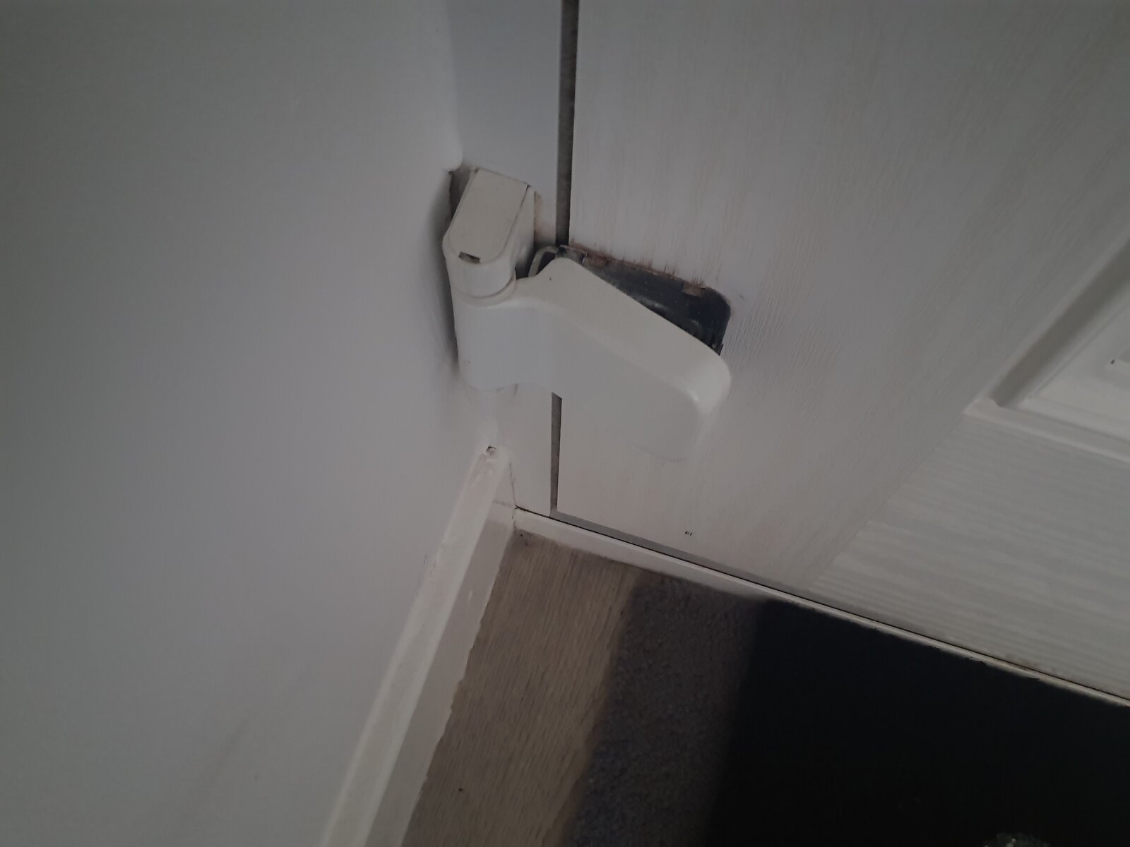

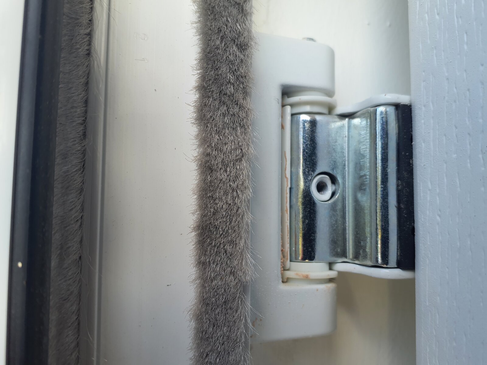

Hi all,
I've lost the security screws that hold the upvc door hinge flaps closed.
I've contacted Mila directly but they don't sell them without buying the whole hinge but they have given me the following information:
026812 - Pan Head S/S 3/16^-24 PH2 Security Screw
Can anybody link to some compatible Screws.
Thanks.
Your not going to get them anywhere, we use baypole screws and cut them down to 10mm, they easily bite into the soft aluminium, i guess yours are staying open when you close the door?
Thanks for replying, yes the hinge covers are staying open when I close the door. I might have to get some baypole screws then in that case.
