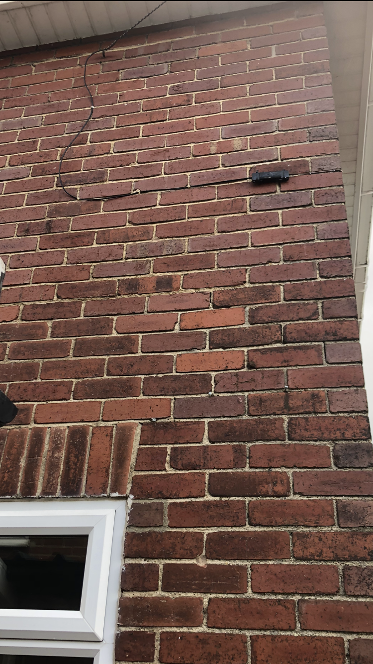

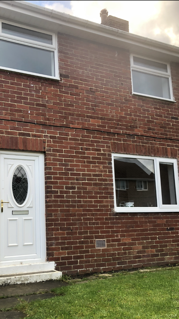

Hi good evening all im wondering if anybody could advise if this pointing will hold up this winter just purchased the house and pointing seems very Sandy I’m worried incase the rain absorbs through to the inside above windows as they are just soldier course so guessing no trays etc in above. House is cavity wall with white fibre type insulation thanks

It will hold up for the next 50 winters in structural terms.
However it its sandy, it will let more water. Whilst it may be a cavity so any moisture may not reach the internal room, moisture lowers the performance of the wall insulation and increases the risk of bricks shaling from frost (although from the photo they seem fine and may not be susceptible)
But that wall has been like that for years, so there is no reason to suspect there will be sudden problems if none exist now. Put it on the medium/long term to-do list.

I disagree with the above, the mortar is lime and has reached it's end of life it is sandy and brushes out easily.
If you didn't have cavity wall insulation (CWI) you could delay a little longer but utlimately it needs doing and you want to avoid the CWI getting wet at all costs as this will lead to internal damp and the CWI will need extracting once wet.
As an example: Over 90% of the damp issues we see are as a result of CWI issues so I would prioritise wall maintenance as prevention is a lot cheaper than cure.
That said, if you are repointing in lime mortar which I would advise, it is best carried out during spring to autumn and at the time of writing, we are coming out of winter so I would recommend getting it done this summer rather than creating a larger problem by delaying the work.

The house looks like a 1950's build - if so, typically, it would not have had built-in CWI.
The CWI you describe would have had to be blown in but I dont see any of the usually obvious "blow holes" in your pics? Although your pics wont enlarge?
The pointing definitely looks very sandy, and not like cement pointing.
Whenever it is that you re-point then make sure there's a rake out of 25mm.

I can blow up the photos on mine Tell, can just about see one on the second photo, 3 joints up and one in from the frame.
Willy 87,
Although some builders were still using lime mortar in the 50's, most were using a sand/lime/OPC mix.
When mortar is first rubbed up with a metal tool the cement/lime laitance comes to the surface and forms a weathertight skin. As it weathers back over the years the sand shows through, so the colour changes and it looks a bit more sandy.
