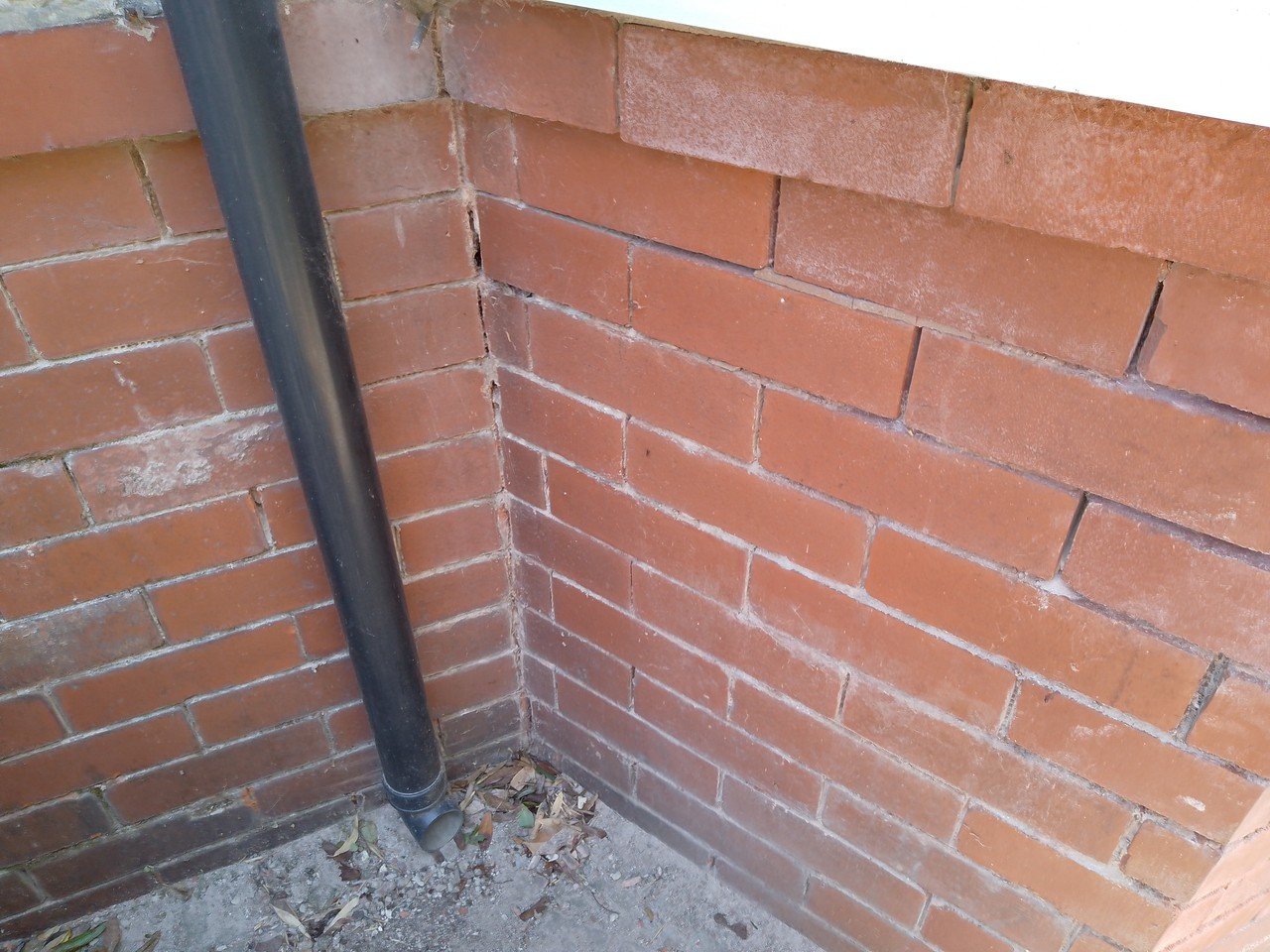

Repointing window bay
13 Sep 2012
27
4
London
I'm repointing my bay window - 1920s semi. The bay bricks aren't bonded in to the main wall - same for all the houses in the road. Question: Is there a good way to point the joint where the two walls meet? The shape of the bricks means that the joint 'opens up' on the inside, so it's not like a regular joint with parallel sides. If you push mortar in to it, it just falls in to the cavity. Thanks for any advice...
Lime Mortar.
Watch skillbuilder on YouTube talk about lime mortar pointing
