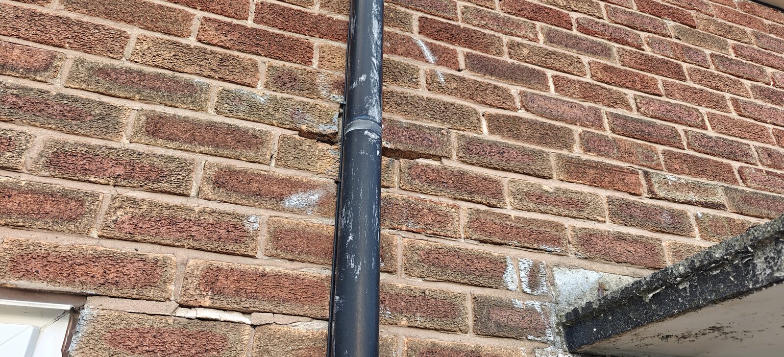

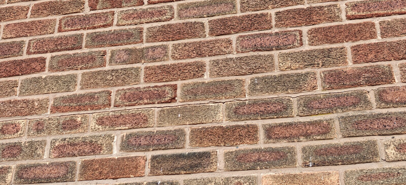

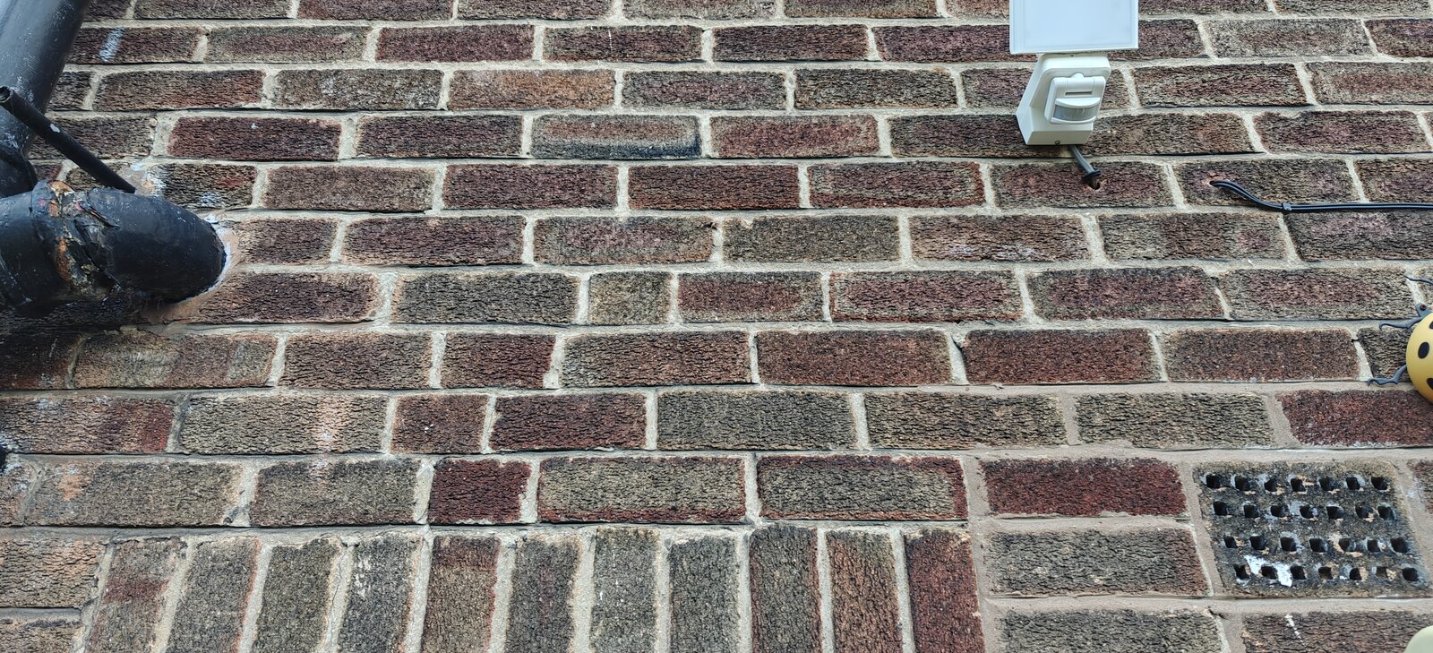

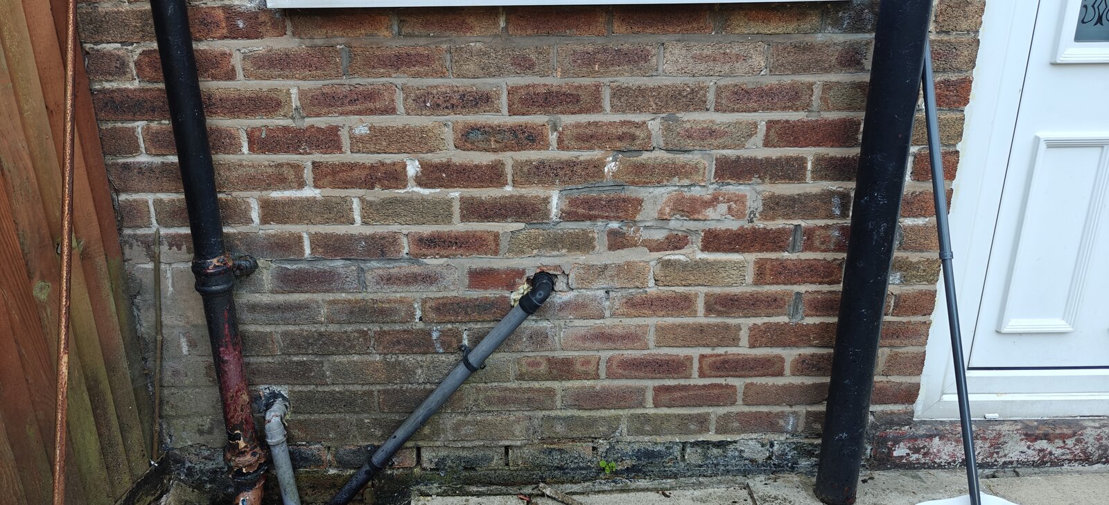

Hi
I bought the house I've been renting for years towards the end of last year. The entire house needs a repoint but I'm keen on doing it myself in sections.
I believe I would just need a 4:1 mix, do I need to add anything else?
Below the dpc are a few joints that have gone completely through to the cavity and I think the dpc may need pointing too. I've read that it's important to leave the pointing back a bit to avoid bridging the dpc. At some point the house has had the cream injected, do I need to worry about the state of the dpc if this has been done?
Would the best approach be to use one of those mortar rakes in a grinder, grind out several courses, repoint and move onto the next section?
I've googled to death but you end up with mixed bits of info so thought I'd post up here.

OP,
Well done for buying the house.
Use a 115mm angle grinder with a masonry wheel to cut through the beds & perps - & then use a mortar rake to clean them out to a 25mm depth.
Use a 3:1 or 4:1 sand and NH lime mix for mortar.
Below the DPC some use a sand & cement mix.
Ignore the cream injections.
Practice in an inconspicuous part of your property.
Use a tower to work at FF height and above. Dont work high unless someone else is present.
Posting Pics showing a much wider context from ground level up would help?

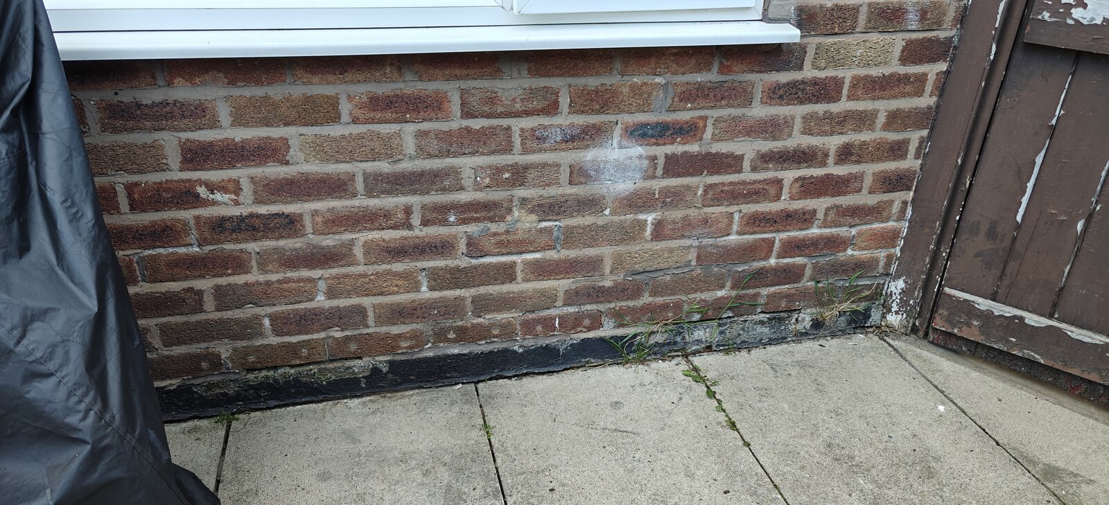

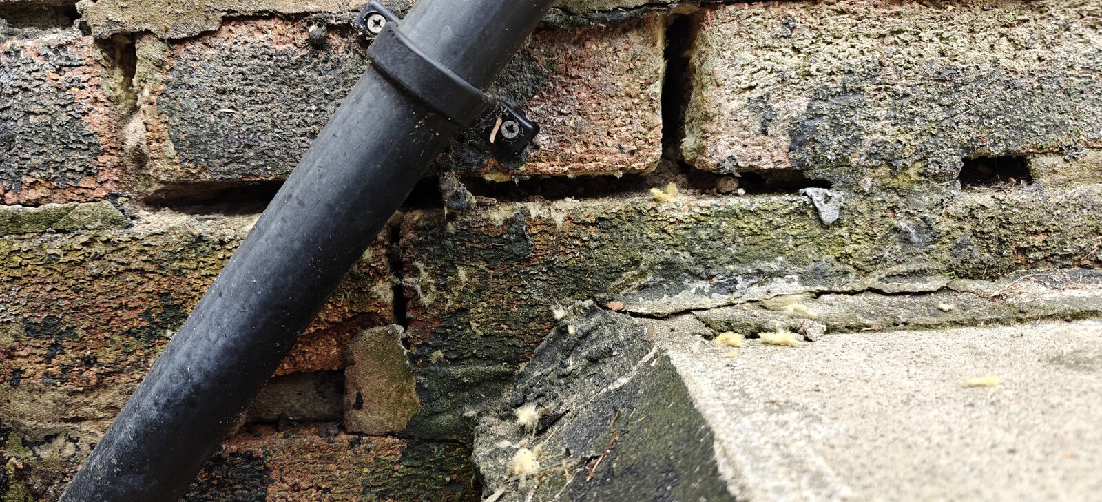

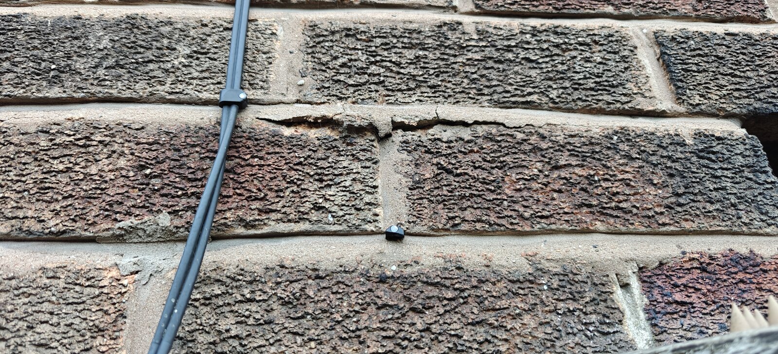

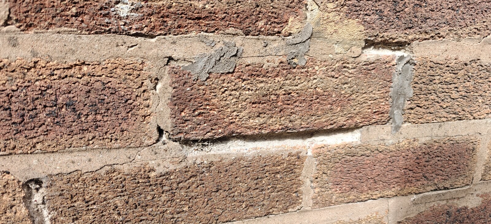

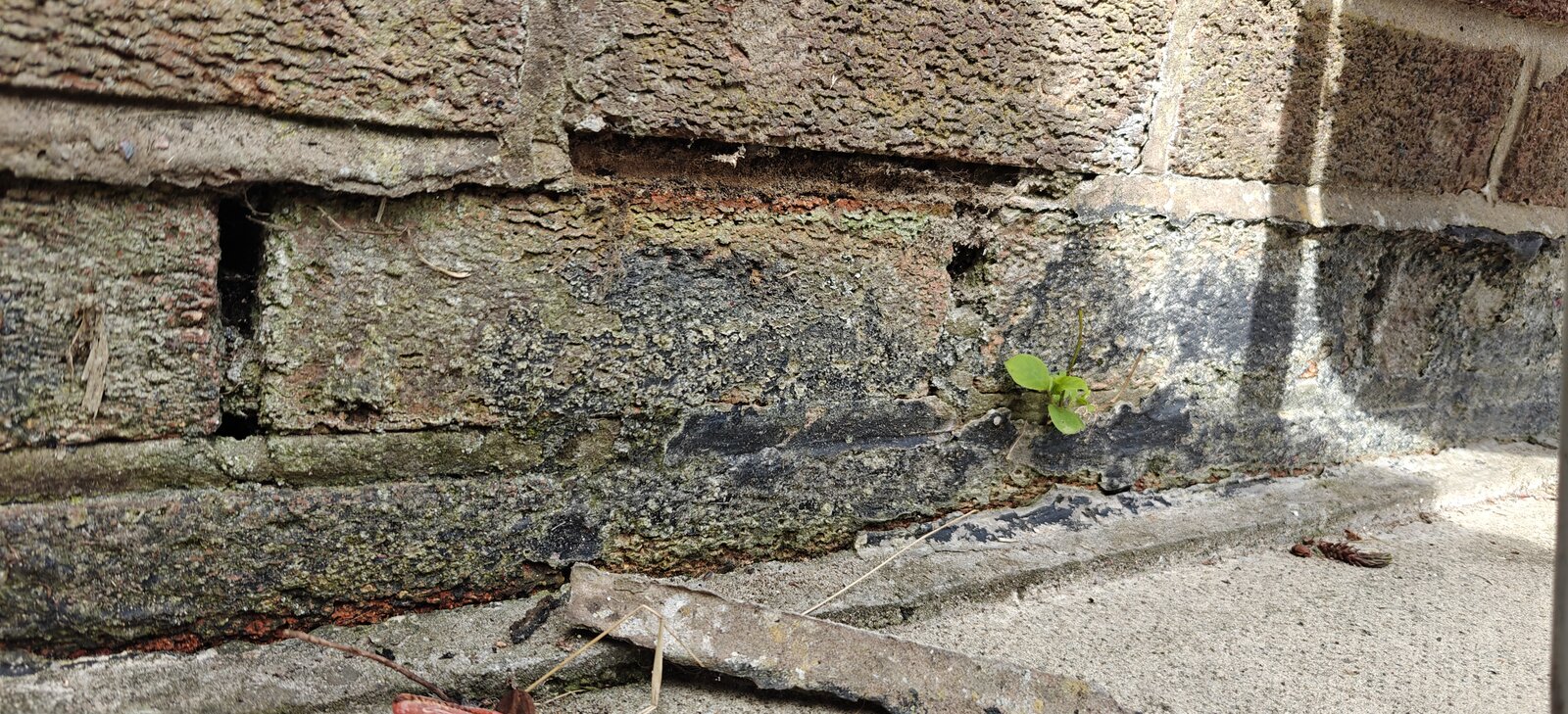

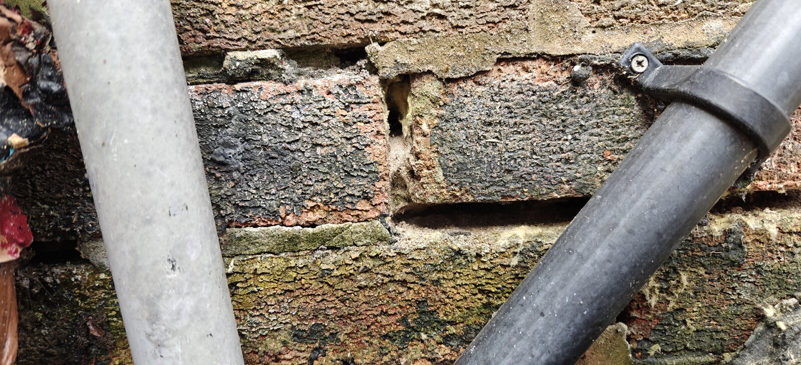

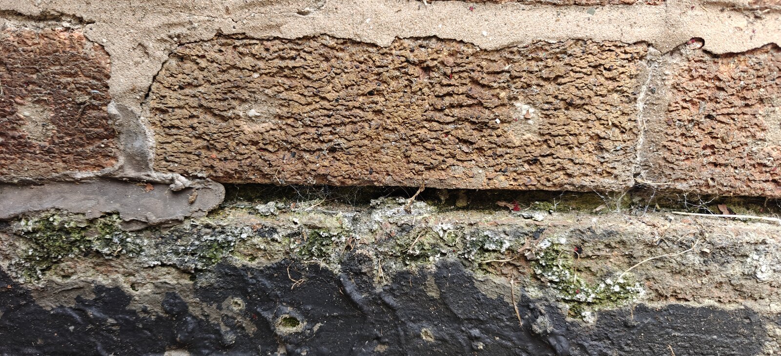

Here are a few more pics of various cracks or joints which are falling apart

OP,
Some parts of the obviously failing pointing seem to have been previously re-pointed twice.
Even where the pointing appears to be in good condition I would still rake it out & re-point.
"some use" cement in the mix - its given as a choice for you to make.
The last pic shows a horizontal crack this can sometimes be an indication of rusting & swelling metal wall ties
or it could be something else but the pic shows only a limited context.
All mortar is porous, no matter if its cement or lime based.
The point of pointing/jointing is to form a weathering face to cast water off the brick arris - and not keep the brick dry. Or prevent gaps between the brick and the joint which could be instrumental to frost action or spalling.
The dissimilar properties of lime and cement can create a high risk of either lime bloom or efflorescence, particularly where there are cracks in the bulk of the cement mortar causing localised excess water and this is pointed with lime mortar.
I also see that poster #5 mentions adding cement to the mix [of his previously recommended lime mortar], but then it is no longer a lime mortar! It's not the same as adding lime to a cement mortar, which is different lime added for a different reason - for workability or to lighten the shade.

With regards to the wall ties I'm a bit worried now, done a bit of research and found a decent video showing how to identify if they are at fault and seems it's not too bad of a job to insert new ties if need be. Fingers crossed it's just ****ty pointing falling out but that cracking is worrying from what I've read now.
Things have moved on a bit since my last post, I've confirmed lime mortar was used and it's been repointed with cement at some point along with every other house in the street. After a bit of reading up on wall ties I hired a metal detector and found several, ground out the joint and found a badly rusted knackered wall tie.
Checked a few more as per the guidance I found online and they were also rusted quite badly so looks like I do indeed need the ties doing.
Ordered a kit containing helical ties, spent a few hours working out the correct placement, I needed 100 ties to do the front of the house and have 14 left to go but my drill bit snapped.
During all of this I spotted a blown joint to the side of a window opening and the lintel is all rusted too! Now I need to replace that before I even get to repointing!
