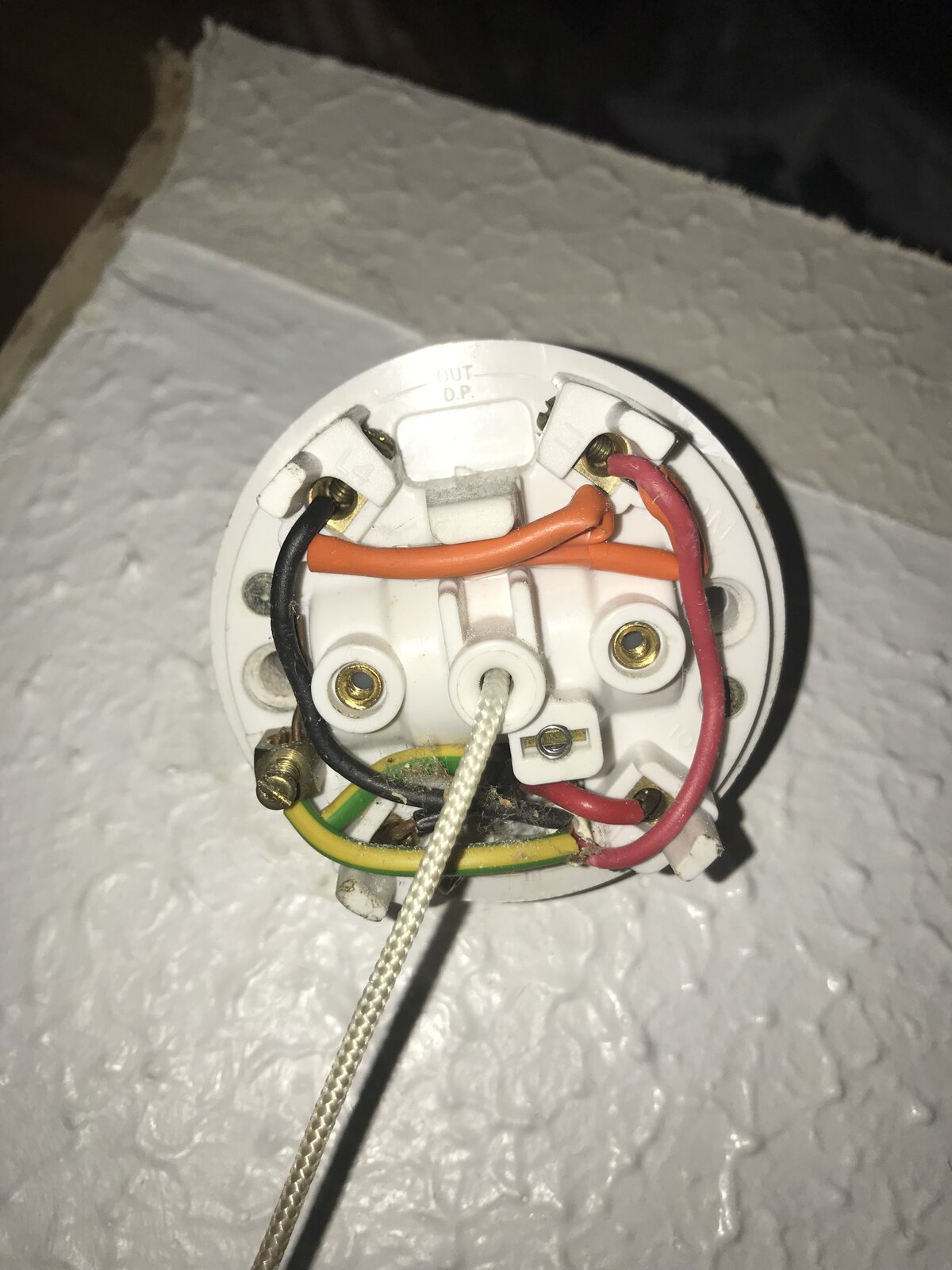

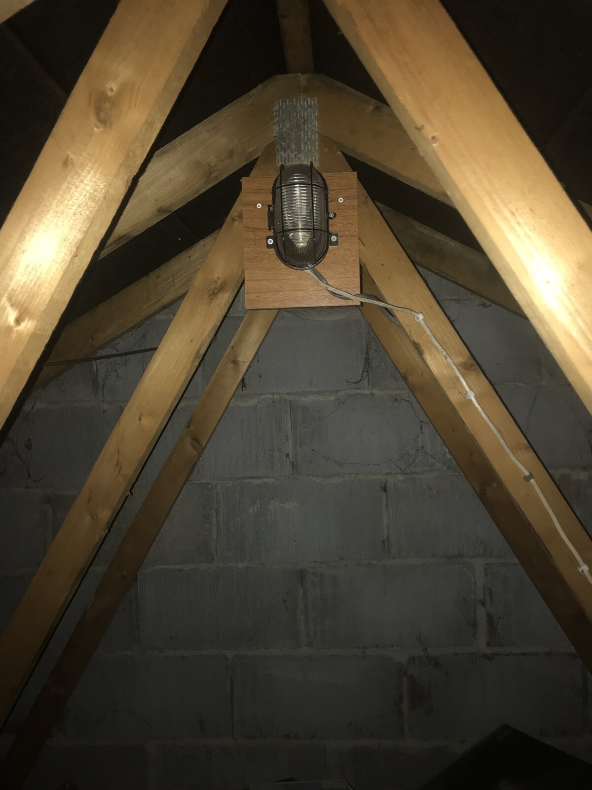

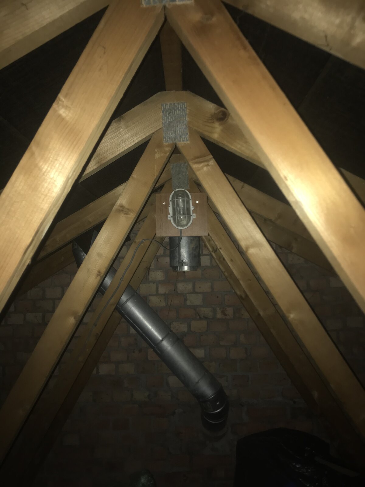

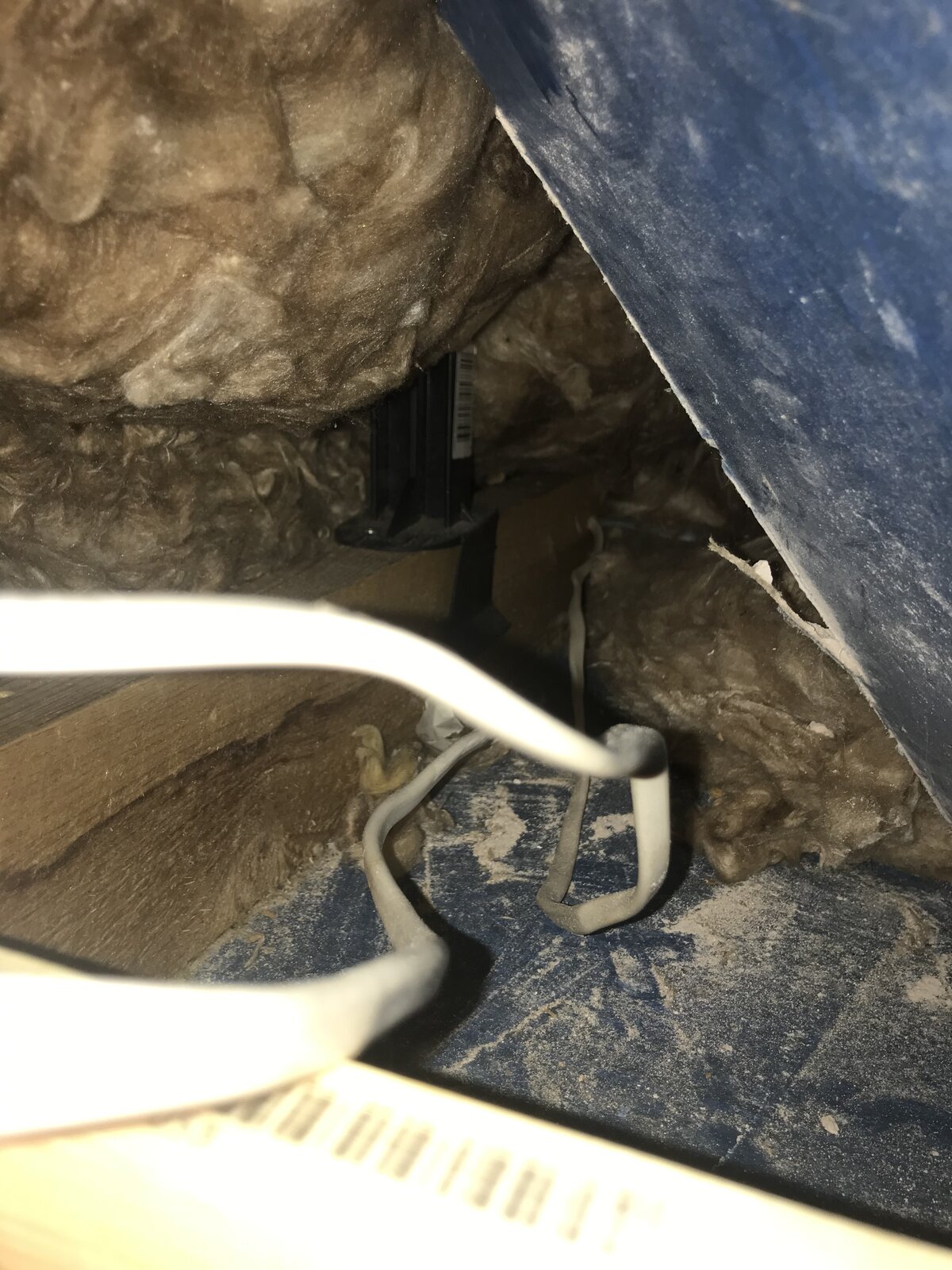

I’ve attached images to show connectors for the pull cord switch, the lights in loft and the cables going from the switch. The cable on left goes back to the “last ceiling rose” and the one on the right goes up to the first light. The lights are connected by twin core and earth. Not sure if that helps?

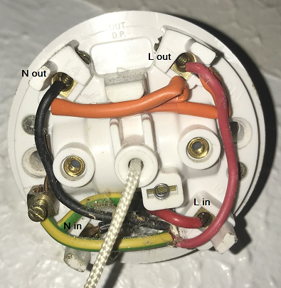

Your present switch is a double-pole one which also switches the Neutral.
Assuming it is connected correctly these are the terminals.
If your new switch is only a single-pole then just use the L terminals and connect the Neutrals together.
Thank you. Can’t recall why I bought a double pole switch all those years ago??

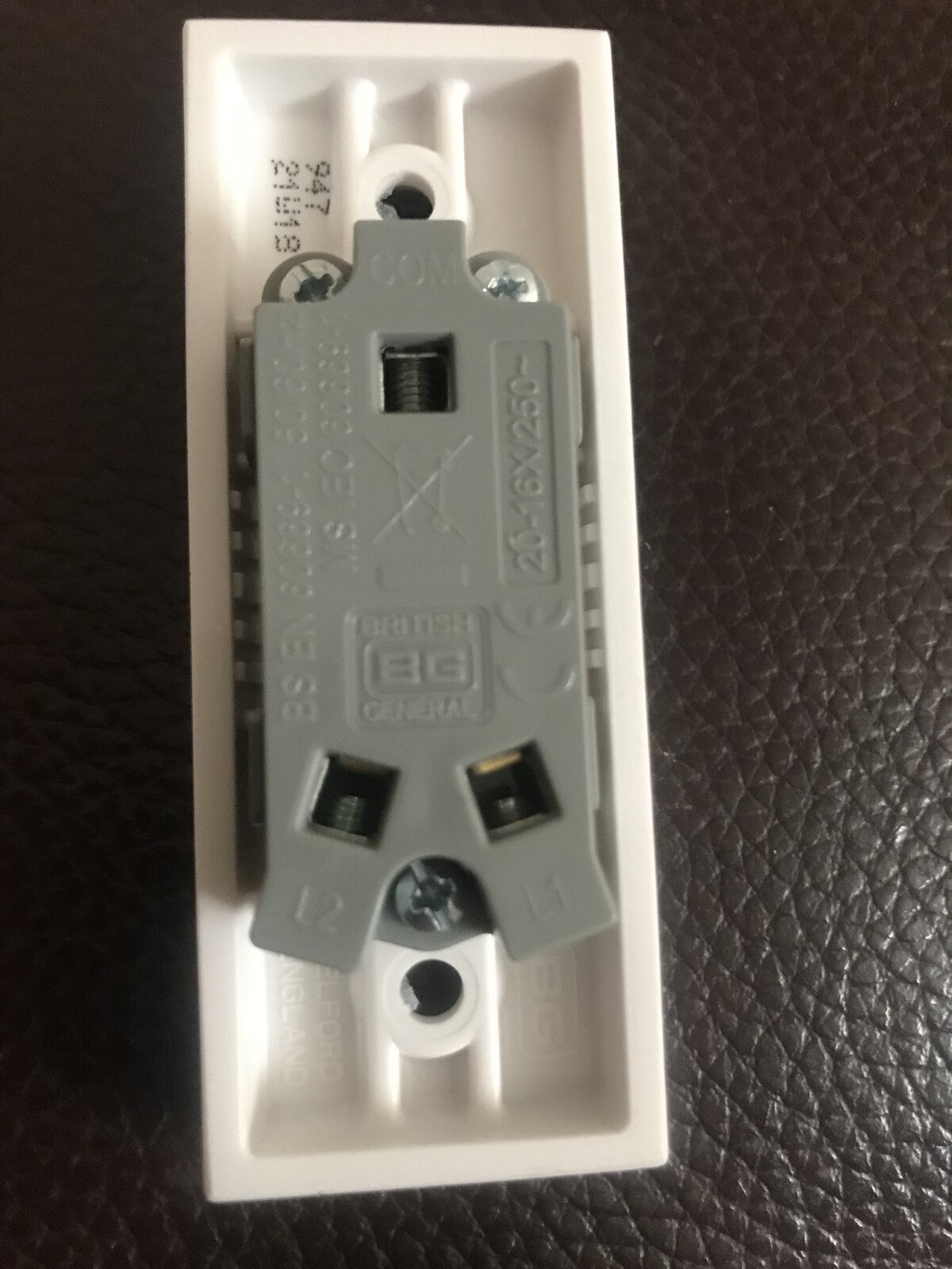

Variation on a theme now. Previously had double pole one way, now have single pole two way. (Don’t need neon, as light will be in loft) I wanted a thin switch, and these all seem to be two way?
I’m assuming I just need to put the two live wires into the com and both neutrals into L1 for the switch to work? (Earths in backing box)
No - you will need to join the neutrals up in a separate connector from the switch , live in com and live in L1 or L2
otherwise you will short out the live to neutral and blow the fuse/mcb/ecd
the double pole - keeps the live and neutral separate and switches both , and so theres is a connection terminal for all the cables you have
the New switch does NOT have connections for the Neutral
if a small box, not sure if a connector will fit and then what the rules are for connecting up outside - maybe a 20A 4 terminal junction box , if its available for maintenance

Thanks. Not going to need the separate neutral connection now, but for future ref: When you said above “need to join up neutrals, separate connection from switch etc”…Did you mean separate connector as still going from switch, but separate? (Conversely, separate from switch entirely?)
You also repeated “live in” to com, L1?
Sorry to be so obtuse
Sorry Live switch OUT
The neutrals are currently in the double pole switch and when the switch is made - they connect
Now you no longer have that option
BUT the 2 wires neutral - have to be connected together - so the lamp has a neutral
nolonger will be connected in your new switch
so they need a connector of some kind, as i say not sure of the regs - so may need to wait for an expert to reply - which hopefully they will
I would add a choc-block and connect the 2 neutrals together and leave in the switch back box - BUT they may not fit as its a small box, and so need connecting outside the box, which is here you may need a 20A 4 connecrtor box to do that and keep all the T&E sleeveing inside a container
