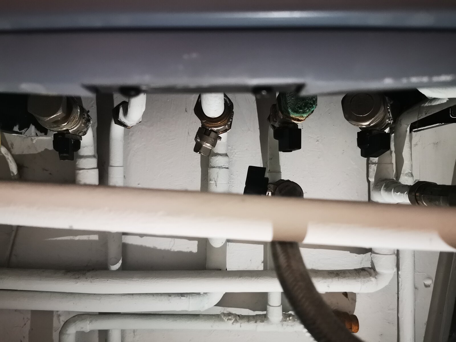

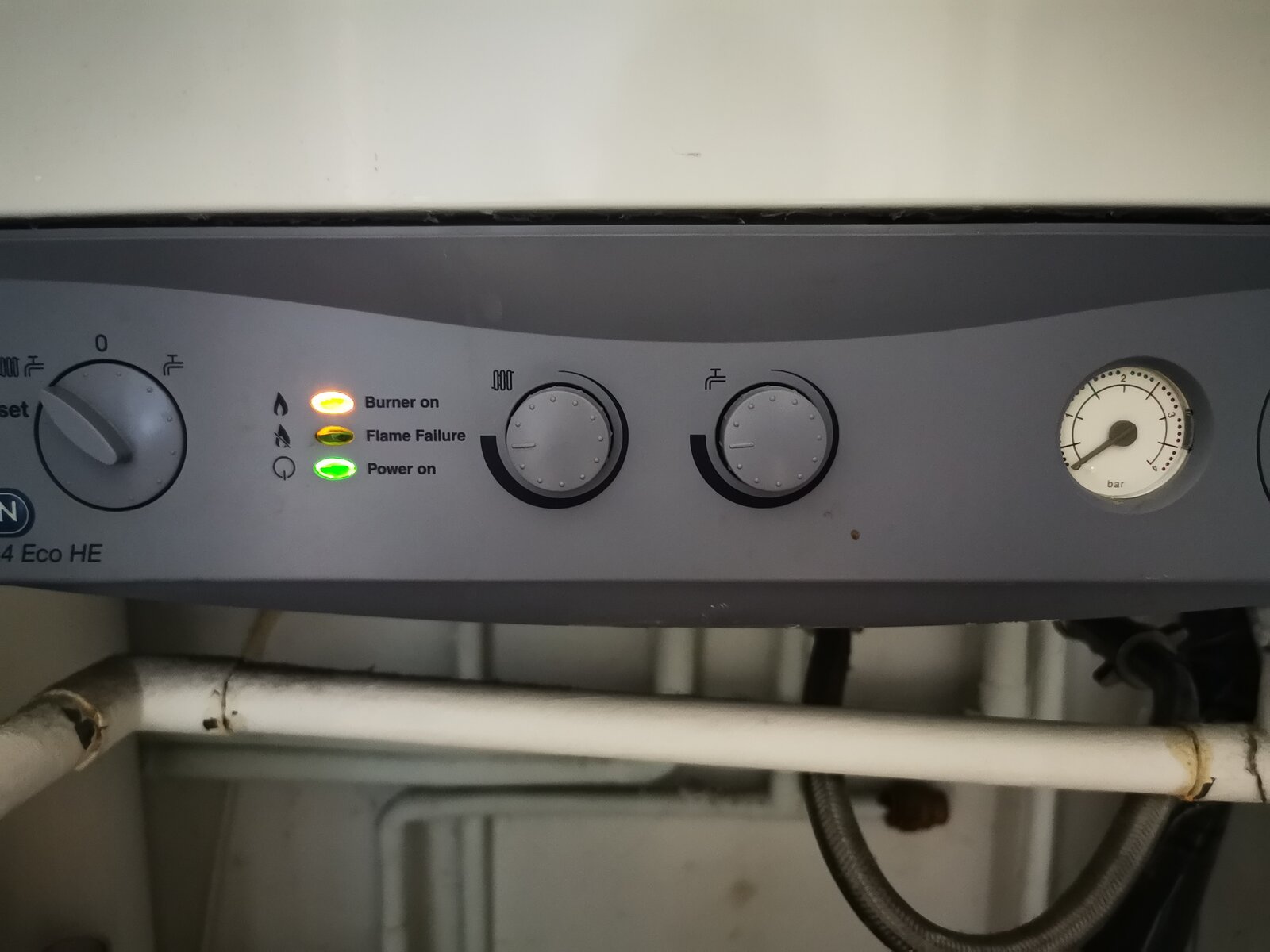

So I've just bled my radiators but now have no pressure in my boiler. How do I repressurise it? Its a potterton performa 24 Eco HE

Silver coloured ,flexible,braided hose below boiler is the filling loop. At the end of it there is a small black plastic lever ,operate the lever to open the valve. Can't see if there is another one at the other end of the flexi ,is there one??
The silver braided pipe coming towards the camera, should have a black handle on both ends, turn one to be inline, then turn the other till the pressure rises to 1.3bar. If there's only one, turn it inline until the pressure rises. once at the right pressure turn one or both at 90deg to the pipe/valve
No just one black valve on the silver pipe and then three black valves higher up closer to the boiler itself
When I turn the silver pipe valve it sounds like water is filling it up but the pressure gauge doesn't move? I turned it off after a couple of seconds as was unsure whether I could be damaging it. Does it take a while for the pressure to increase?
Unless you’ve closed any other valves off under the boiler, it should be relatively quick, unless your mains water is poor pressure?

How would I know if the others are closed? Should they be turned towards me or should they be turned to the side? Sorry I'm a complete novice at anything like this
Did the gauge work before, was the needle up around between 1-2 before you bled the radiators??
Did you turn any of the other valves before you bled the radiators and was the CH working ok, if so then just leave them alone.
Yes it worked before and the CH was fine, just needed to bleed radiators as tops were cold and bottoms were hot.
When I turn it for more then a few seconds it starts to make a very loud rattling sound and the pipe starts shaking
Are you turning the lever fully,until it comes to a stop ? If so ,try turning it partially back ( To less than fully open) that will reduce the flow ,will take a bit longer to increase the pressure ,but may reduce the shaking.
Ok will try this. Should all the other valves be open? Or should some be closed?
Have you altered any other valves positions ? If you have not ,you don't need to worry about them ,they will all be open.
No I don't think they have. They are aligned with the pipes so that means they are all open right? I know you said it will take longer with only turning the valve a little but roughly how long should it take?
