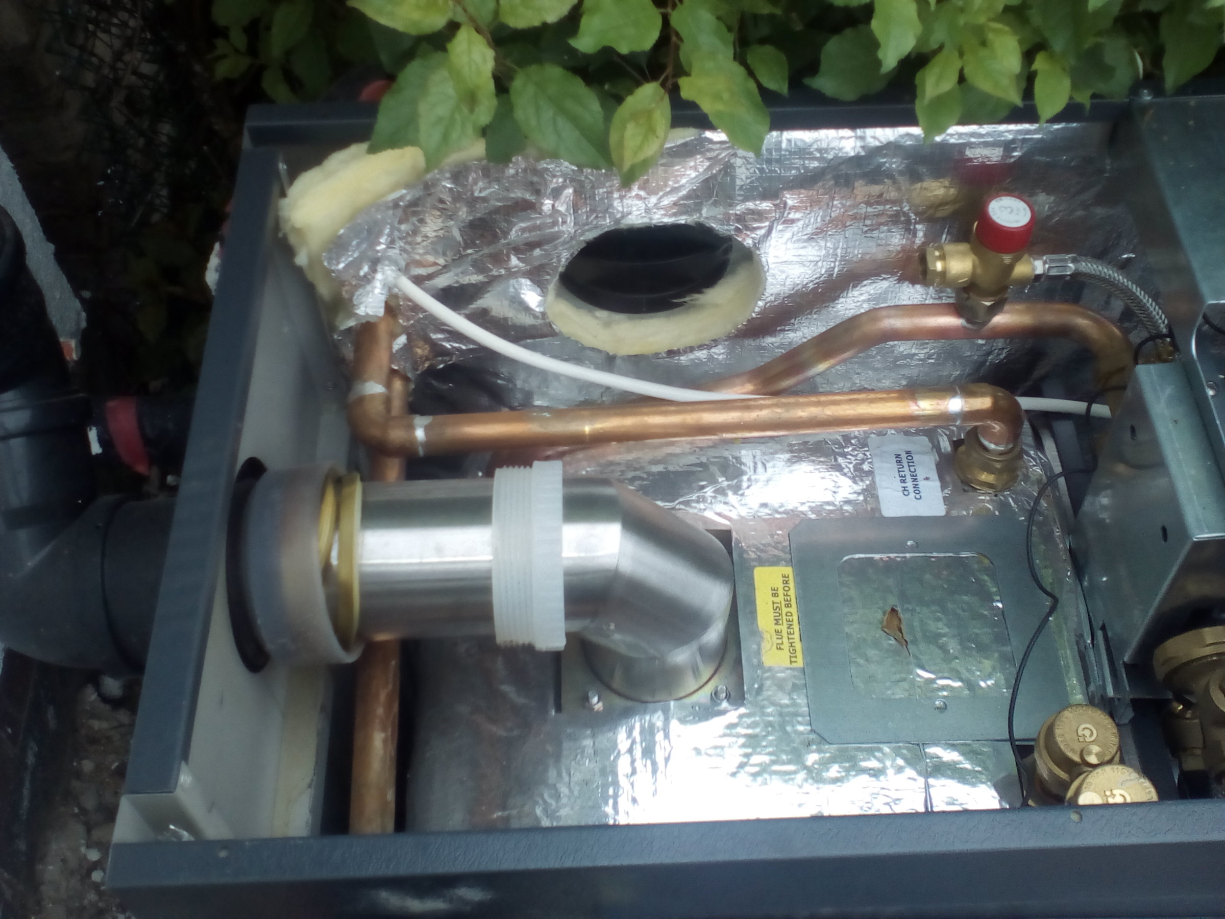

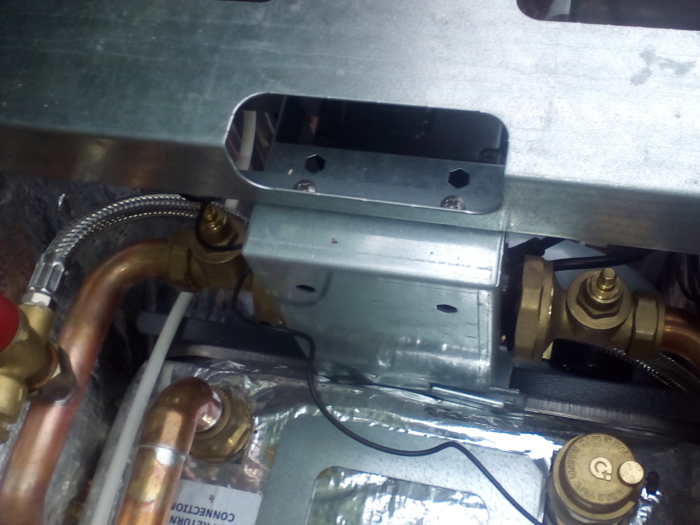

Took some pics. First one shows where the cold water comes in (Top left). Second one shows two valves - are these the ones? One flexible hose runs to the expansion vessel, but no taps on it. There is another flexible hose visible just to the left of the second pic.

The flexible hose on the first picture looks promising, look at the other end of the flexible hose. Also the outlet from the pressure relief valve needs a pipe to divert any discharge from the boiler case.
Kon the ex vessel there are two flexisthe thicker one leads to a fitting with a tap turn it upwards till the pressure is at 1 1/2 bar that should do it but if you get the pressure up and it don't start then the thin flexible pipe is blocked with crap at the prv end a common fault if system not flushed before installation.bob
take the front cover off. the filling loop is there above the burner to the right.

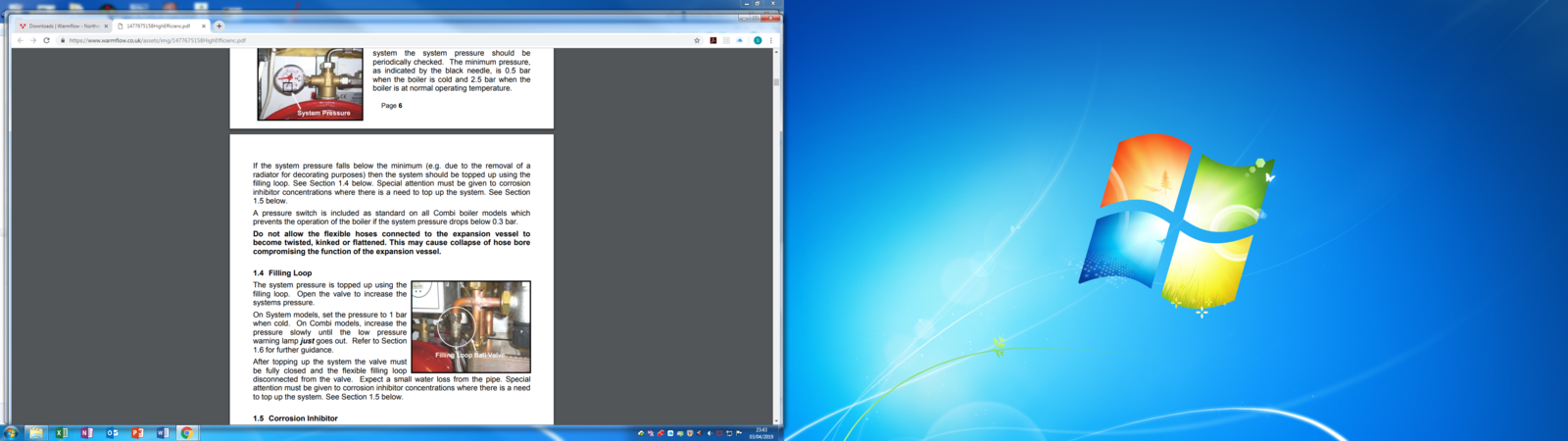

Read your manual and on page 6/7 it shows you colour pictures of what you are looking for.
